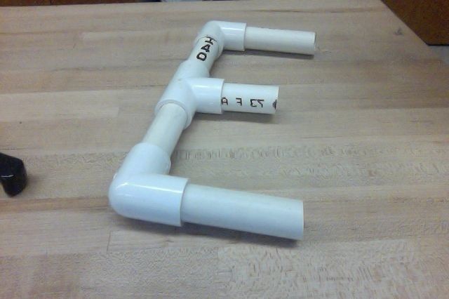

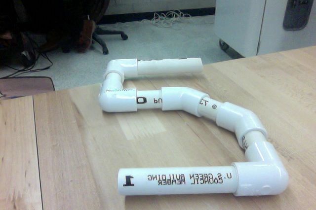

Step 7: Clamp
Take the two 90degree pvc connectors.
Take one of them and designate that as the top. Take that connector and drill a 5/32 inch hole in the bottom where it will connect to the wood.
In the top of that connector drill a hole large enough that a screwdriver will be able to screw a nail in the bottom hole.
Step 8: Clamp Continued
Take the base of the wood and drill a 5//32inch hole in line with the other 5/32 inch hole. This is where you will put the screw.
Take the 1''-2'' pvc pipe and put it in the top pvc connector.
Put the other connector in the bottom of the pvc so it will make a U-shape
