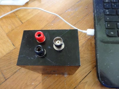

- a high voltage power supply for the PMT [you can take a Commercial product or build your own based on a CCFL-module like I did]

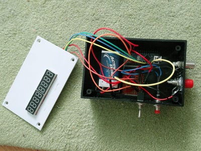

- detection-electronics including an amplifier and a comparator [also selfmade]
- a counter [http://www.ebay.com/itm/6-Digit-Red-LED-Counter-Pa...]
