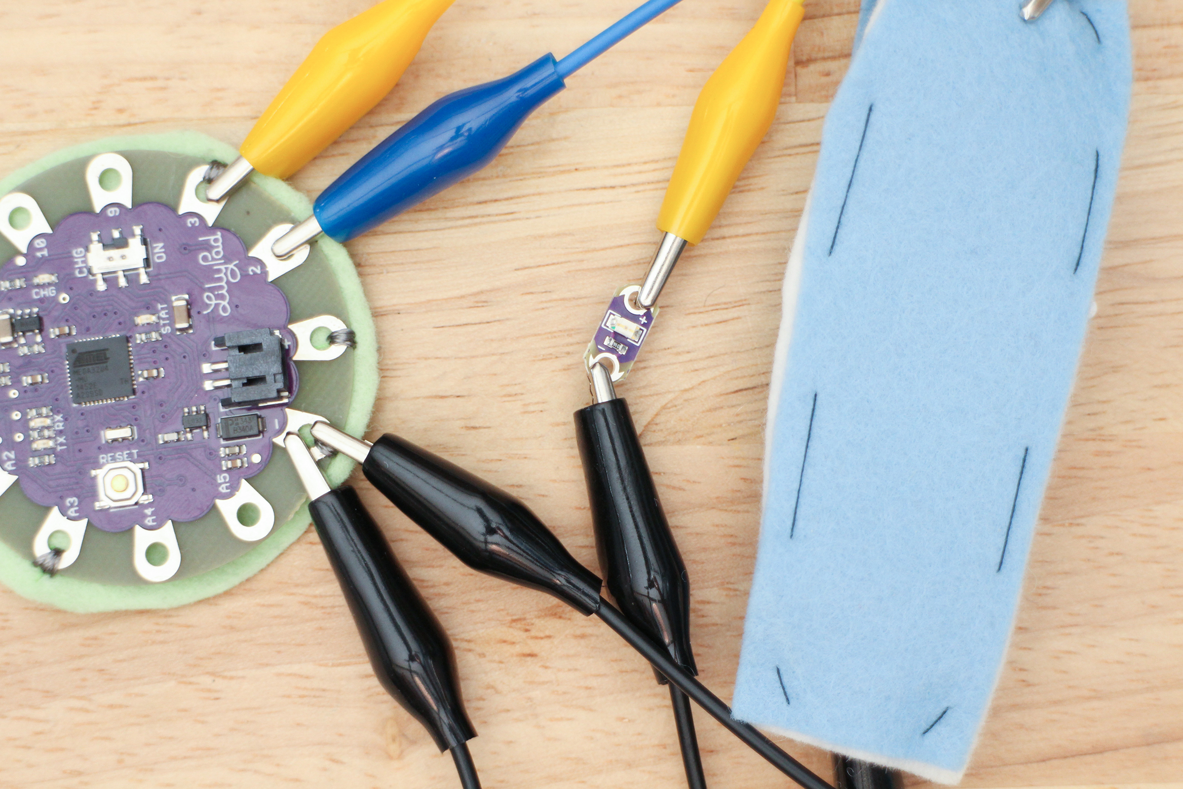

Step 2: Build Circuit
Follow the diagram to make connections between your handmade switch and the microcontroller.
Switch --> ground (-) LilyPad
Switch --> pin 2 LilyPad

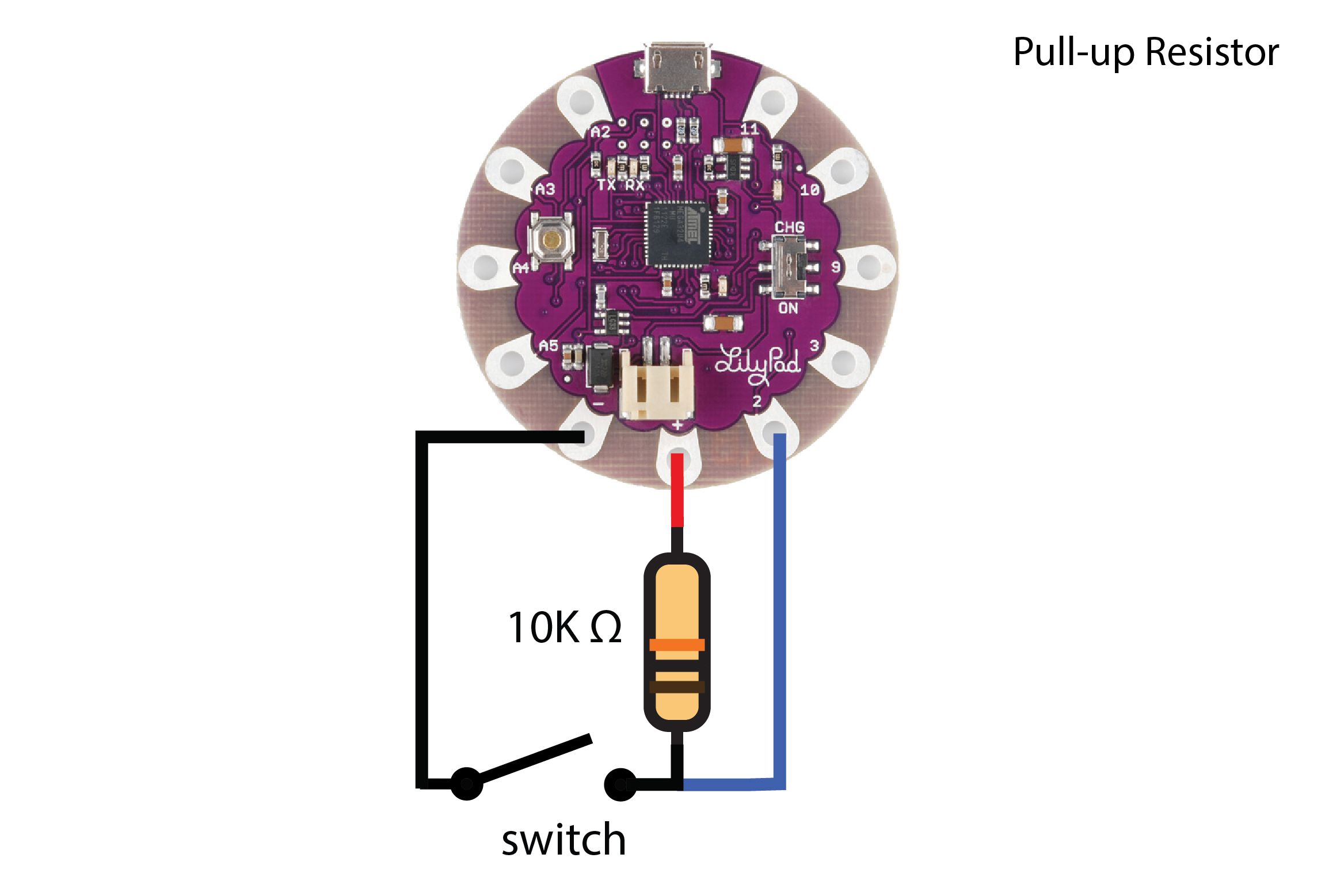

Step 6: Add a Pull-down Resistor
Grab your 10K Ohm resistor and connect it to the switch and board as shown. I sewed my resistor to a piece of fabric to make it easy to reuse and clip to, but you can clip to the metal leads just the same.
When a resistor with a value of 10K ohm or higher is connected between the input pin and ground, it pulls the pin down to 0 volts when the switch is open. When pulled LOW to ground (0 volts), the input pin reads 0.
Upload the DigitalReadDemo sketch and open up the serial monitor. 0s will print until the switch is pressed. When the switch closes, the digital input is pulled to HIGH to 3.3v, which will print 1s. You can now see a clear relationship between your presses and the printed data!

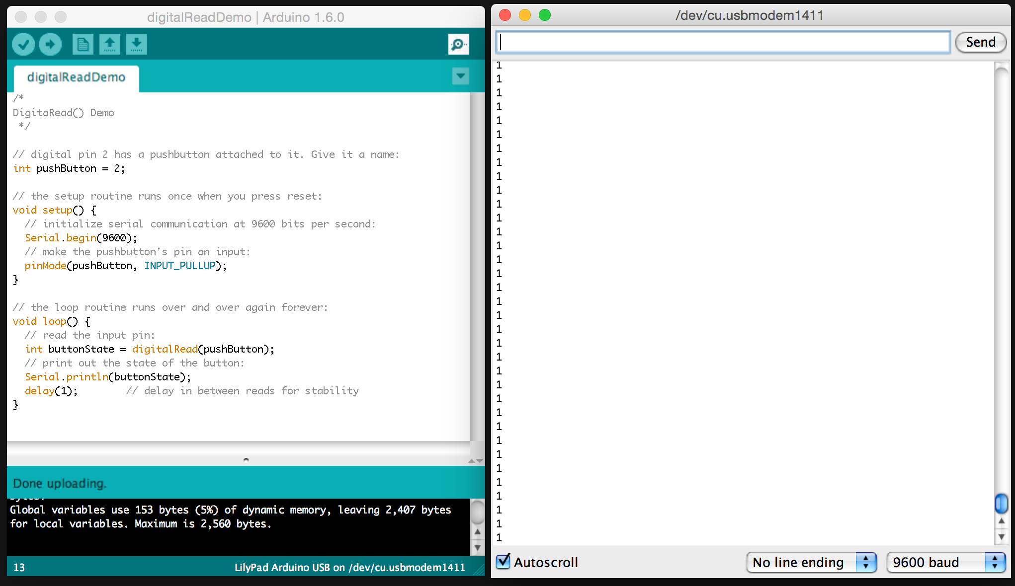

Step 8: Open Serial Monitor
Upload the sketch with _PULLUP added to enable the pull-ups and open the serial monitor. The pin your switch is connected to now references 3.3 volts and prints 1 when the switch is open and prints 0 when closed.

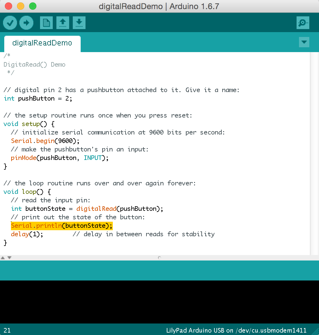

Step 9: The Code
Serial.begin()
To read the signal coming in from your board through USB, you need to open up a serial connection. Serial.begin() opens up that port. This command is always put in the setup function since it only needs to execute once.
Serial.begin(9600);
The rate at which the data travels is 9600 bits per second. The door is open now to let the data come in and go out between the computer and the Arduino.
DigitalRead()
Next, a variable is created to hold the data coming in from your switch. The function digitalRead() is used to see if the signal is HIGH/LOW, or 0/1. The function takes one argument, the pin number that you want it to read which is stated using the pushButton variable. In other words, this line of code says "Put the 0 or 1 coming from pin 2 into the variable named buttonState."
int buttonState = digitalRead(pushButton);
Serial.println()
To print the data coming from the switch, use the Serial.println() function. It takes one argument, the variable that holds the data you want to print. In our case, this the buttonState variable that holds that 0 or 1 coming from our switch.
Serial.println(buttonState);

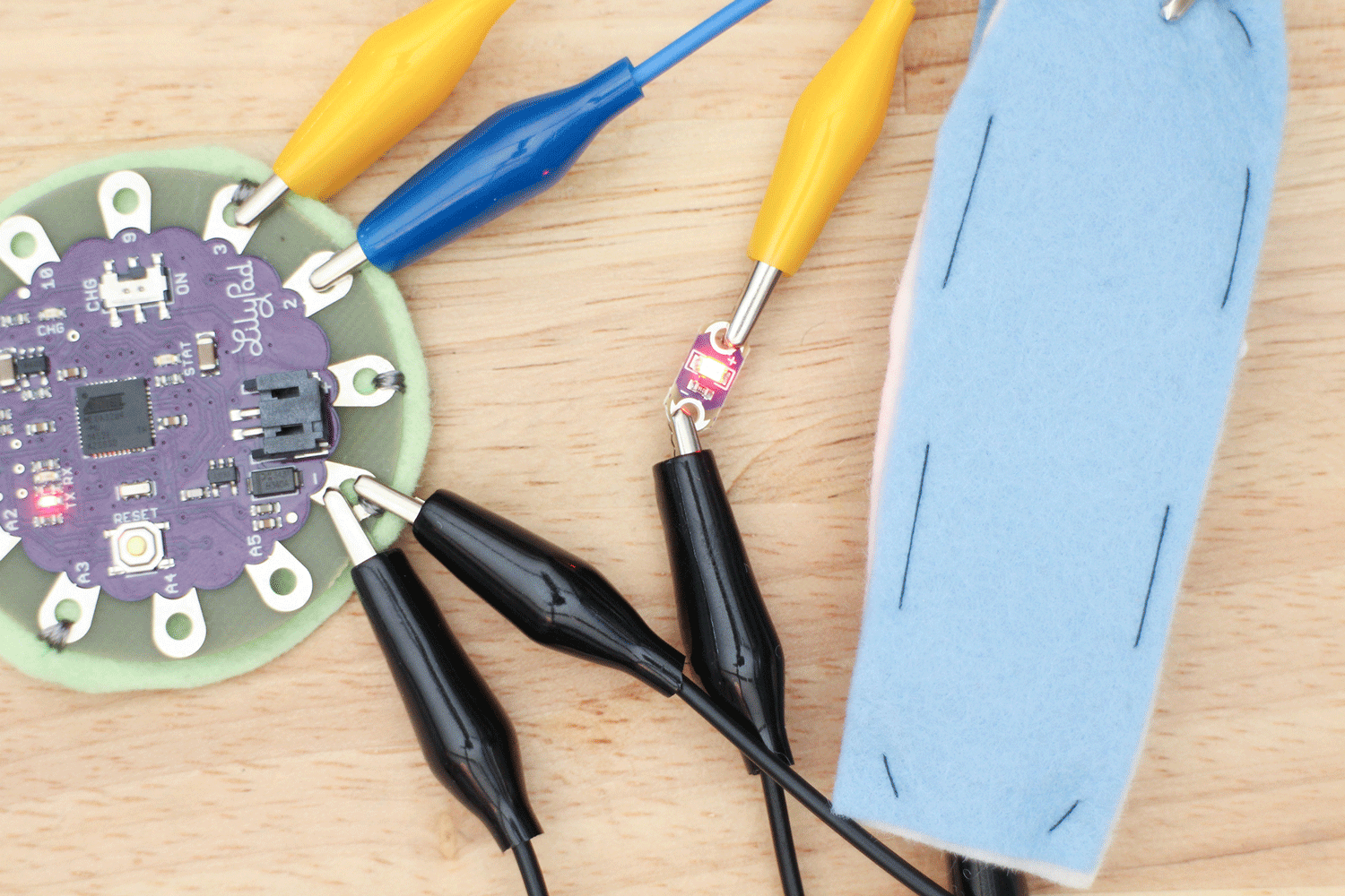

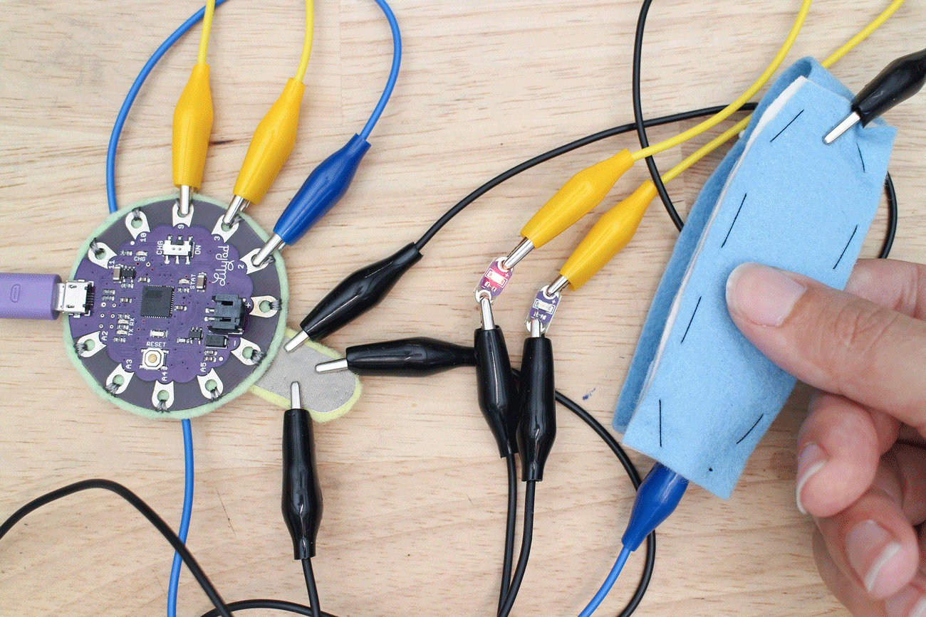

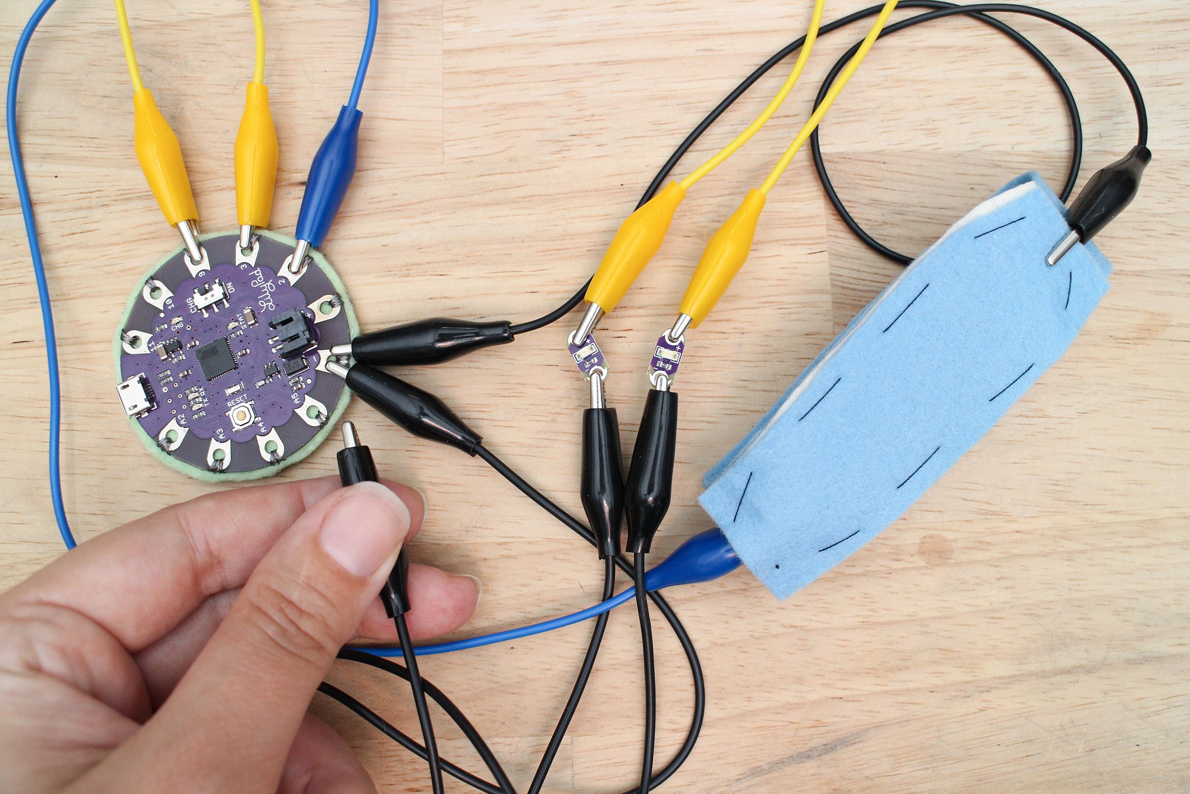

Step 10: Combine Input and Output
So far, you have learned how to blink an LED output and read a switch input. Now, let's get one affecting the other. Keep the switch on pin 2 and make these new connections using a sewable LED:
LED power (+) --> pin 3
LED ground (-) --> ground (-)
In the Arduino IDE Navigate to:
Examples > Digital > Button
Copy and paste the example sketch in a new window and save as buttonLEDdemo.
Plug in the pin number of your LED and switch and enable the pull-up resistor for your switch.
const int buttonPin = 2; const int ledPin = 3;
pinMode(buttonPin, INPUT_PULLUP);
In this example sketch, there is no serial port set up, so you need to add this line between the curly brackets of the setup() function.
Serial.begin(9600);And this line to print the button state in loop() directly under buttonState = digitalRead(buttonPin);.
Step 11: Upload
Upload sketch and open the serial monitor.
A 1 will be printing as the switch is open and the LED is on. When the switch is closed, the LED will go off and a 0 will print. Great! The LED is being controlled by your actions!

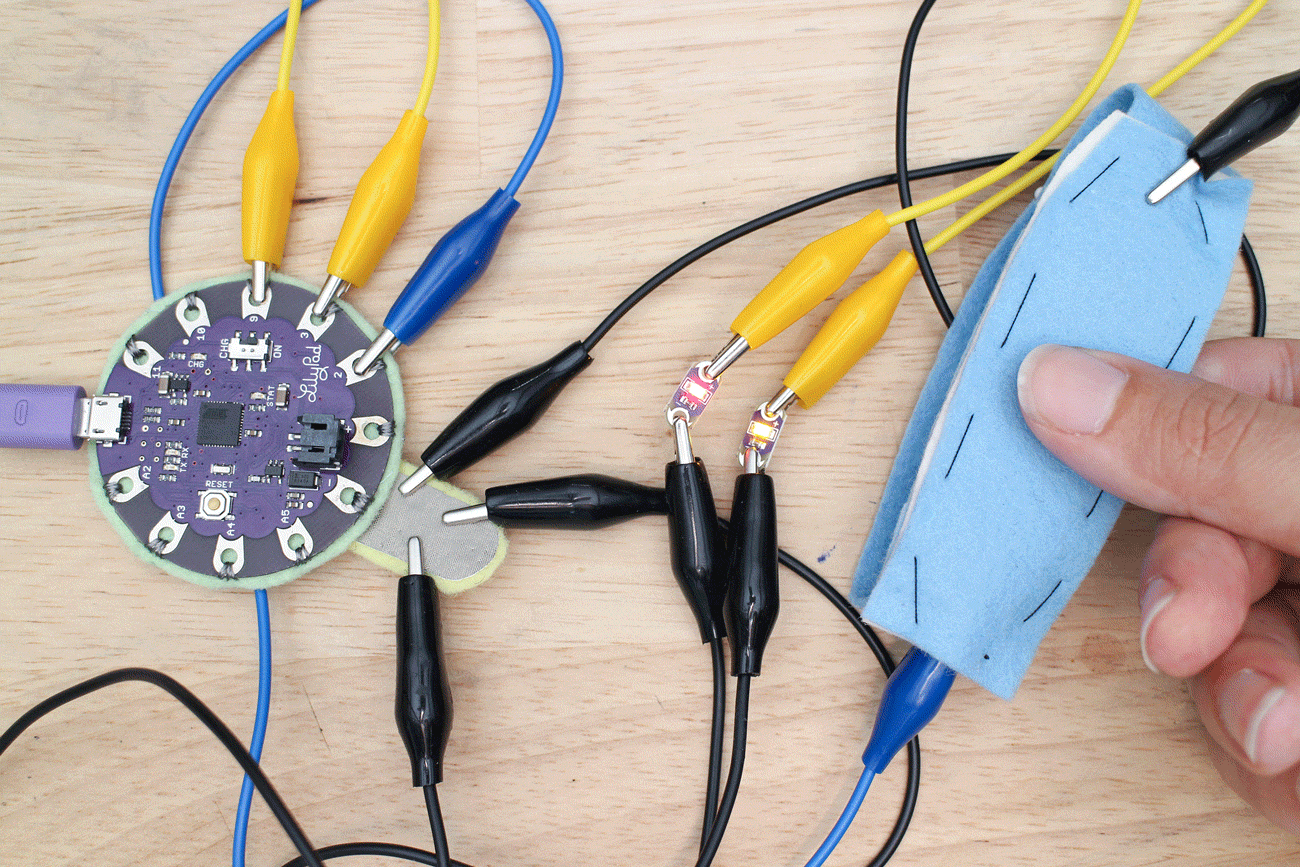

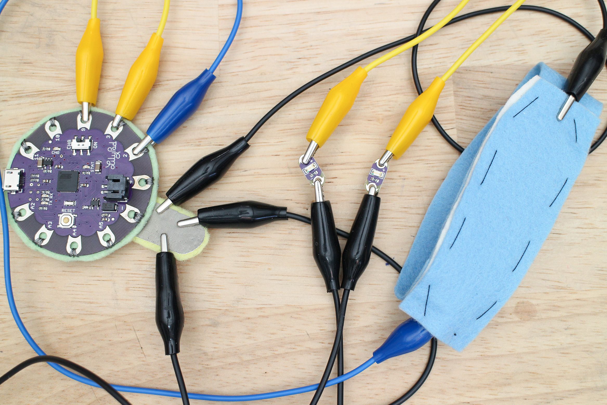

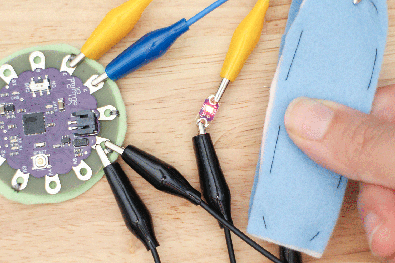

Step 14: Add a Second Output
Now that you are getting more familiar with the code, let's add a second output.
Grab a second sewable LED and make these new connections:
LED power (+) --> pin 9
When connecting the LED to the ground on the LilyPad USB you will notice that there isn't much room left. This is a common occurrence since multiple components in a circuit need to be grounded for electricity to pass through them. When prototyping, you will need room to ground more than two components often.
This is when your handmade snap switch comes in as a breakout for the ground pin (-) on the LilyPad. In general, a breakout extends and exposes the pins of a board. This is what the socket side of the snap switch can do for the ground (-) pin on your LilyPad USB.

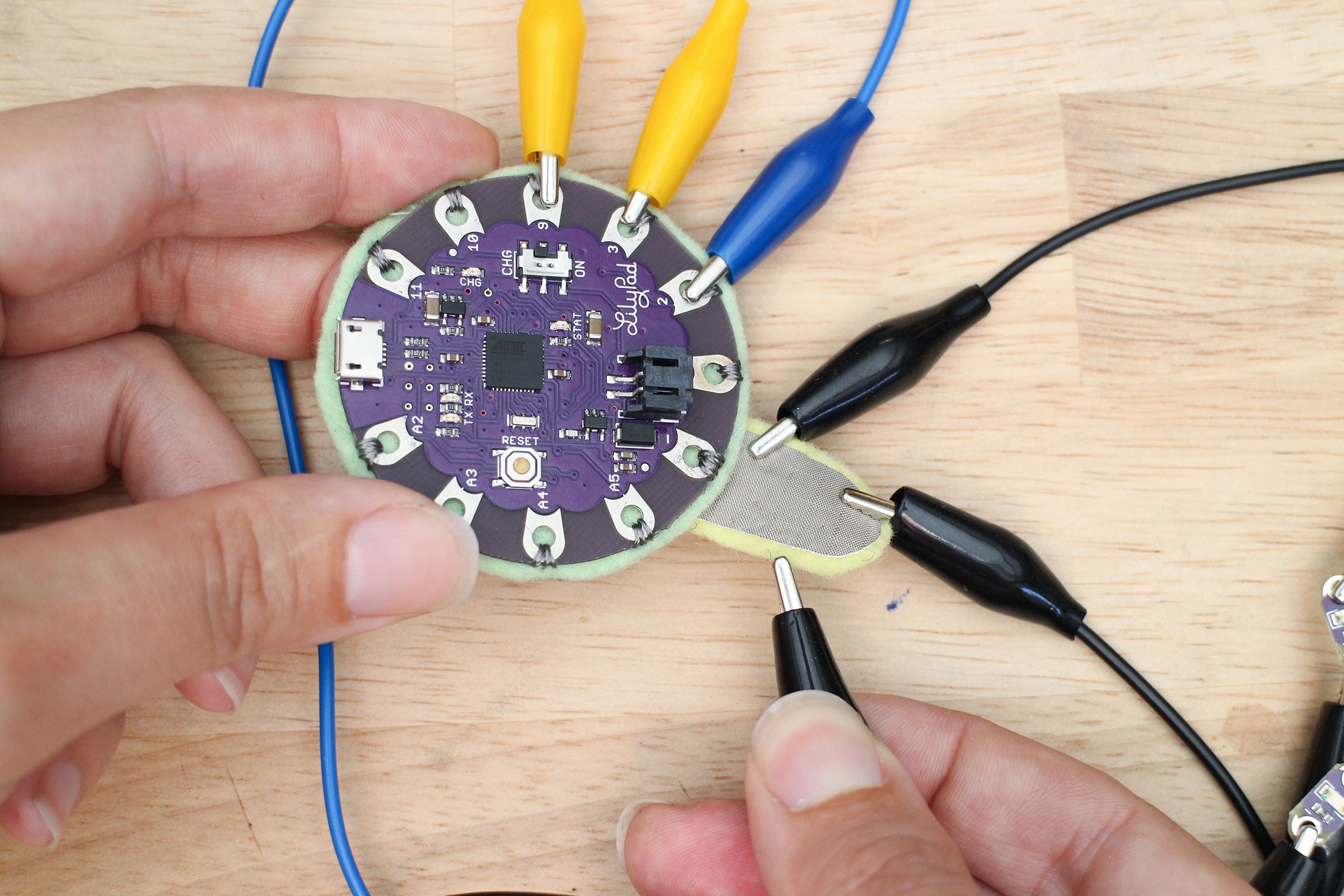

Step 15: Breakout Ground Pin

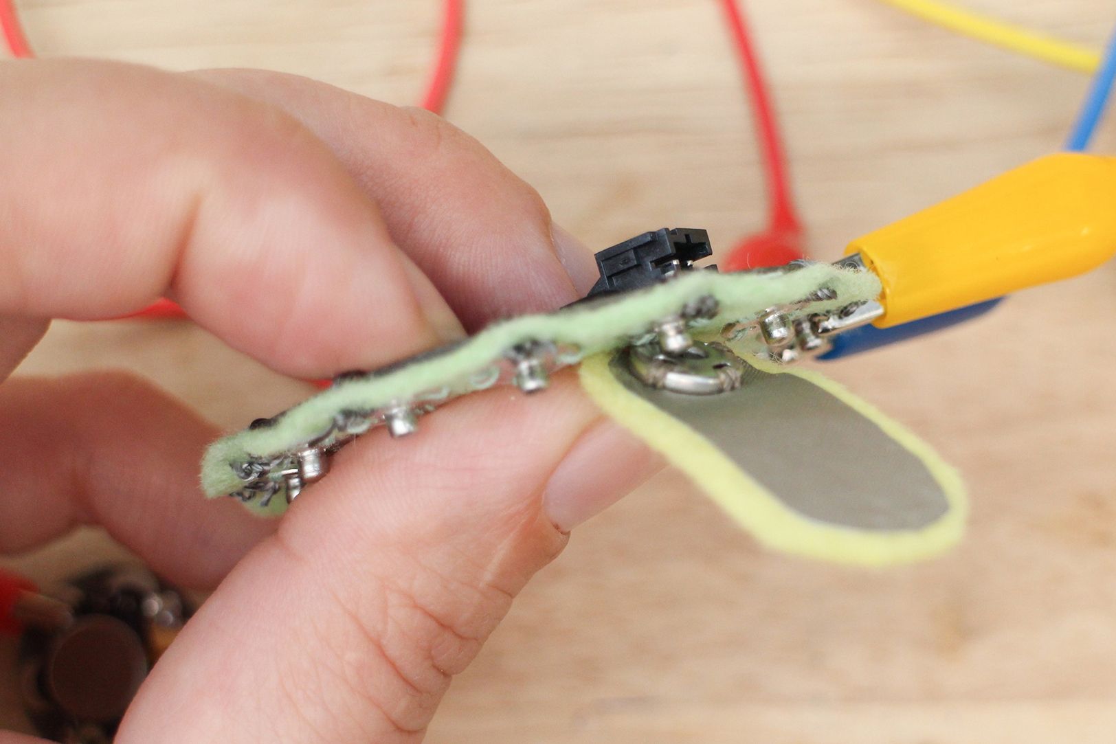

Disconnect the two alligator leads on the ground pin. Take the socket side of your snap switch and snap it onto the back of the LilyPad USB.
With the breakout snapped on, you now have room to clip on all three components: one switch and two LEDs. Keep this in your wearable electronics toolbox, it will come in handy for prototypes to come!

From the sketches you downloaded earlier in this lesson, find and open the button2LEDdemo sketch.
This sketch combines the if() statement and two instances of digitalWrite(). Each instance uses a variable that contains either of the LED pins.
Step 17: Upload
Hit the upload button and press the switch. Both LEDs will turn on while the switch is closed. Look at the sketch, can you write down why that is happening by reading and translating the code?
