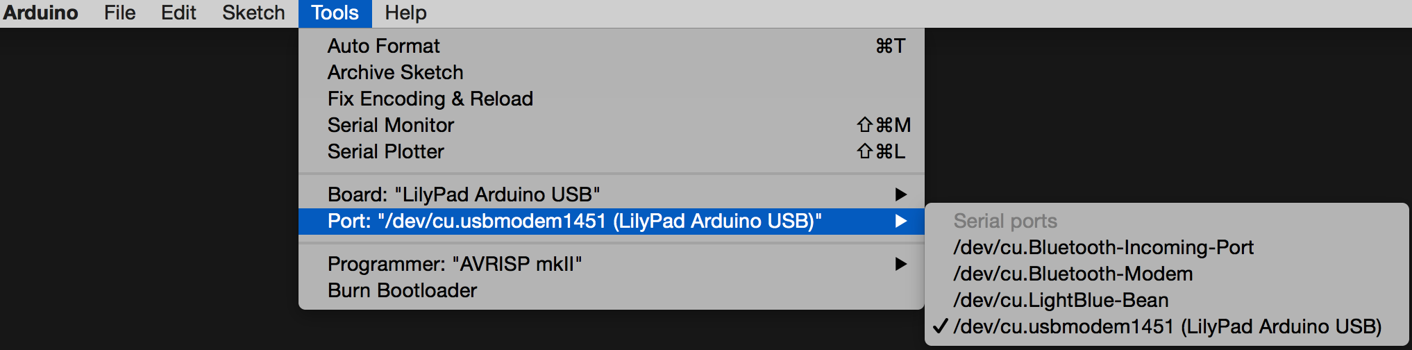

Plug in the LilyPad USB board using a micro USB cord. Before you can upload a sketch to the board, you need to do two things
1)Choose what board you are using.
In the software navigate to:
Tools > Board > LilyPad USB
2)Choose what port to communicate through.
Mac
Tools > Port > /dev/cu.usbmodemXXXX
Windows
Tools > Port > COM X
The software will hint to you which port to use by listing the board's name next to it. This is very convenient. With older versions of Arduino, this does not occur. If you do not see your board's port, uninstall the drivers and install them again, close the Arduino application and reopen.

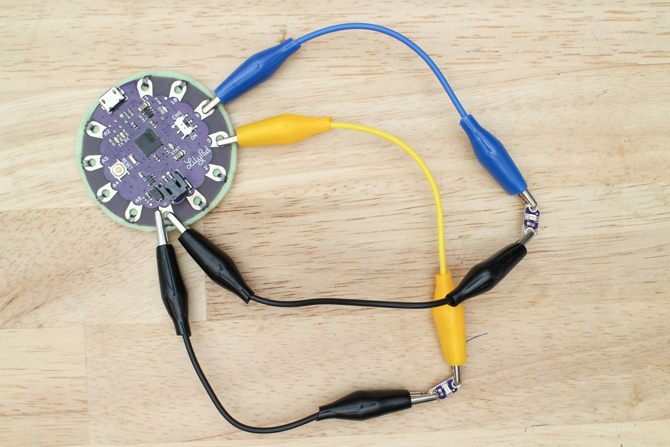

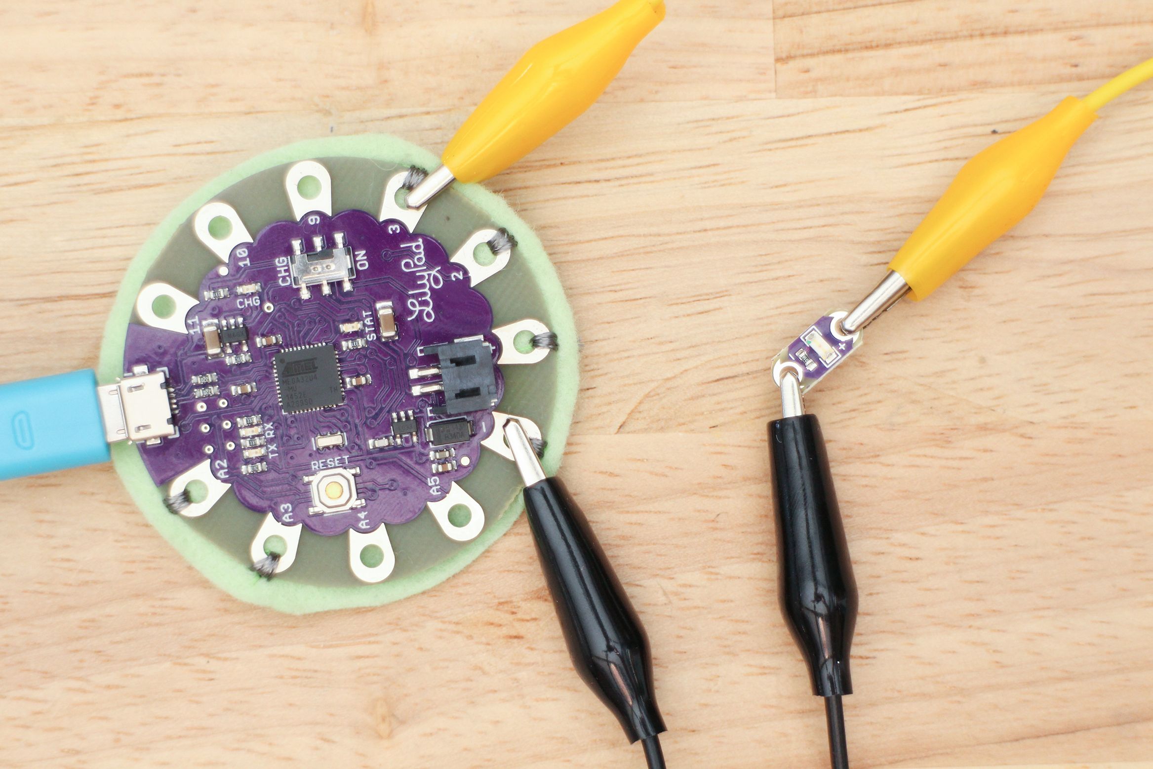

Step 4: Build Circuit
Before connecting anything to the board, turn the power switch toward CHG. This prevents the board from getting power from your computer. Always make connections when the board isn't powered.
Grab the alligator leads and use them to make the connections between the LED and the microcontroller as shown.
LED power (+) --> pin 3 LilyPad
LED ground (-) --> ground (-) LilyPad

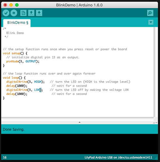

Step 5: Open Sketch
The Arduino IDE comes with a lot of built-in example sketches to work with. You can find these in the Examples folder located under File. This is a good place to start and get snippets of code to learn and build from. Arduino has excellent support on the forums and lots of documentation to learn from on their website, which I will continue to link to throughout the next few lessons.
To open your first example sketch, navigate to:
File > Examples > Basics > Blink

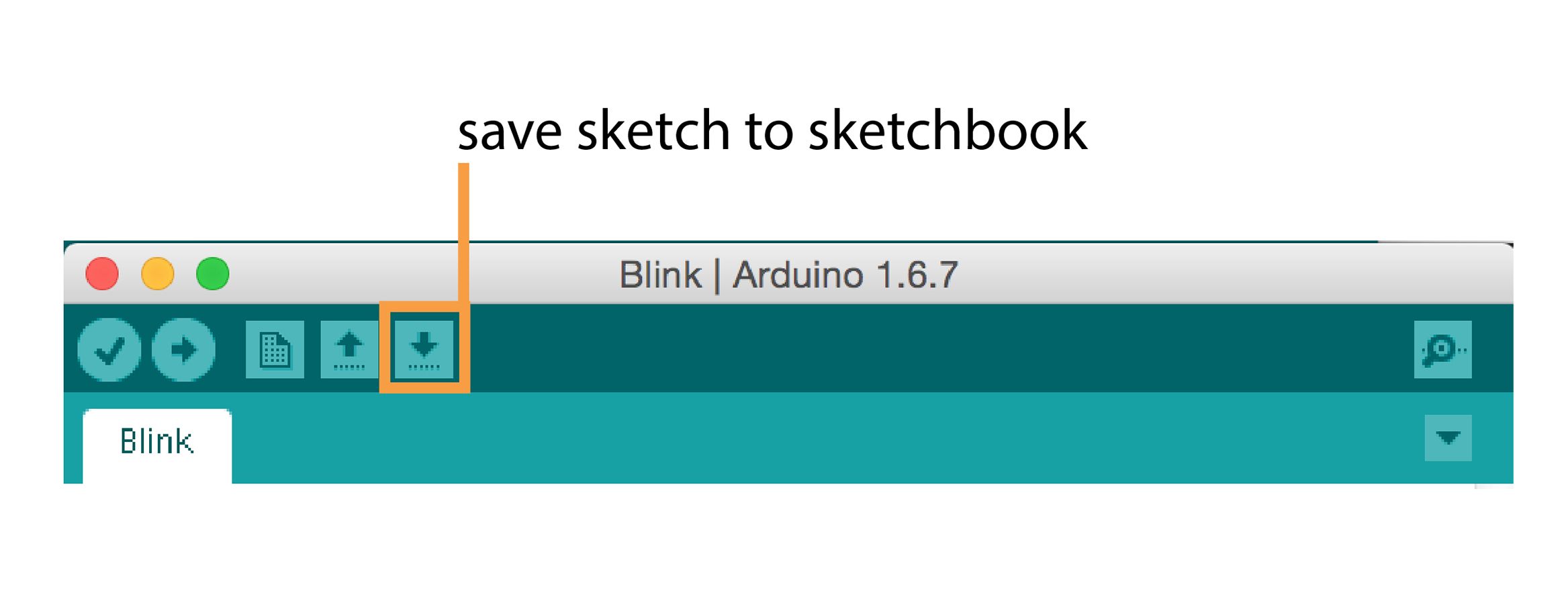

Copy and paste the example sketch in a new window and save as BlinkDemo. When you save a sketch it is saved to your Sketchbook which is found by going to: File > Examples > Sketchbook
Step 6: Define LED Pin Number
The example Blink is a popular first sketch to upload to a board for the first time. This is because it's a simple sketch that is an excellent way to be introduced to Arduino and programming basics.
Before you upload the sketch there is one thing that needs to be changed. In a sketch, you need to define what pin number your component is connected to in order to read and write to it. Start by looking at what pin you clipped your LED on, then look at the sketch and notice that the example's pin is defined as 13. Your LED is connected to pin 3, so every time it says 13 in the sketch, change it to 3.

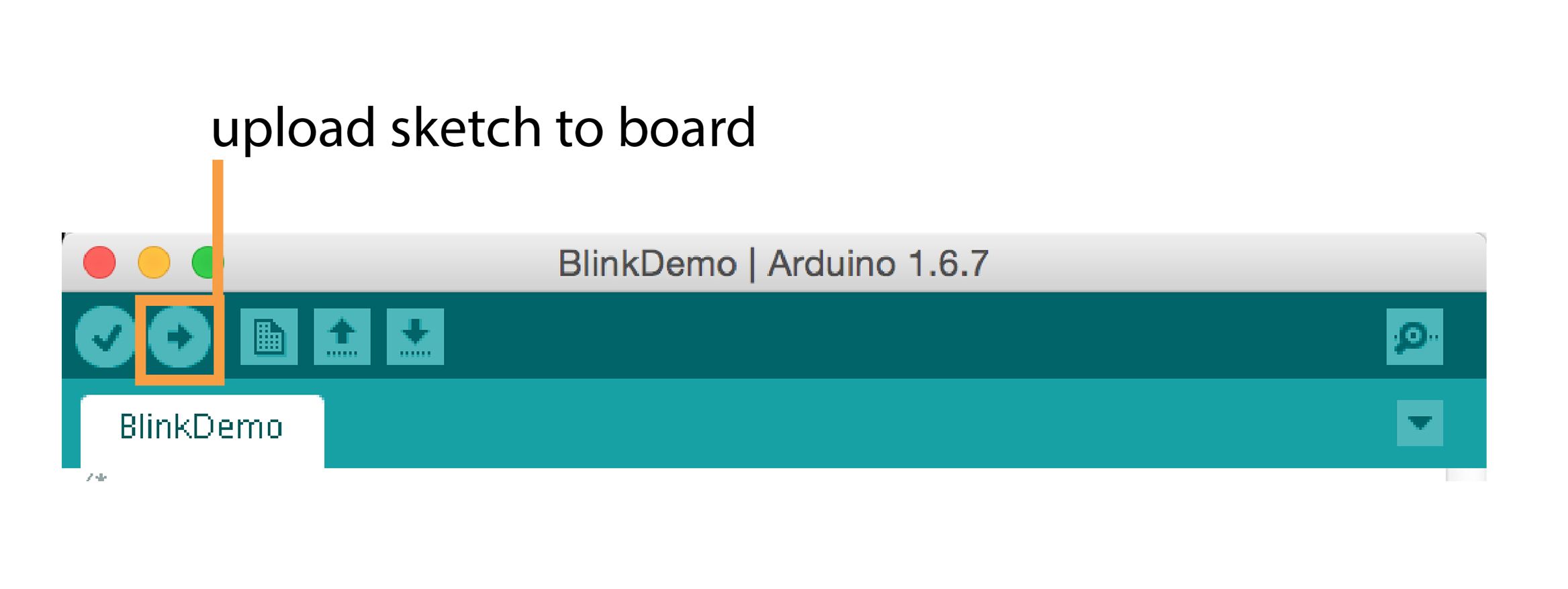

Step 7: Upload
Turn the board on and check that your port and board chosen under Tools. In the sketch window, press the button with the arrow pointing to the right to upload the sketch.
Once the button is clicked, Arduino will verify your code, looking for syntax, spelling, and other errors. It will then upload it to your board. You will see an error print out at the bottom if there is something wrong with your sketch. If there is an error, open a new Blink sketch and compare it to yours, looking for discrepancies. You may have accidentally erased something while copying and pasting, or forgotten to change your pin number.
Once uploaded, you will get blinky success! The LED will blink on and off every second.

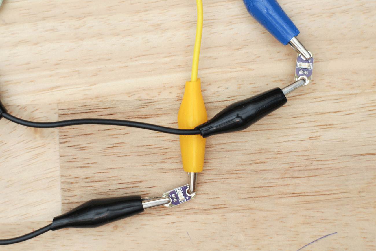

Step 12: Add a Second Output
You've got one LED going, let's make it more interesting and add a second.
With an LED still on pin 3, make these new connections:
LED power (+) --> pin 9 LilyPad
LED ground (-) --> ground LilyPad
