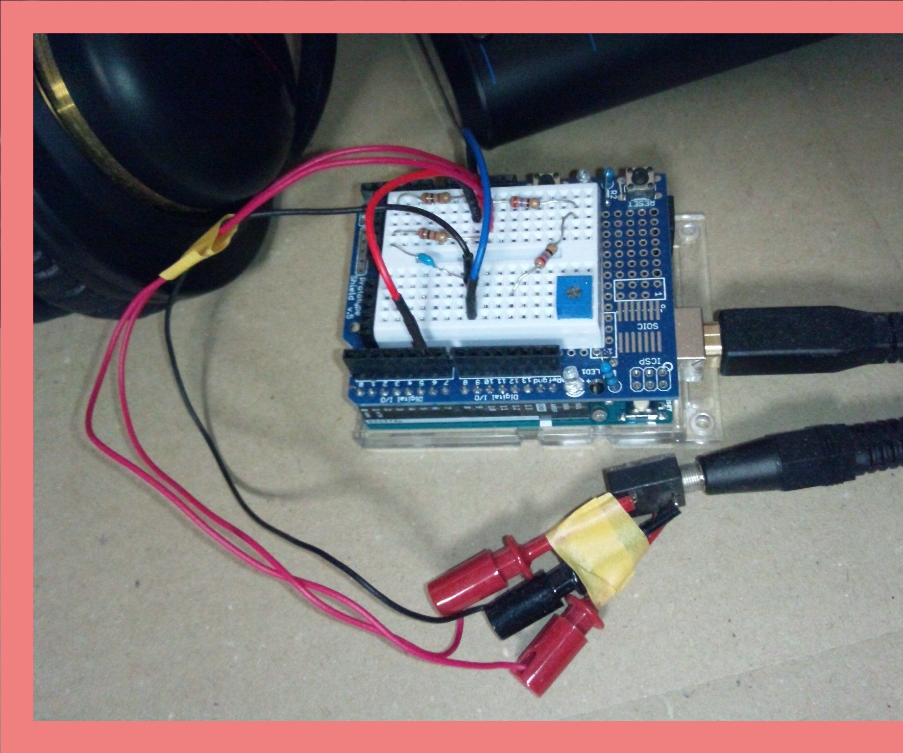

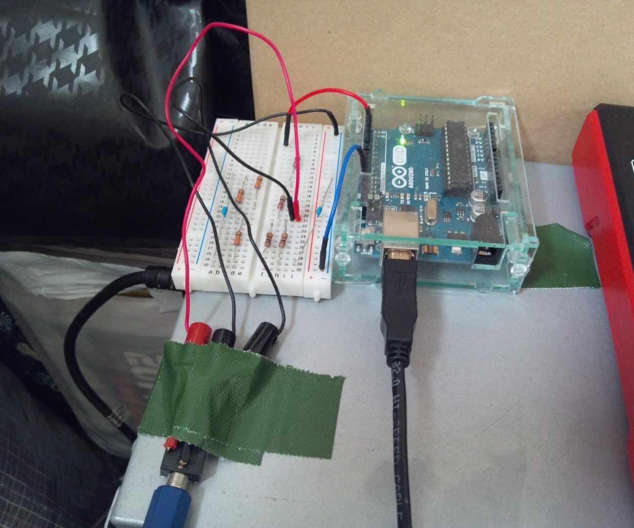

Step 1: Wiring
Required Hardware
  • A1: Arduino Uno
  • U1: 3.5 mm Audio Jack
  • R1: 150 ohm Resistor
    • or 140 ~ 160 ohm Resistor (e.g. 100 + 47, 100 + 27 + 27)
  • R2: 100 ohm Resistor
  • C1: 100 nF Capacitor
  • Wires
Wiring
  • See the image
