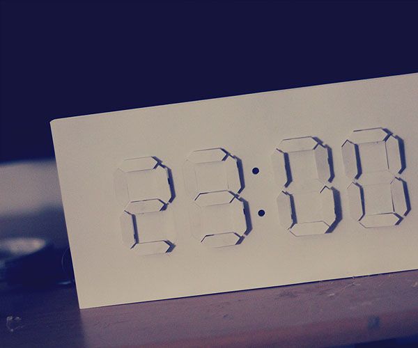

Essentially, we have a seven segment clock where instead of LED's we have digits moving in and out of the pane, the shadow created by these digits will allow the user to read the time against the white on white digits. By using 28 servos, we can use a arduino to first process the current time and then push the digits out accordingly through the motor controller. more will be explained in the later pages.
I've tried to keep the parts as simple as possible, using readily available parts without a deep knowledge of electronics one can begin to explore creating their own clock. I do not have 3D printer so construction will be done by way of papercrafting.

The metal rods were cut using a dremel. I cut the bigger tube 1cm and the one that slides inside it to 2cm
Step 5: Construction
Note: Metal tubing is inserted into each segment
Step 6: Add the Digits
-Place inner tubing in outer tubing
-Apply Glue
-Place front facing piece
-Repeat
