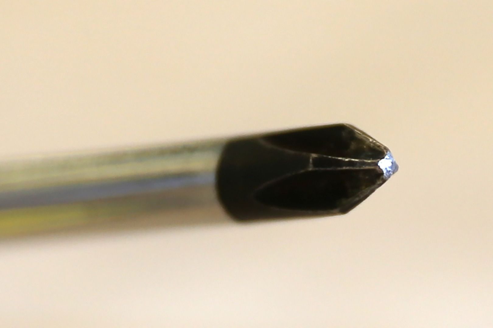

Phillips - Widely used and versatile screw. Advantages are that even incorrect size drive can fit into screws, disadvantage is moderate cam out (though some screws are designed to induce cam out to prevent over tightening).

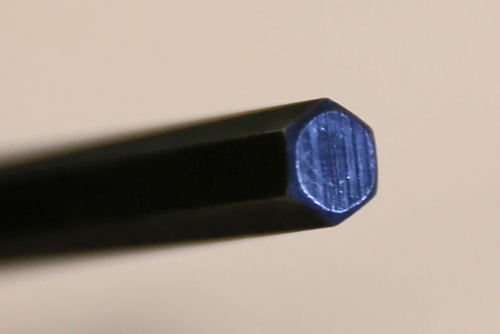

Allen - A relative to Torx and can sometimes be used interchangeably. Advantages are low cam out and high torquing ability, disadvantages are that it's uncommon for wood screws (mostly used for machine screws). You probably have a bunch of Allen drivers from IKEA furniture.
