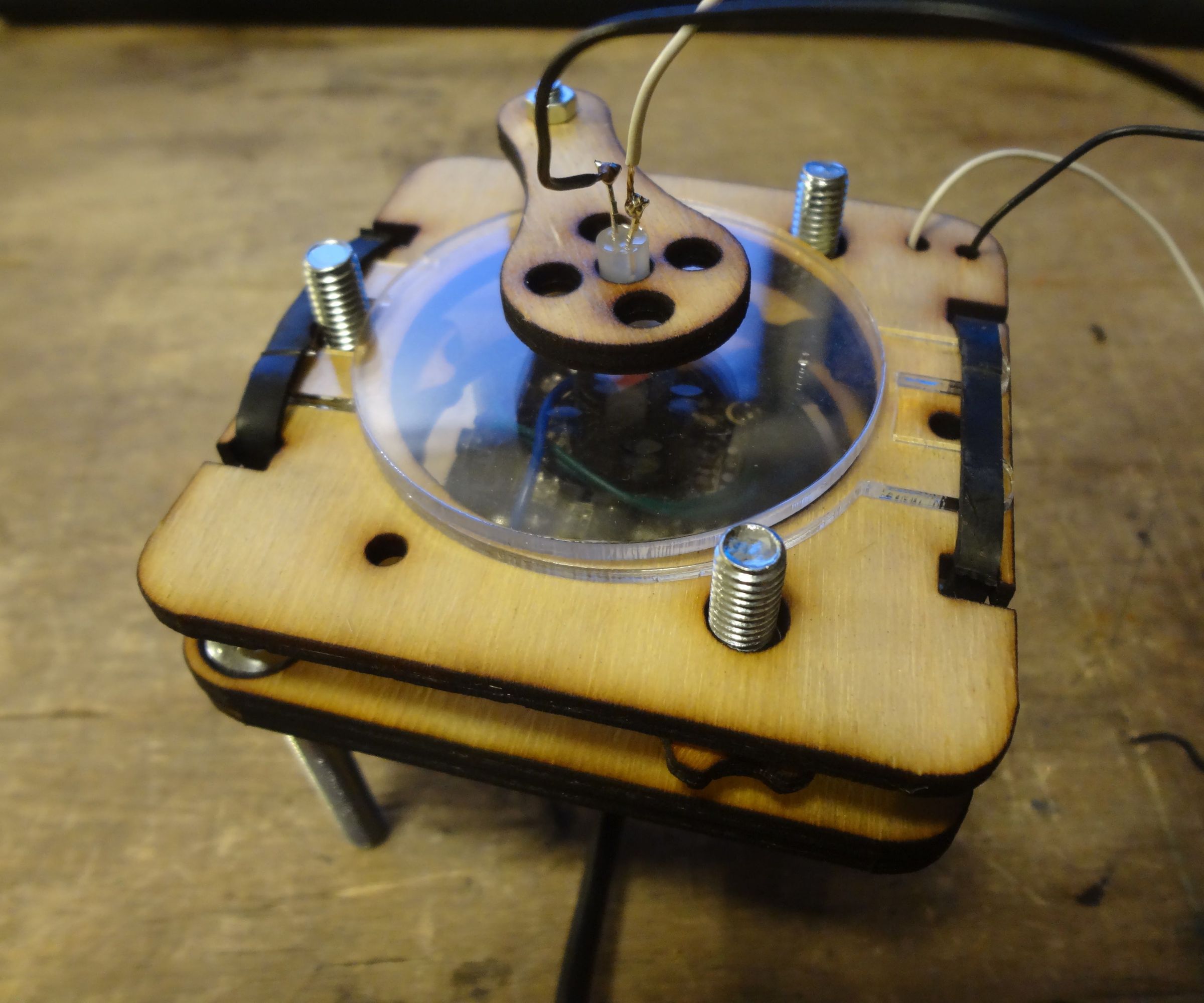

Step 2: Cutting the Case
Cut the case provided in .dxf drawing using the laser cutter.

Step 3: Assemble the Base
Step 4: Assemble Syringe Holder
Step 5: Assemble Laser Pointer Holder
Step 6: Conect Laser Holder to Syringe Holder
Step 7: Add Rubber Band
Rubber band will provide tension to laser pointer and make it move together with adjustment ring.
