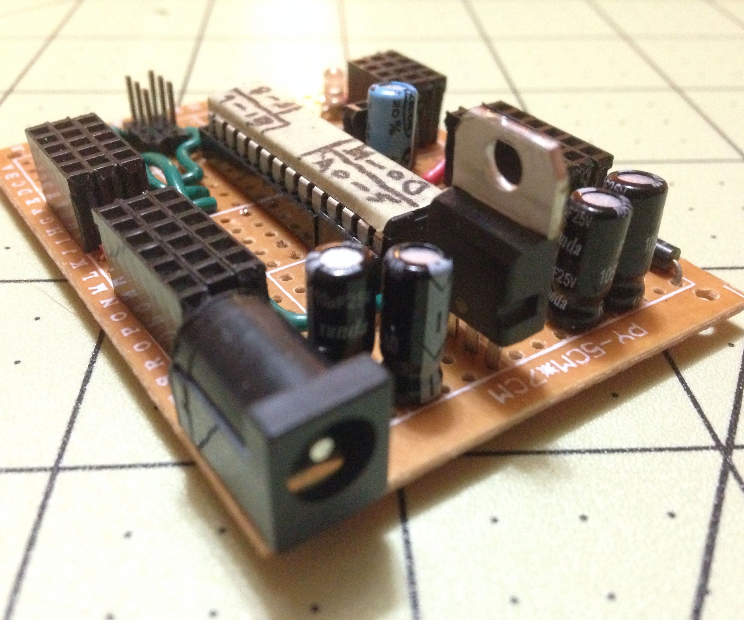

I one day found myself needing to display a binary value in Hexadecimal. The project was centered around an 8-bit Microprocessor. I needed to view the values of it's Address and Data busses as I stepped through programs.
Unfortunately, there are not, to my knowledge, any currently manufactured logic ICs to achieve this. Knowing that there were examples of both Lattice and Atmel PLDs being used as Hex drivers, I decided to start there. However, I immediately hit a setback. The first problem was that all examples would only drive a single digit display. Since I needed six digits, this would increase my chip count. The second problem was that each of these older devices are quite power hungry, often to the tune of 100mA. Just displaying the six digits could consume over half of an Amp!
So, I set out to find a way to display two digits with one GAL22V10. And the project was quite interesting. The biggest problem I encountered was that the internal Macro Cells just didn't have enough room for the combinational logic equations that I wrote using OpalJr. Figuring that it was quite outdated, I decided to learn another descriptive language and tried my hand at WinCUPL, available from Atmel.
Designed with Atmel variants in mind, WinCUPL has a better compiler, one that has several minimization settings. This would be crucial in getting the description to fit. And the JEDECs compiled are compatible with Lattice Devices.

Step 4: Wiring the Device
One thing to note is that this driver is designed for a Common Cathode display. Although if you needed a Common Anode driver, the source is easy to edit, and self explanatory. If enough requests are made I may rewrite and include a Common Anode variant of the JEDEC.
Another consideration is that this driver requires a TTL clock signal. The speed isn't critical, anything from a few kilohertz to megahertz should work fine. But it does need to be a fairly clean square wave. I have noticed that higher frequencies tend to cause partial illumination on unlit segments. I am assuming this to be the result of the limitations of the device itself. It does has a propagation delay of around 4ns.
Aside from that, pin 1 is the clock, pin two through 9 are inputs D7-D0. Pin 24 is VCC, Pin 12 is GND, and the outputs are pins 15-23, with pins 15 and 23 being active low to sink current from the ground pins of the displays.
The theory of operations is simple. The data lines are connected to pins 2-9, the clock to pin 1, and the outputs to pins 16-22 according to the pinout of your display. Pin 23 is connected to the ground pin of the high nibble, Pin 15 is connected to the low nibble's ground pin. When the clock signal is LOW, the data from the High Nibble is converted from BCD to Hex, and displayed on the first Display. When the clock signal is HIGH the data from the Low Nibble is converted from BCD and displayed on the second Display. And that's really all there is to it. There is no blanking supported. So if a value is zero, it is going to show a '0'.
