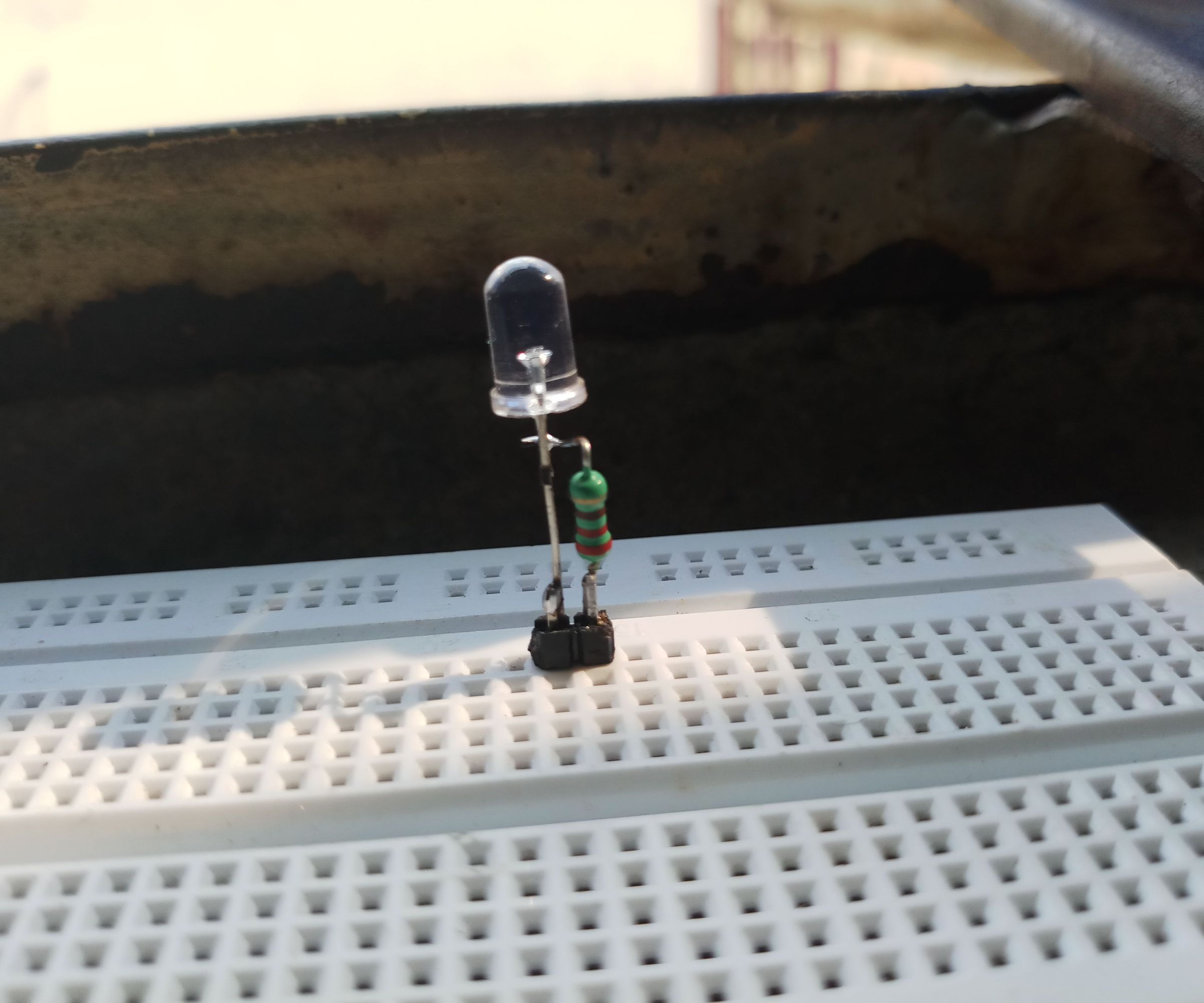

The buzzer will beep and LED will be on in presence of your watch. You can modify the character of the beep. We are filtering the BLE devices and make ESP32 to respond to only our watch by supplying the MAC in our code. Instead of the buzzer and LED, you can use a relay to control the electronics of your house and a caravan.

Step 1: Required Setup and Tools
The things you need for this projects are :
  1. An ESP32
  2. The ESP32 must be configured with Arduino IDE (there are plenty of guides on the web)
  3. Tweak Arduino IDE to allow bigger sketch and avoid too large sketch error (I have a guide to avoid ESP32 Sketch Too Big Error, you can follow it)
  4. An Android smartphone with BLE (or a computer with BLE)
  5. Install nRF connect application on that Android smartphone (I have mentioned that in this guide, you can follow it). See the above screenshot.
  6. A buzzer, a breadboard and some jumpers or wires.
  7. Install the library named “EasyBuzzer” (you'll get here on GitHub). I modified the value of DEFAULT_PIN in Config.h file from Pin 4 to Pin 13 (The file is located at C:\Users\username\Documents\Arduino\libraries\EasyBuzzer\src on Windows 10 PC). See the below screenshot.
Step 2: Edit the Code and Upload
If you have completed the above steps then you are ready to go. Add the buzzer’s positive pin to the Pin 13 and negative pin to GND pin of ESP32. Then test the buzzer with some basic example of the library.
Below is the required sketch. You will get the same sketch on my blog post and this GitHub Repo (the main.ino file) as well. Only you need to edit the below line :
String knownAddresses[] = { "e0:a1:07:b7:0b:95"}; // change the MAC
Replace "e0:a1:07:b7:0b:95" with your MAC address found by nRF application.
