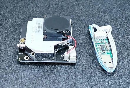

  This time I will show you how to make a device that monitors the quality of fine dust particles in the atmosphere. It measured both PM10 and PM2.5 particles uses the Nova PM SDS011 Laser Sensor. This sensor has a built-in fan which greatly simplifies construction and it has built-in logic-level serial communication providing direct readings of the PM2.5 and PM10 values without having to use maths to manipulate PWM values to obtain the results.
   The sensor itself is delivered together with a USB to Serial converter, so we can connect it directly to the USB port of the PC. In that case, we need to use appropriate software that we can download from the sensor manufacturer's website (http://inovafitness.com/en/a/chanpinzhongxin/95.html).

   - Nova PM SDS011 Laser based sensor

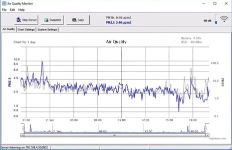

  We can also observe this graph on PC using the application "Air Quality Monitor" which you can download below.  After installing the program, we need to make some simple settings:
First of all, as I mentioned before, we need to set the local IP address on PC Network adapter, that is previously defined in the code. In the system settings tab we also need to enter the port given earlier. Then in the chart settings we adjust the titles and shape of the graph, and finally in the Air Light tab we can graphically observe the concentration of PM particles during the day. Just to mention that the first results on the graph will appear after 24 hours.
