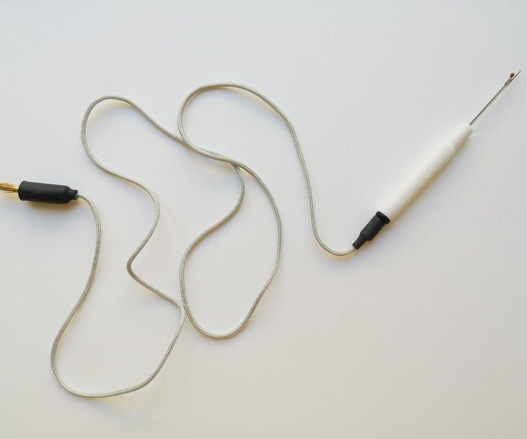

The Pin Probe is a test lead to connect between a multimeter and conductive fabric or thread. The probe consists of a pin to make temporary but firm contact with textile materials without harming them. A soft and flexible textile cable then connects the probe to a banana plug to connect to a multimeter.
The Pin Probe is designed to aid processes of textile electronic making, allowing to pin the probe to the textile material and have both hands free for the crafting routine. Directly while stitching the connection, the multimeter provides continuous information about its current electrical value. The immediate feedback allows instant action, facilitating an aesthetic-driven workflow to reach precise electronic results.
This instructable shows the making of a Multimeter Pin Probe. But you can also make a prototyping cord with pins at both ends, if that is what you rather need, or with a clip, or any other connecter at the other end.

Step 10: Finishing
- measure the resistance between the two ends of the probe
- the resistance should not be higher than what you measured last time, ideally it is lower, as everything is closely glued together now
- you can do the measuring in plugging the Pin Probe into the multimeter and contact the pin with the other probe
- the Pin Probe is now finished
