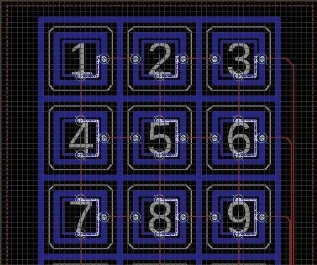

  • I've managed to mill simple PCBs that are fine enough to take surface mount components - so far 0.05" pitch SOIC, but I'll be attempting to do TSSOP soon. The mill can easily manage 0.0025mm precision so well up to the job if you have the right milling bit! The photos shows my first ever milled item and the 1mm bit was far too large. I've done better since.
