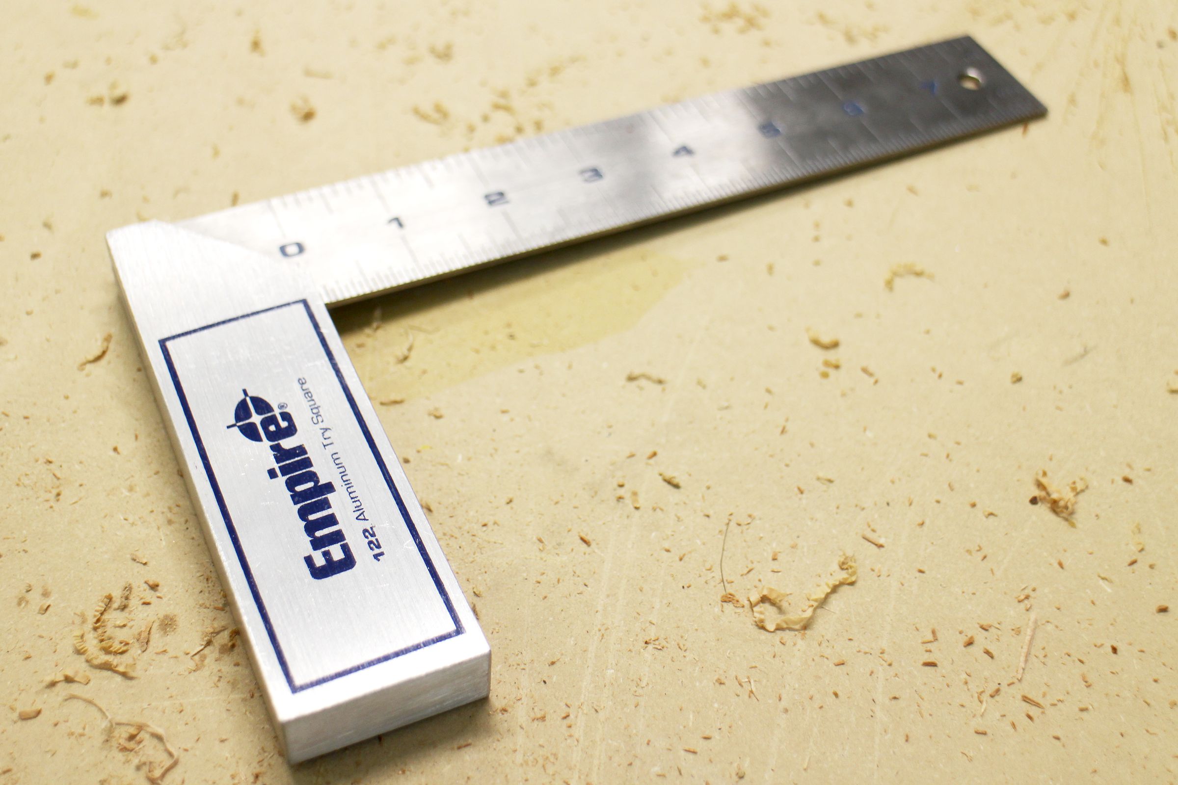

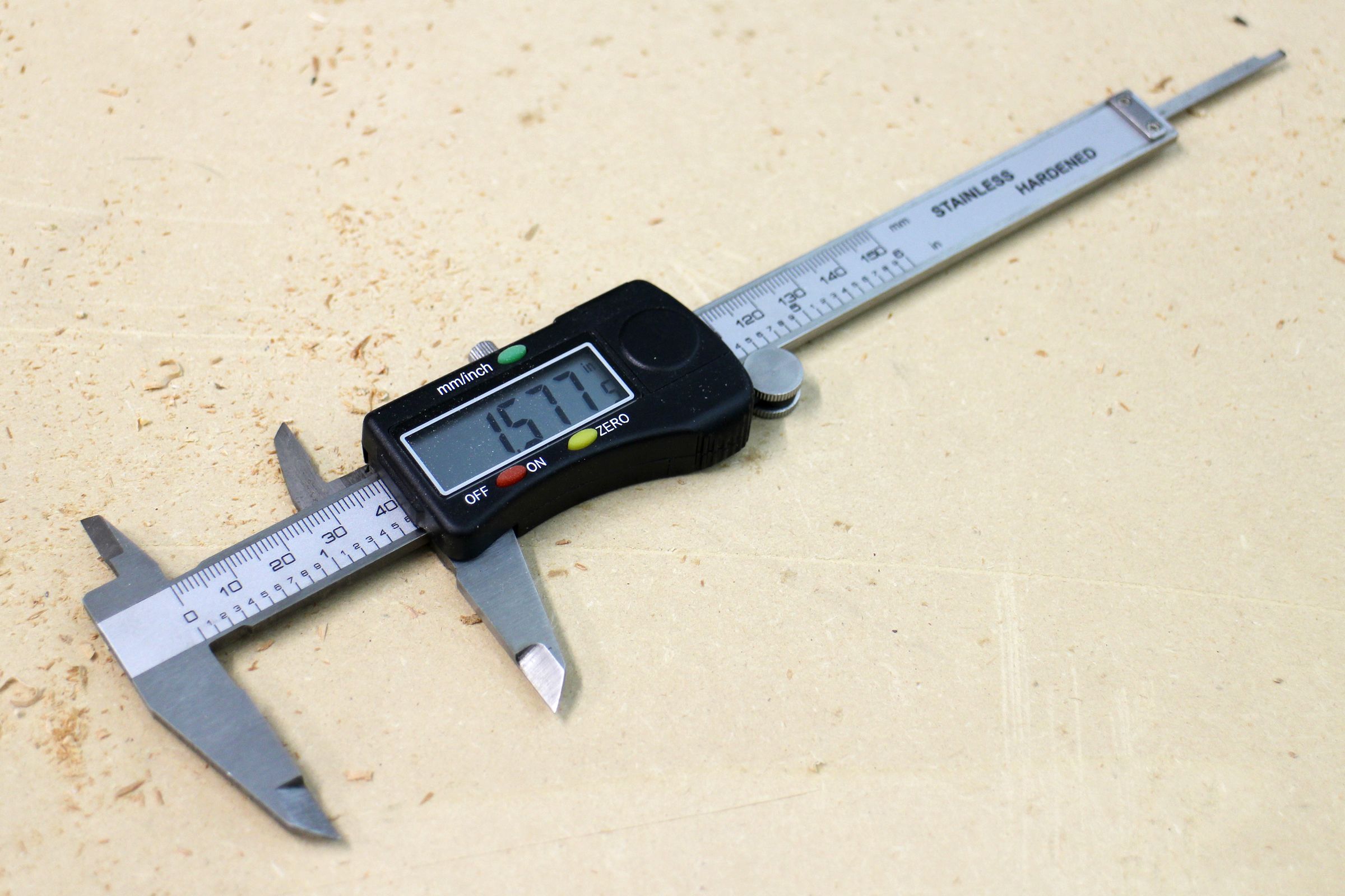

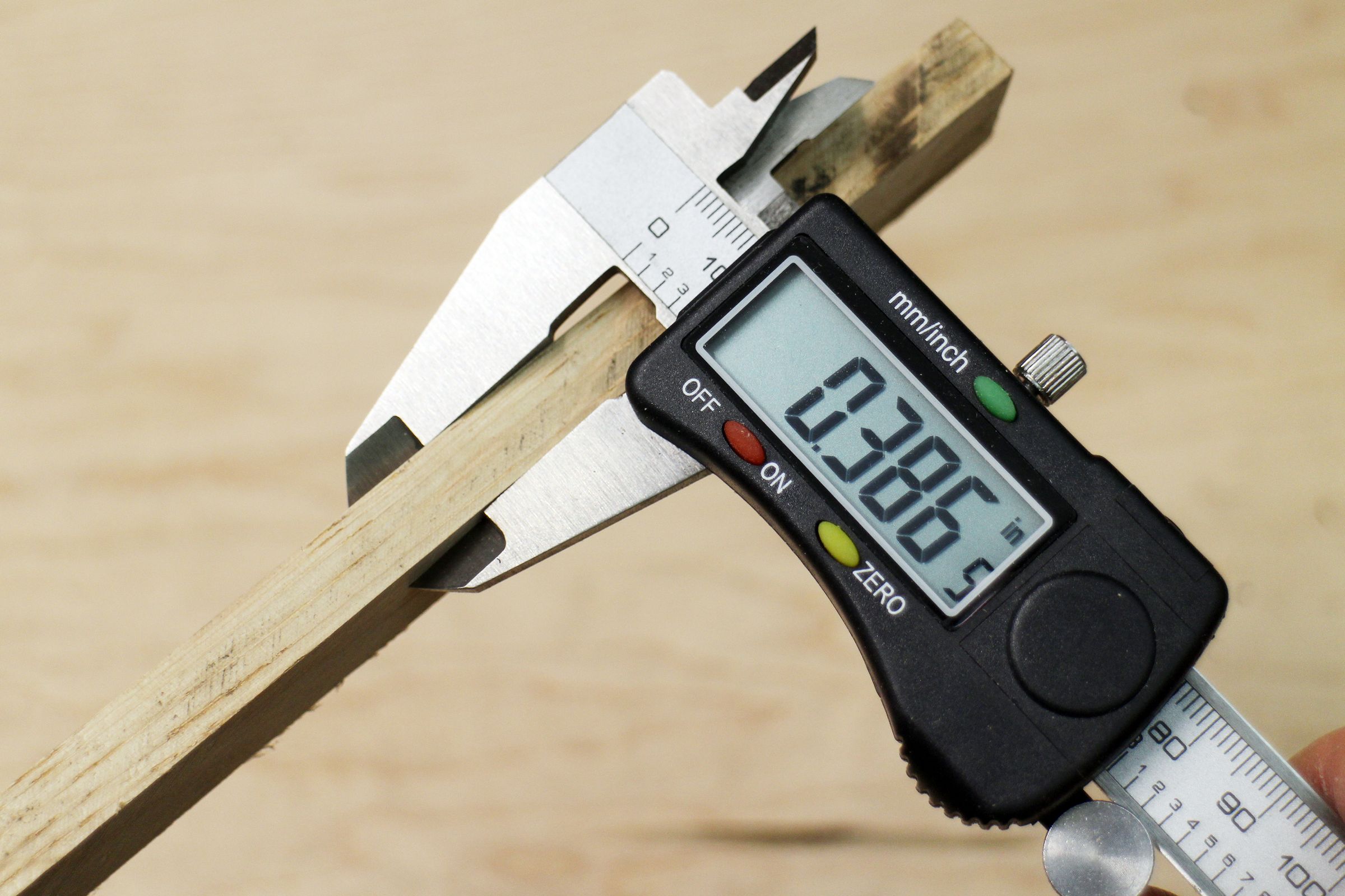

The calipers are essential to get an accurate measurement of your table saw mitre track. You'll also need a solid tri-square to align the sled fence to the blade, which is what will determine if your cuts are square or not.

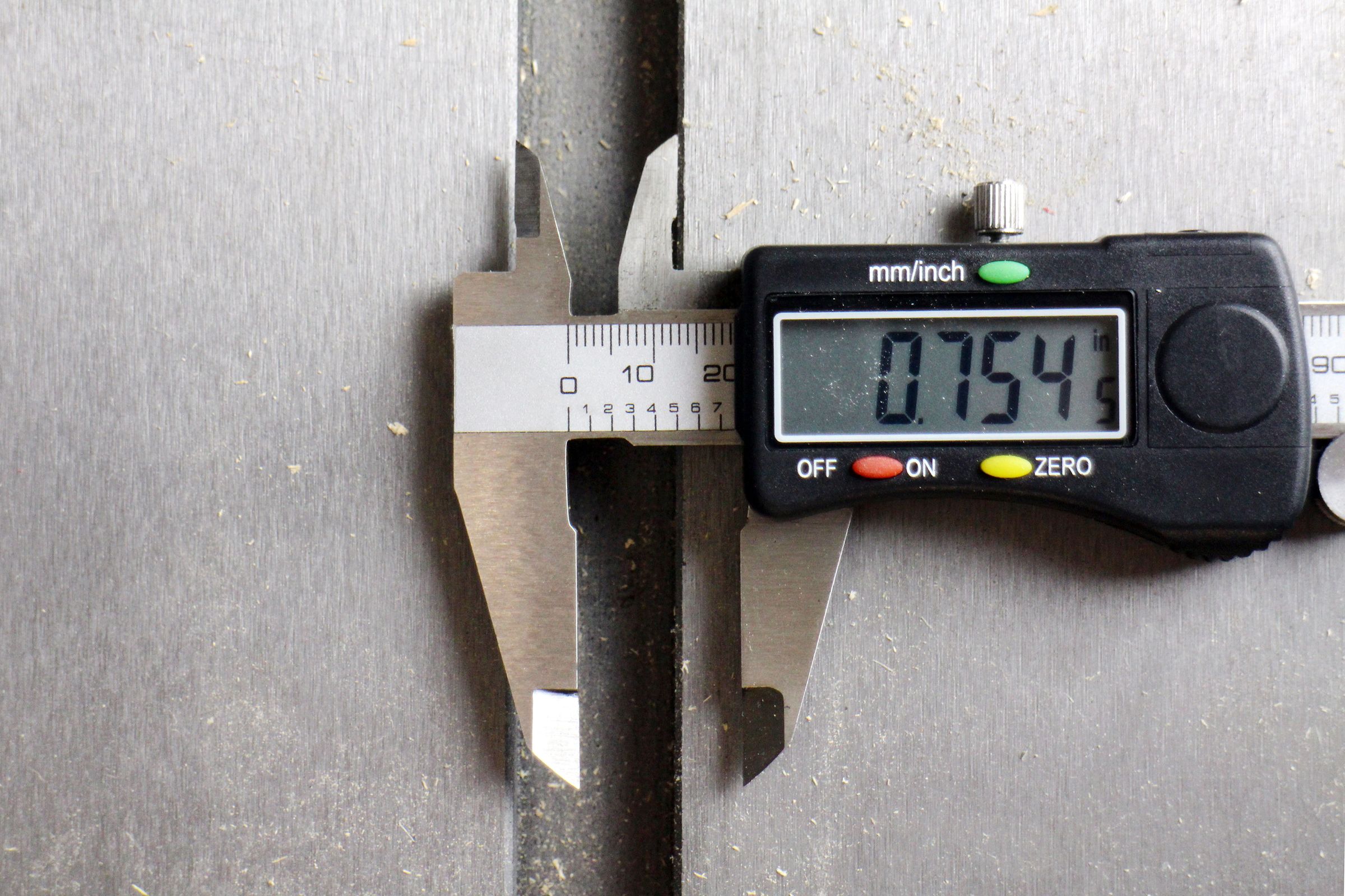

Step 2: Measure Mitre Track

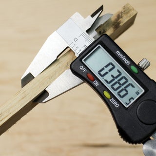

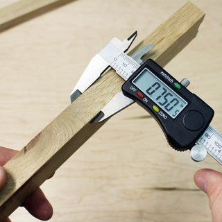

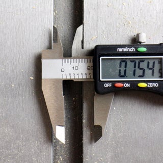

Almost all table saws have a standard mitre track dimension of 0.75" wide x 0.375" deep. Before making any cuts it's best to check to determine your mitre track dimensions.

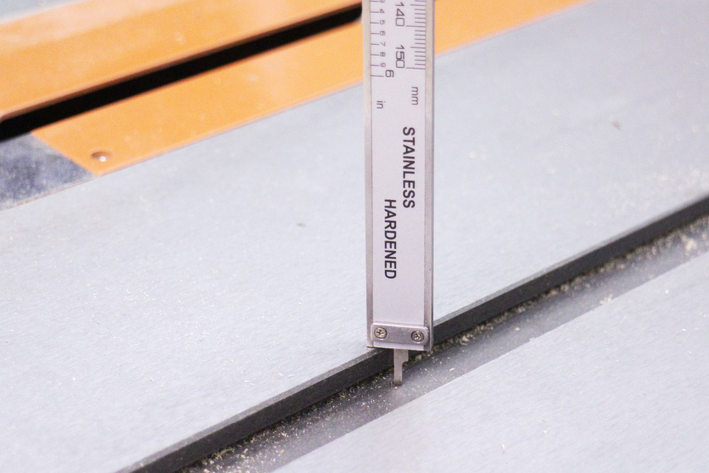

Digital calipers have 4 measurement points: exterior dimensions (the large jaws that go outside an item to be measured), interior dimensions (the smaller jaws that go inside an item to be measured - located above the larger jaws), depth gauge (a probe that extends out the end), and an exterior depth gauge (the hammerhead front of the calipers and the inside jaw of the moveable side - example).
Use the interior measure to check the width of your mitre track, and then use the depth gauge to see how deep the track is.

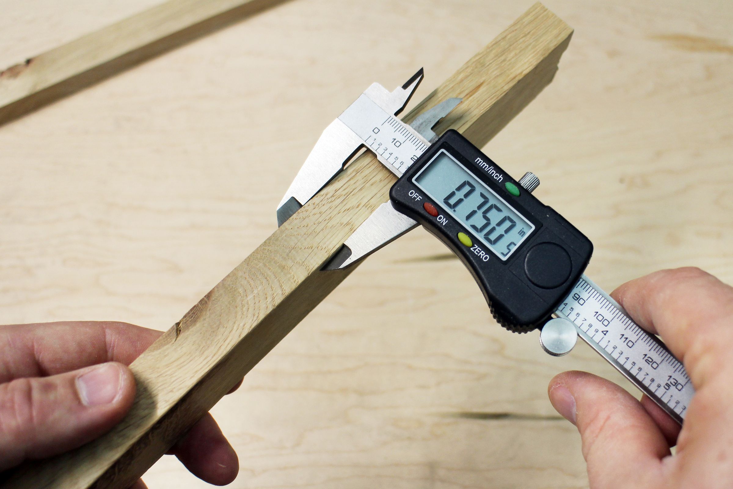

Step 3: Cut Track
Set the table saw fence to the track width dimension and make a rip cut on your straight hardwood scrap. Next, set the fence to the mitre depth and run the cut hardwood through again.
We're using a hardwood like oak here as it's a very dense and durable wood that's not prone to warping. Using this as our track will allow the sled to glide smooth and not get stuck in the mitre track.

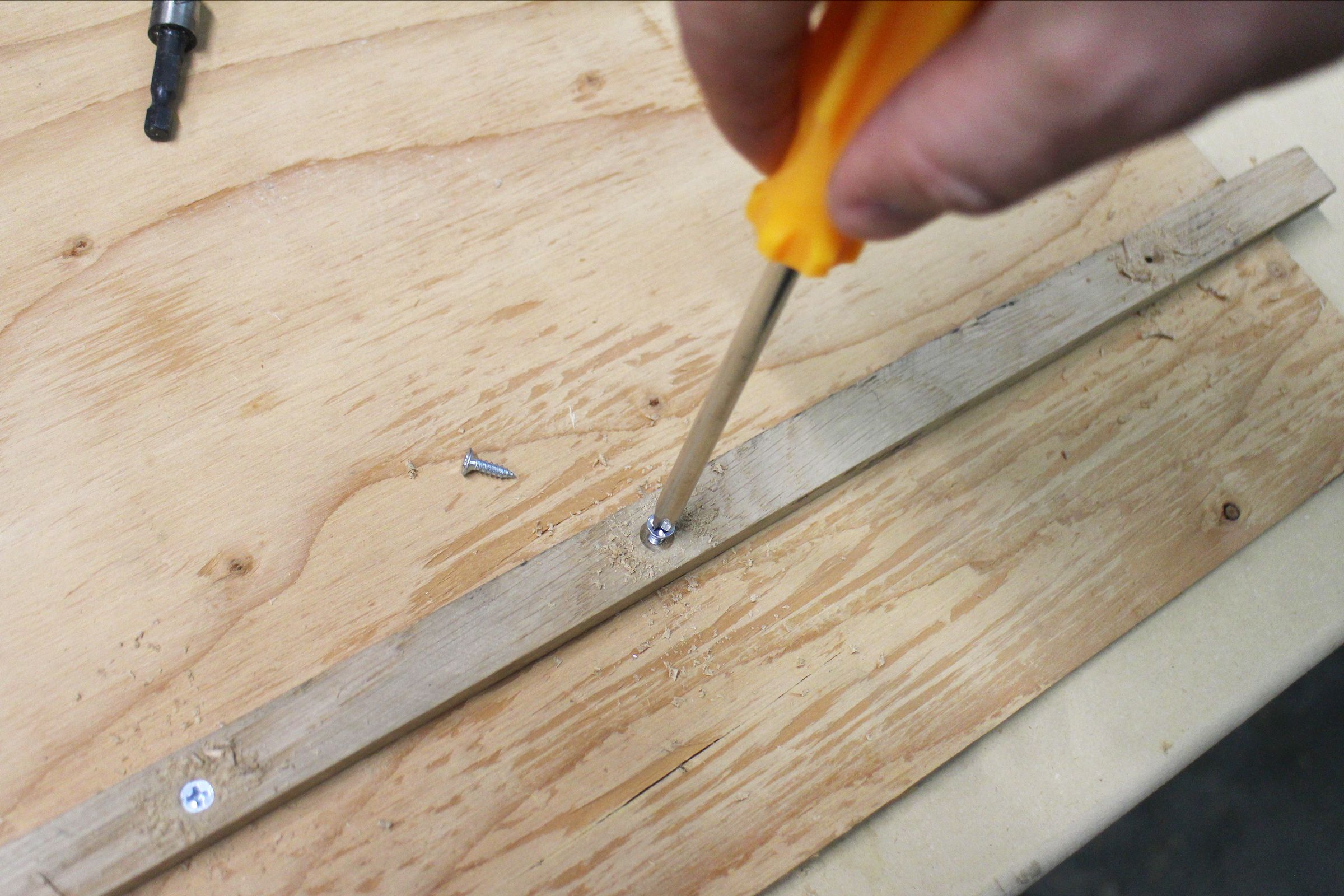

once the glue has dried slide the glued assembly out of the miter track and flip the plywood over.

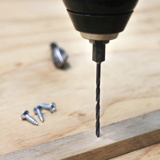

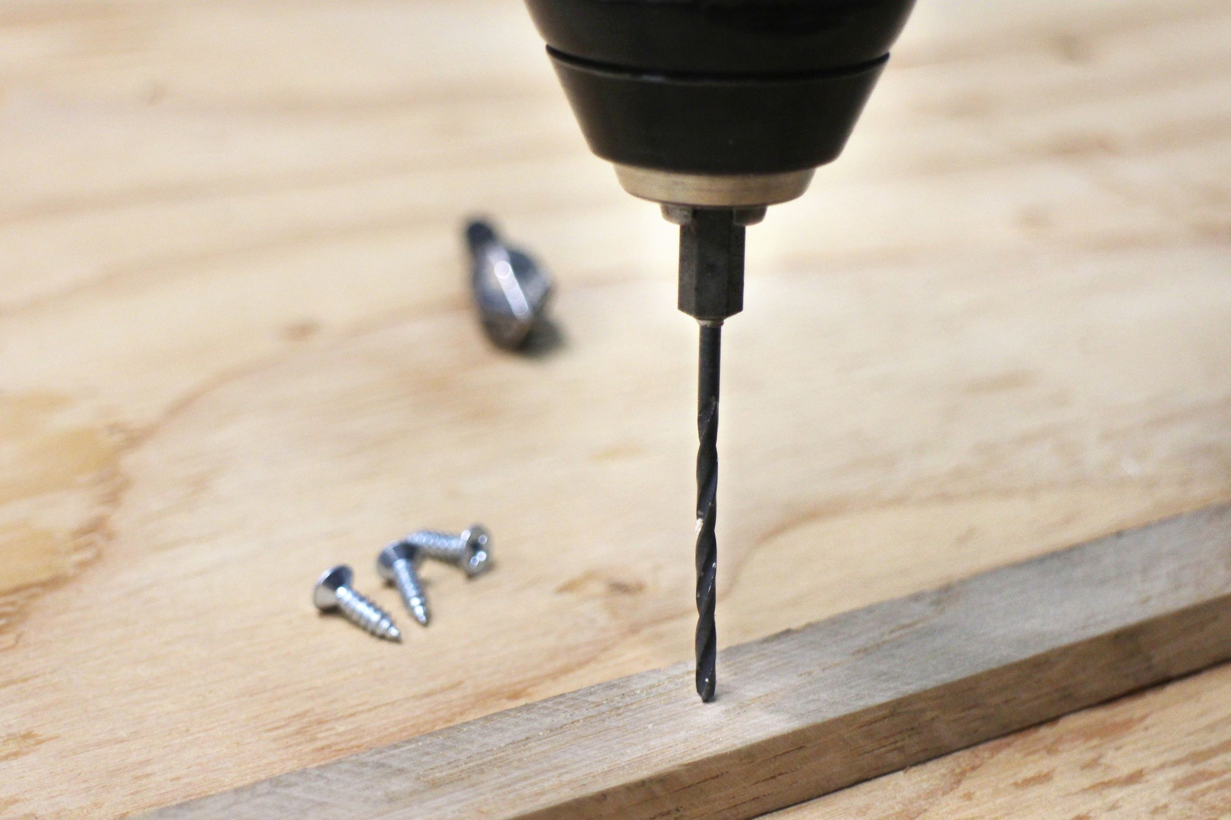

Drill pilot holes along the hardwood length and countersink each drilled opening. Hand screw fasteners in each opening to mechanically secure the hardwood to the plywood. The glue and screw combination will ensure the two parts are mated securely.
It's important to countersink the openings so the screw heads are inset from the hardwood track surface, thereby not hindering any movement when the sled is in the track.
Hand sand any burrs or rough spots from drilling.

Use the tri-square to ensure your wood choice is completely square and straight. Like the front fence, the back fence wood should be as long as your sled is wide.

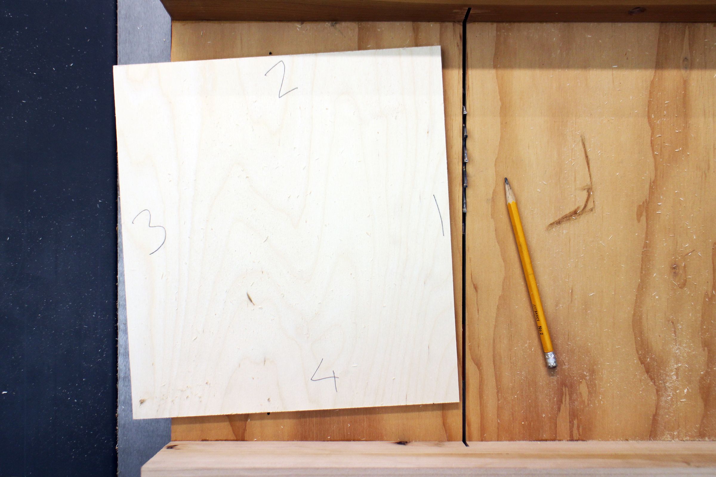

Step 14: Check Accuracy (5-cut Method)
To check the accuracy of the sled we'll use the 5-cut method, cutting a piece of scrap 5 times, rotating after each cut, to see the deviation from perpendicular.
By making multiple subsequent cuts on the same piece of wood, the resulting 5th cut will have magnified the error and show us our deviation.
Start with a rectangular scrap piece of wood and label each side 1-4 counterclockwise. This scrap piece doesn't need to be square to begin with, the 5-cut method can handle any scrap piece of any shape.
Place side 4 against the back fence and line side marked 1 with the saw blade, move the sled forward through the blade to make a cut along side 1 removing a small amount of material. Move the sled back and rotate the scrap piece clockwise so that side 1 is now against the fence and side 2 is lined up to be cut. Repeat this process for all 4 sides until you are back to side 1 at the saw blade.
After cutting all 4 sides make one final cut along side 1 again, this time make the cut of a decent size. The off-cut here will be the piece we measure to see the sled accuracy.

Use calipers to measure either end of the off-cut and write down the readings.
One end reads 0.512" and the other 0.575", a difference of 0.05" (50 thou) or 1.5mm. This is less than 1/16" compounded along 4 sides of my roughly 1'x1' scrap piece.
