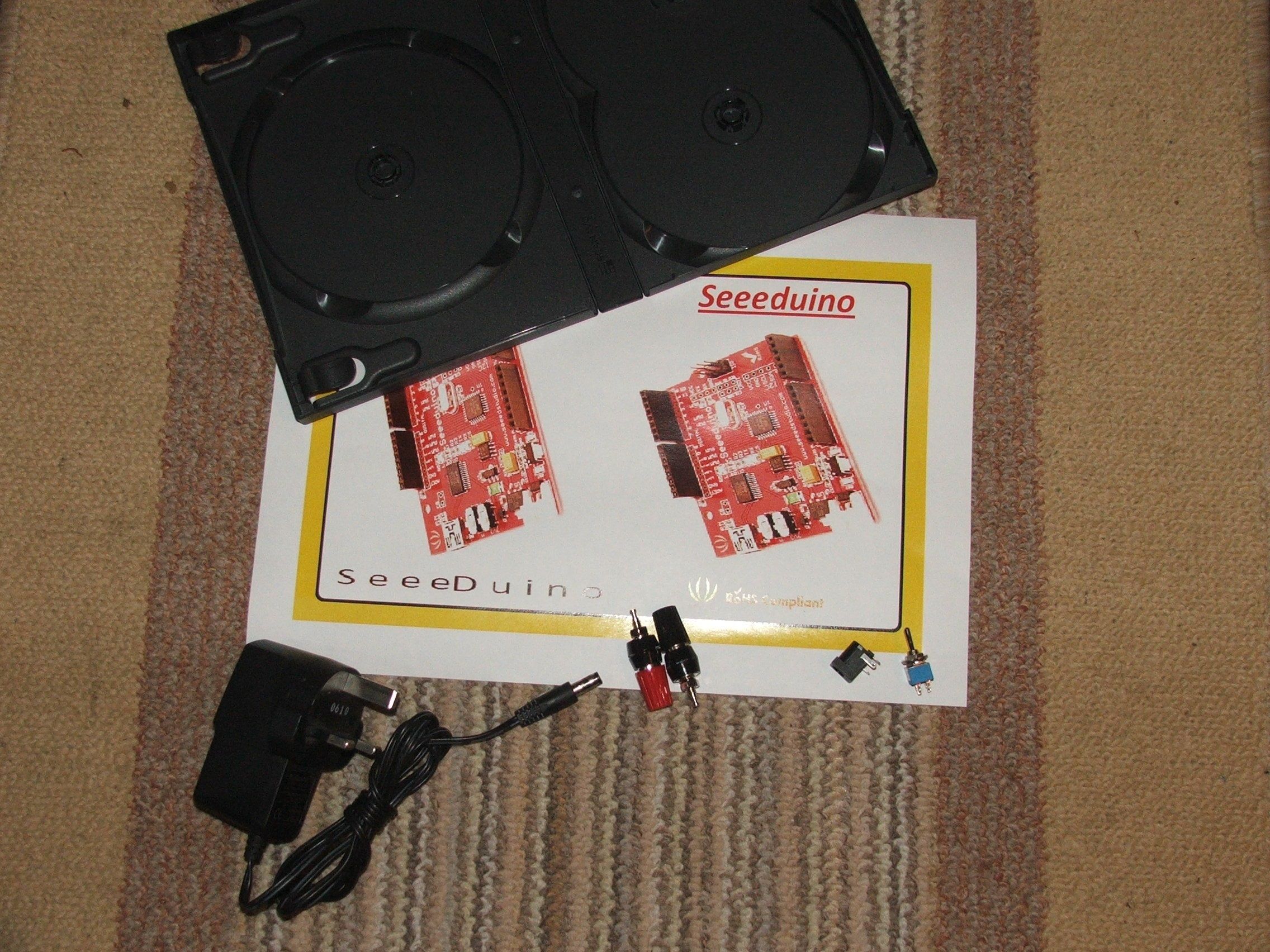

Step 1: Get the Bits Together
The box was from a local cheap shop, it cost about $60c
its solid and locks, and has space inside to pack away all of your bits when you have finished
The picture shows some of the bits i have added
