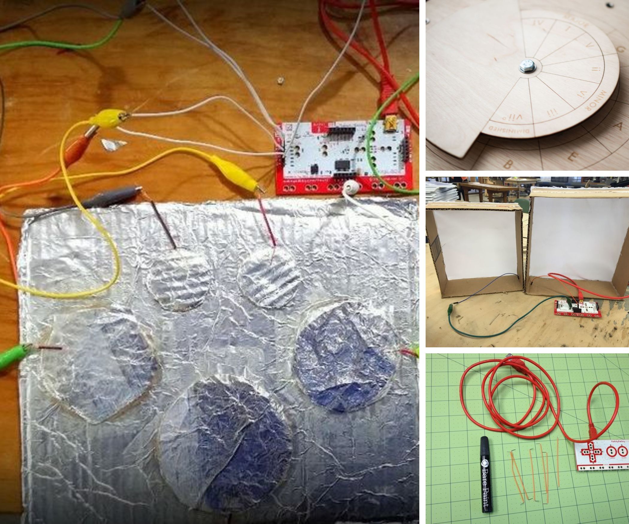

Step 5: MAKE CIRCUIT
Make a hole for LED, place led and tape the positive leg down to the aluminum with electrical tape.(Optional) I used Bare paint (Conductive Electrical Paint) to make sure the (+) leg was secure. I attached a short wire (about 2-4 in) to the other (-) leg of the LED. Use the electrical tape again to tape the wire to the batteries negative poll and the tong wire ( the longest wire) to the (+) side of the battery. Make sure the wires are making good contact with the battery. Scott tape the loose wires down against the aluminum.
(See diagram pictures for details)
Test your circuit, did the light come on?
Grab the wire for tong and touch it to the aluminum. If it didn't work check your circuit. Did you have the wires touching the right sides of the battery? Were all wires covered well with electrical tape?
Step 6: ADD TONG, GLUE BOX TOGETHER
Push the long wire (positive side) through the hole we made in the last step. Wrap the exposed copper around the metal clip so that it is attached. Test to see if the circuit completes.
Glue box against the seams to complete the main operation board. Test your circuit again, make sure it works after gluing.
