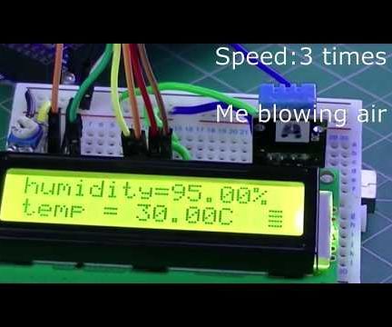

Whether you are a beginner in electronics or you need to make a fixed circuit you should first prototype it in a breadboard
A breadboard is a solderless device for temporary prototype with electronics and test circuit designs. Most electronic components in electronic circuits can be interconnected by inserting their leads or terminals into the holes and then making connections through wires where appropriate.
To use it you need some single strand wires,a stripper and the components to use (Capacitors, LEDs, Switches, Resistors, Coils, Relays, ICs, Transistors, diodes, etc
