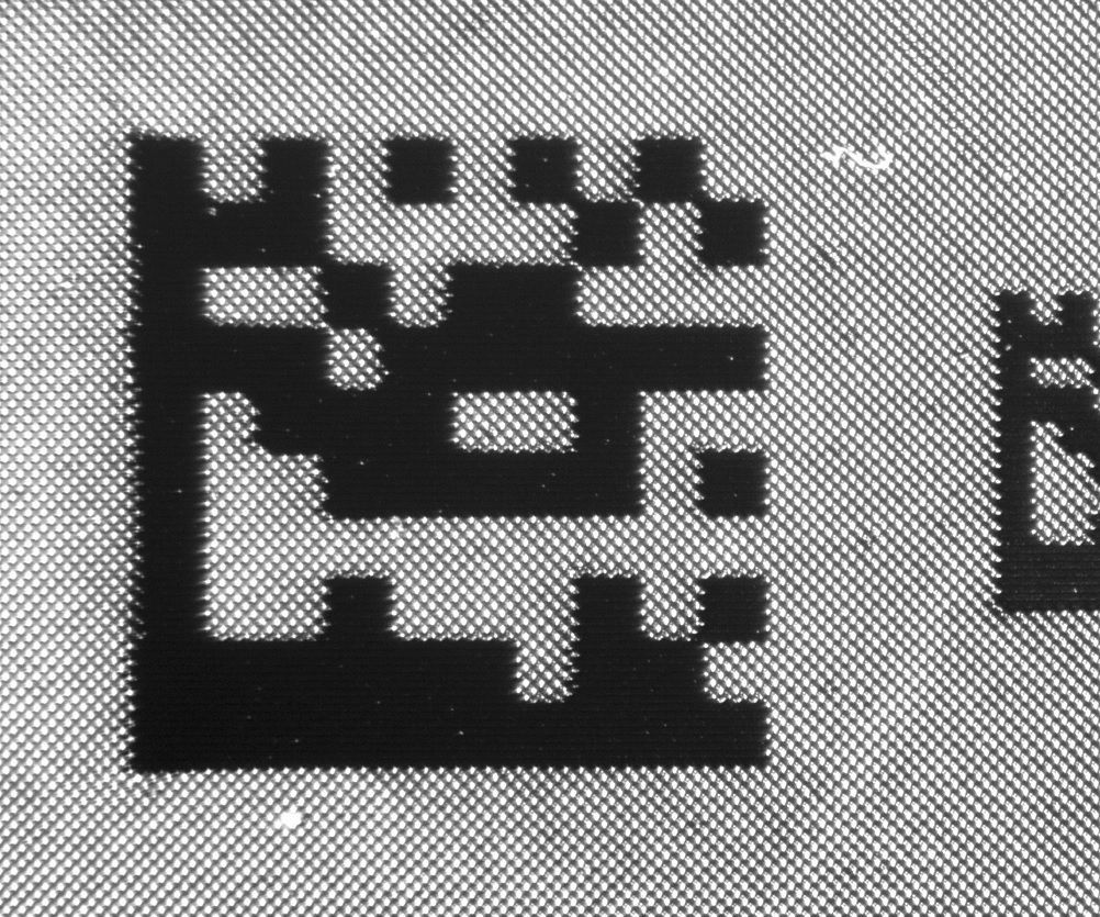

In order to bypass that processing and directly control individual micromirrors, the projector must instead be used in "pattern mode". In pattern mode, the intensity of each projected pixel depends only on the gray value of the corresponding individual pixel in the source image, regardless of the location of that pixel. Because of that, parts printed in pattern mode can reproduce finer details than parts printed in video mode. For example, this Instructable shows how to use pattern mode to print very small bar codes, and this one shows how to see the growth of a single printed voxel.

To get a quick view of the greater detail achievable in pattern mode vs. video mode, you can print the two attached.zip files in PR57K resin. They contain a test pattern that's similar to the one used in the Instructable on measuring Ember's horizontal resolution. In this case the pattern consists entirely of single-pixel wide lines, in horizontal, vertical, and diagonal directions, as well as a single-pixel checkerboard.
Notice that the print from "video test pat.zip" shows the aliasing artifacts (beat frequencies or moiré patterns) described in Karl Guttag's article, while those are absent from the print of "pattern test pat.zip". In fact you can only see the individual lines within the pattern mode print under higher magnification. That same magnification reveals the variations in the way they're printed in video mode, depending on their location within the build area.
