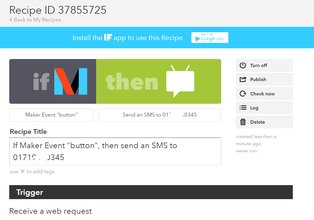

Step 5: Making IFTTT Channel
If you’re not using IFTTT (If This Then That), you’re seriously missing out. If This Then That allows you to combine different services with your own custom logic. Channels are the fundamental building blocks of IFTTT. They represent web services that provide data sources or even physical devices like fitness wearables.
The Maker Channel allows you to connect IFTTT to your personal DIY projects. With Maker, you can connect a Recipe to any device or service that can make or receive a web request.
I will use Maker Channel to receive a GET request from ESP8266 Module when triggered by ATmega chip. Maker Channel then send a SMS to a predefined number using SMS Channel. So, let's explain how to work with IFTTT.

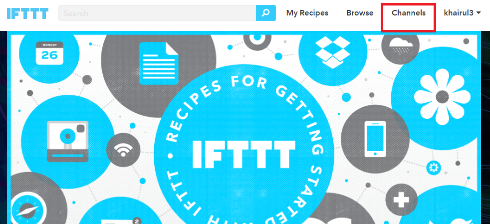

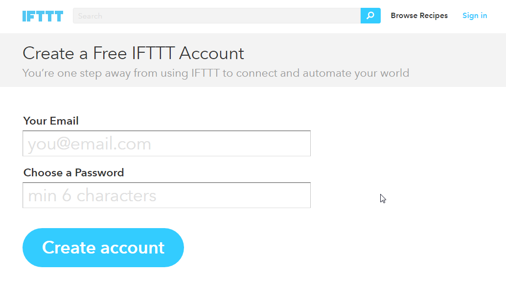

1. If you don't have one already, create an account on www.IFTTT.com.
2. After sign in click to Channels to create a channel

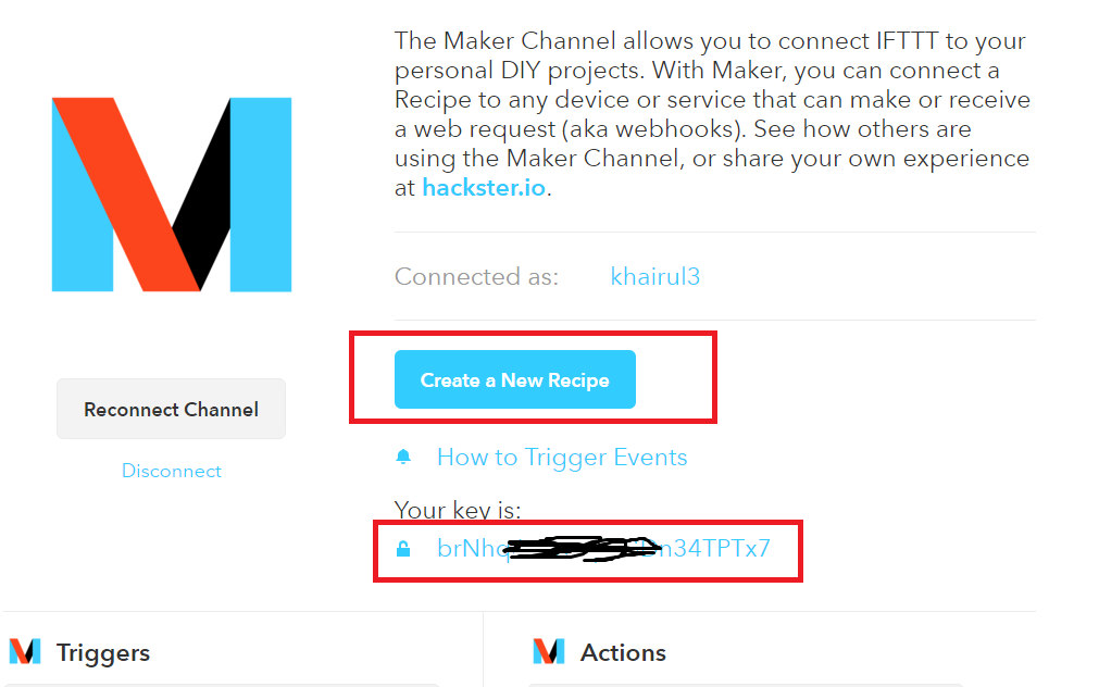

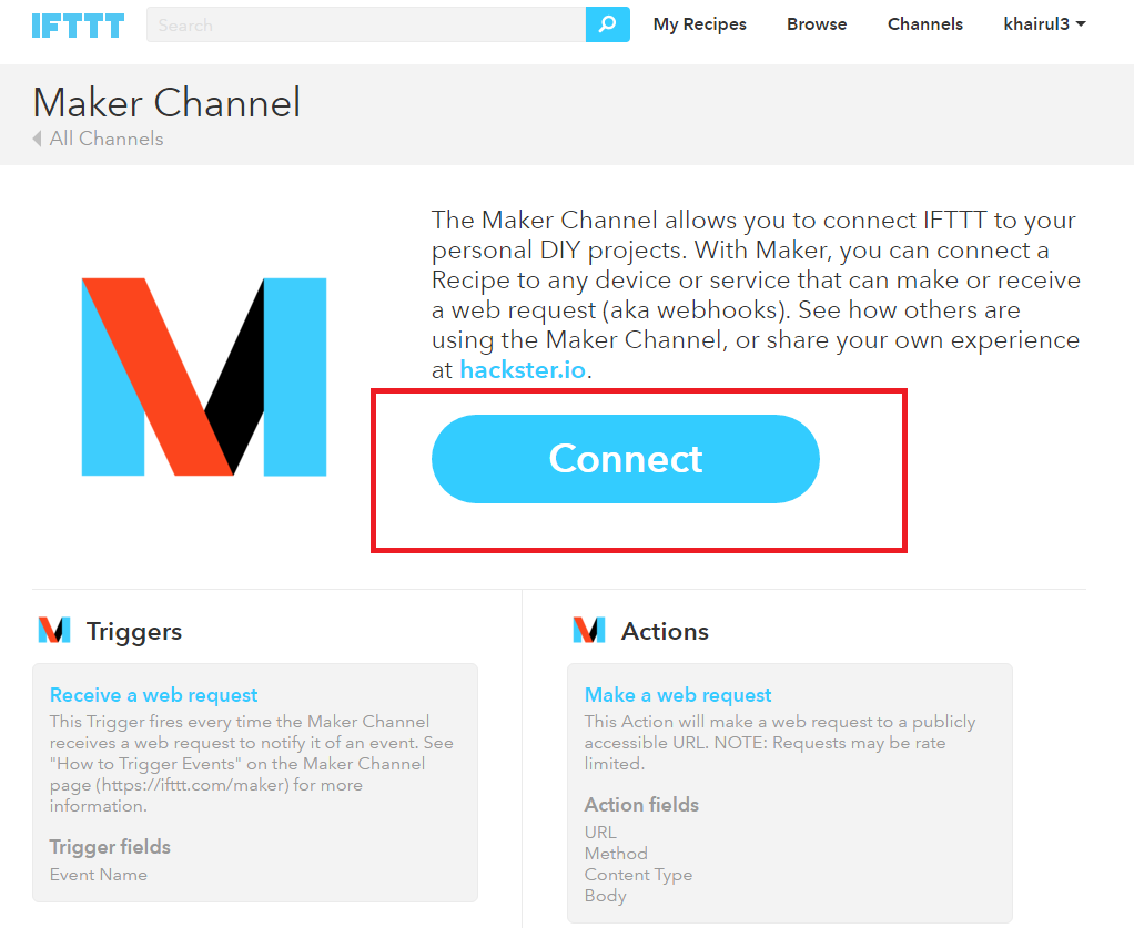

3. Select Maker from DIY Electronics
4. Click to Connect button

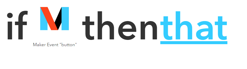

5. Note your key, it will be required at the time of programming the ESP8266 module. Then click to Create a New Recipe.

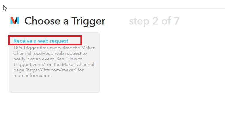

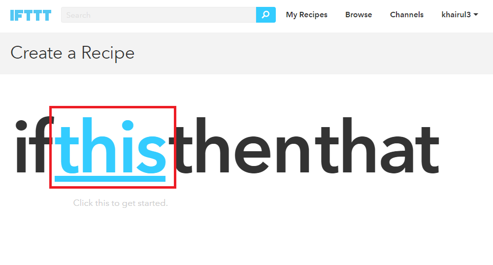

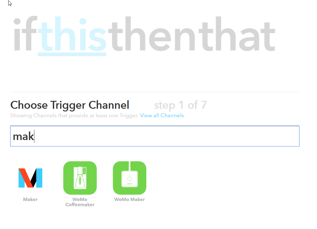

6. Click on this
7. Choose Maker as Trigger Channel

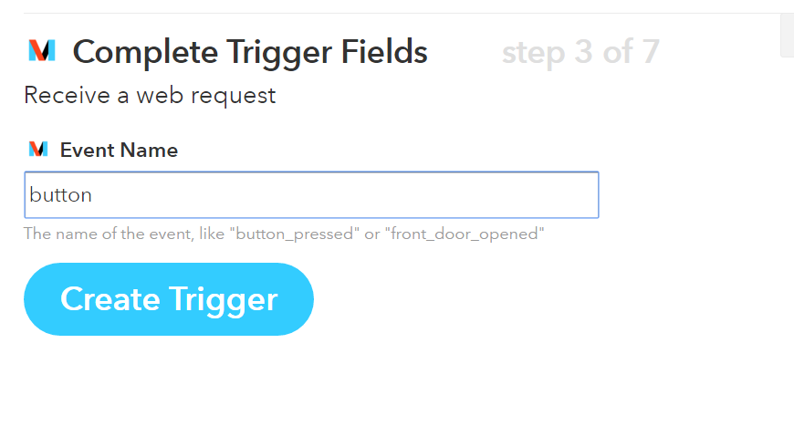

8. Choose Receive a web request
9. Make an event name, I used 'button'. Event name is important and you have to use same name in the program.
10. Then click to that

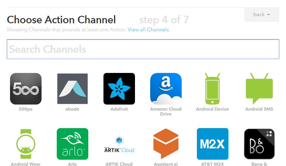

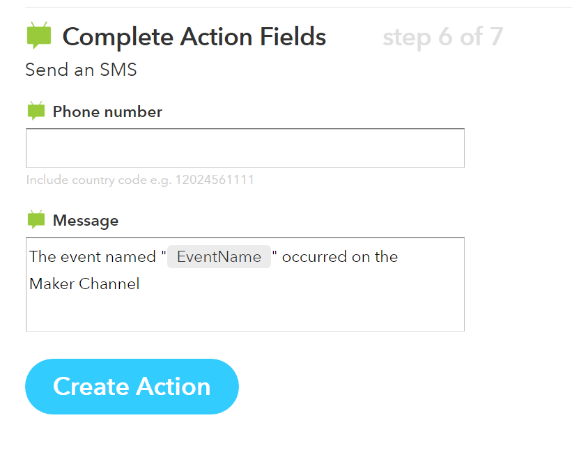

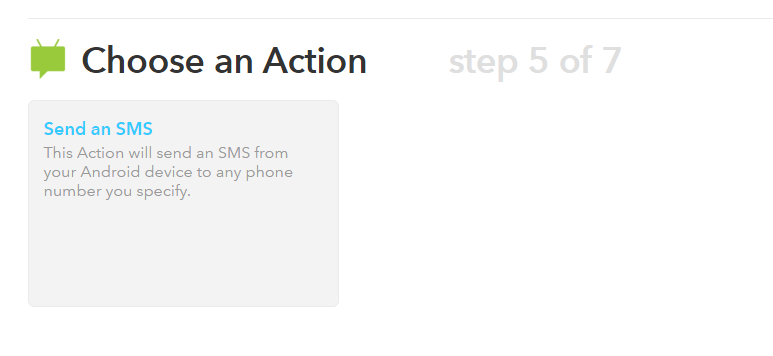

11. Choose Android SMS as Action Channel
12. Click Send an SMS as an Action

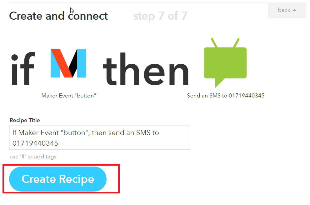

13. Enter a phone number to which you want to get the SMS
14. Finally, click to Create Recipe
15. You will see the following response with Recipe ID.
Congratulation! You successfully created your IFTTT Channel & Recipe.
