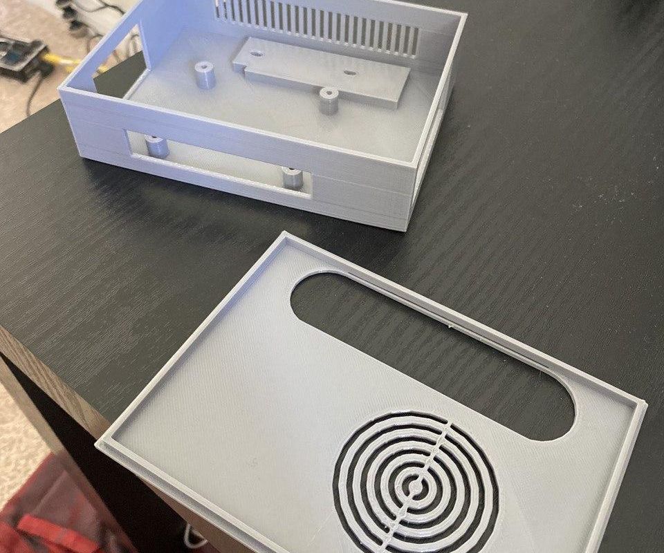

To test with a real object, I wanted to improve the printer itself with custom made components. There is a big community out there who designs detailed parts for these purposes. I found this cable chain online, and I thought that it could be a good addition to the printer since the power cables looked too exposed. I downloaded the model, placed some of its components in Cura software to see how long it takes. It turns out printing the whole thing takes ~20 hours and uses more material than I currently have (I couldn't find exactly how much sample material came with the box, but a simple kitchen scale showed around 60grams after my initial bed leveling test). I decided to print a subset of components and laid 15 of the joints on a plane. I set up the nozzle temperature to 205, and bed to 60 degrees. 6-6.5 hours later I had the cable chain ready. Simply rolling the bed cover around a table edge loosened all the parts and they didn't leave any marks. The parts feel fragile but they do latch onto themselves strongly.
