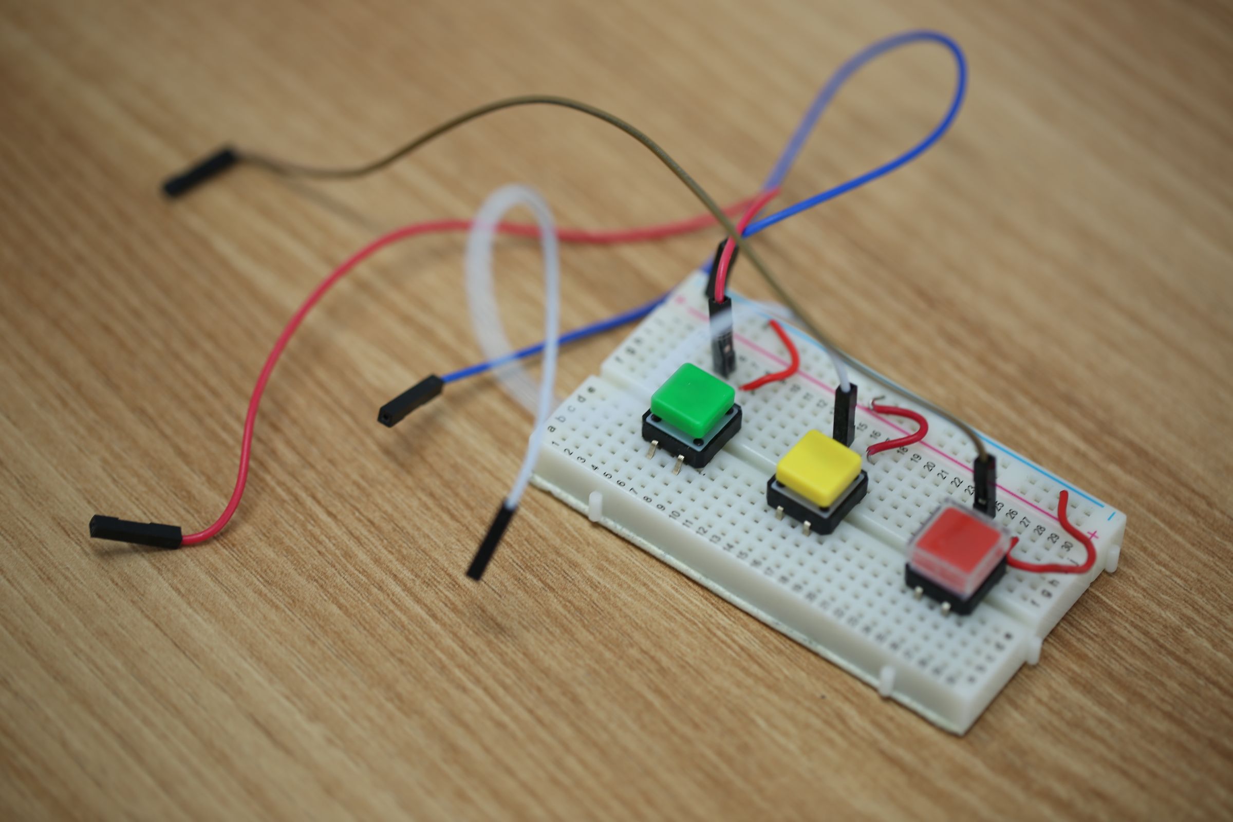

Step 3: CREATE YOUR SMART BUTTONS ON YOUR BREADBOARD AND CONNECT TO PROTA PI
A breadboard is a board that helps you connect electronic components together and to your micro-computer Raspberry Pi. A small breadboard can be enough for this project (the GIF above were taken from the DIY Jukebox project with a bigger one.
First, let’s install the buttons on your breadboard. Separate each button enough. And connect hook-up wire between one of the leg of the button and the minus (-) line. That will allow us to use only one jumper wire for ground connection.
See GIF above
Now connect a jumper wire next to the other leg of each button (it must be on the same line number). This will make the data connection between your Raspberry Pi and the button to transform the physical push on the digital interface.
See 2nd GIF above

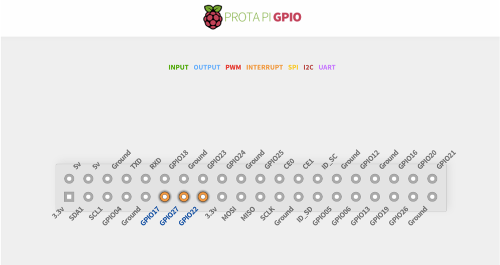

Now it’s time to connect those wires to the GPIO pins of your Raspberry Pi. Connect the wire in the ground line to a ground pin. Then connect each button jumper wire to GPIO pins, following the map below. For instance we chose here to connect with GPIO17, GPIO27, GPIO22.
Basically you can connect to any green pin on this map.

- Go to App Libraries and download GPIO app
- Open GPIO app
- Click on GPIO 17 and set it to Interrupt // Pull up
- Click on “Set”
Now when you press your button, it should display on your GPIO interface (as below) “Rising interrupt” and “Falling interrupt”.
This means your Prota Pi reads the action of pressing the button. Now you can do the same thing with GPIO27 and GPIO22. Make sure all dots are lighten up like below, meaning all pins are set up.
Test each button to see if you do have for each the message “rising interrupt” / “falling interrupt”, which confirms the connection is working fine.

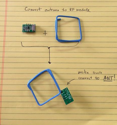

You need two things for this step: RF sockets and an RF transceiver module with an antenna.
The latter will communicate via radio frequency with your RF sockets to turn them on and off. It’s a very economical way to connect devices/appliances that can be triggered by just being connected to a power supply (like lights and TV).
For RF Sockets: currently our OS supports 433, 477 and 315 MHZ sockets. We recommend you to use WattsClever, DX or Etekcity. The following brands are not working properly: Westfalia, Energenie, DiO, JTD.

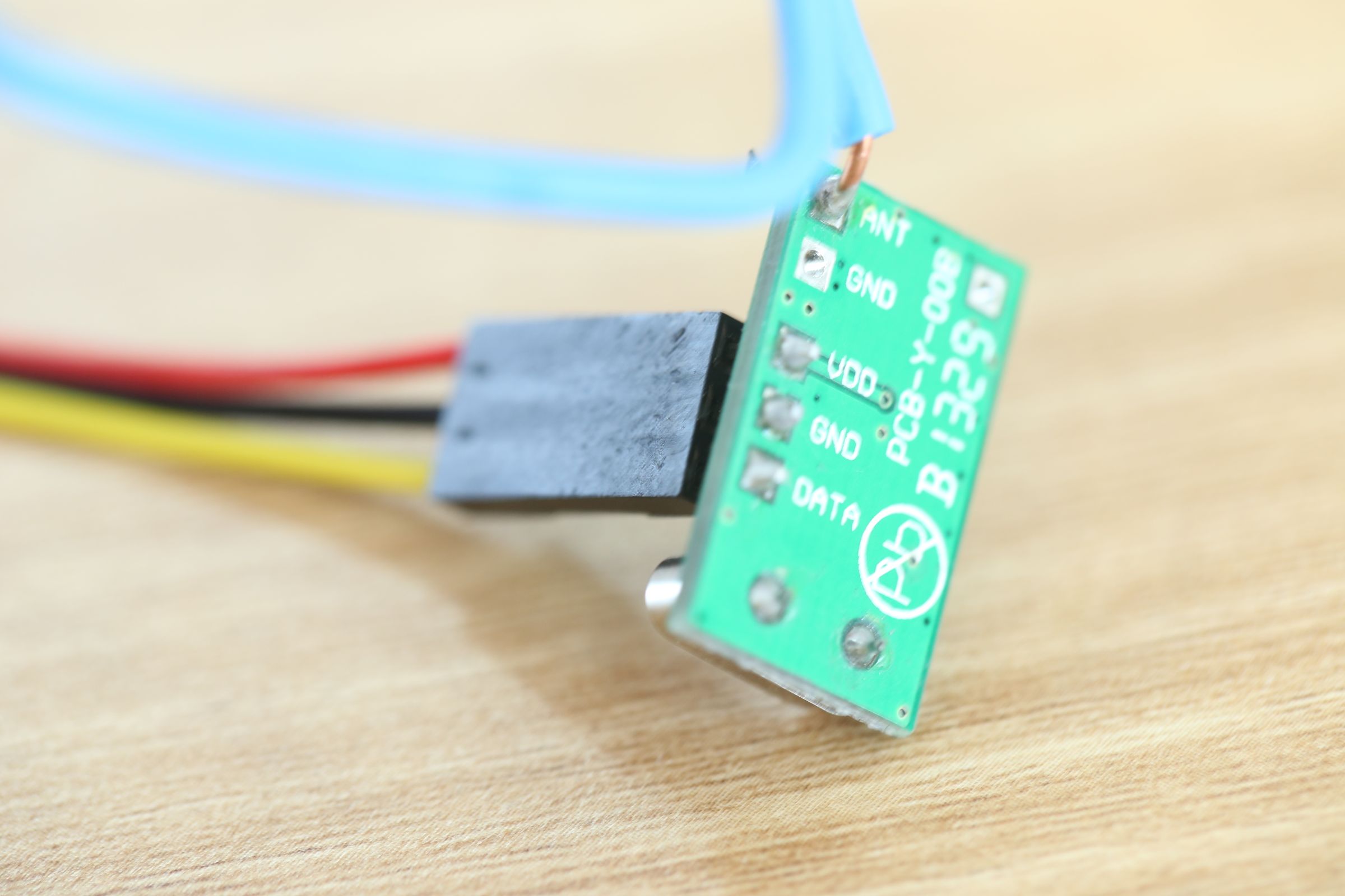

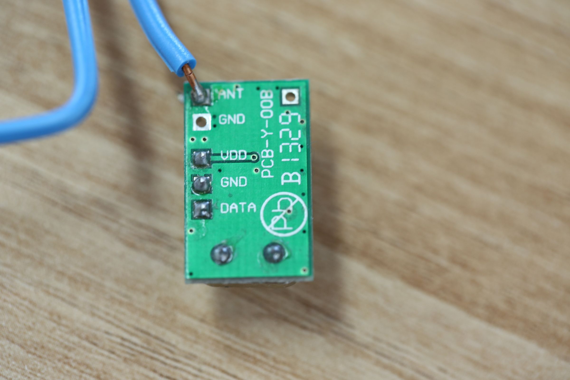

You need to solder the RF transceiver and home-made antenna together. Make sure the soldering connects the antenna to the ANT port on the RF transceiver.
You can have more information on how to make an external antenna in this article.
Keep in mind that the required length of your antenna will depend on the frequency of your RF socket. Our OS supports 433, 477 and 315 MHZ.

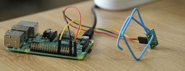

Once soldering is done, plug three jumper wires to your RF transceiver (433/477/315 MHZ).
VDD = Electric current (5V)
GND = ground (select a ground PIN)
DATA = has to be connected to GPIO23
You can connect those three jumper wires as we did on PIN 2 (5V), PIN 6 (GND) and PIN 16 (GPIO 23).

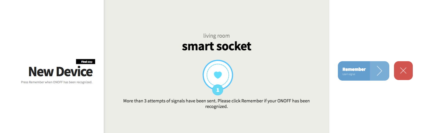

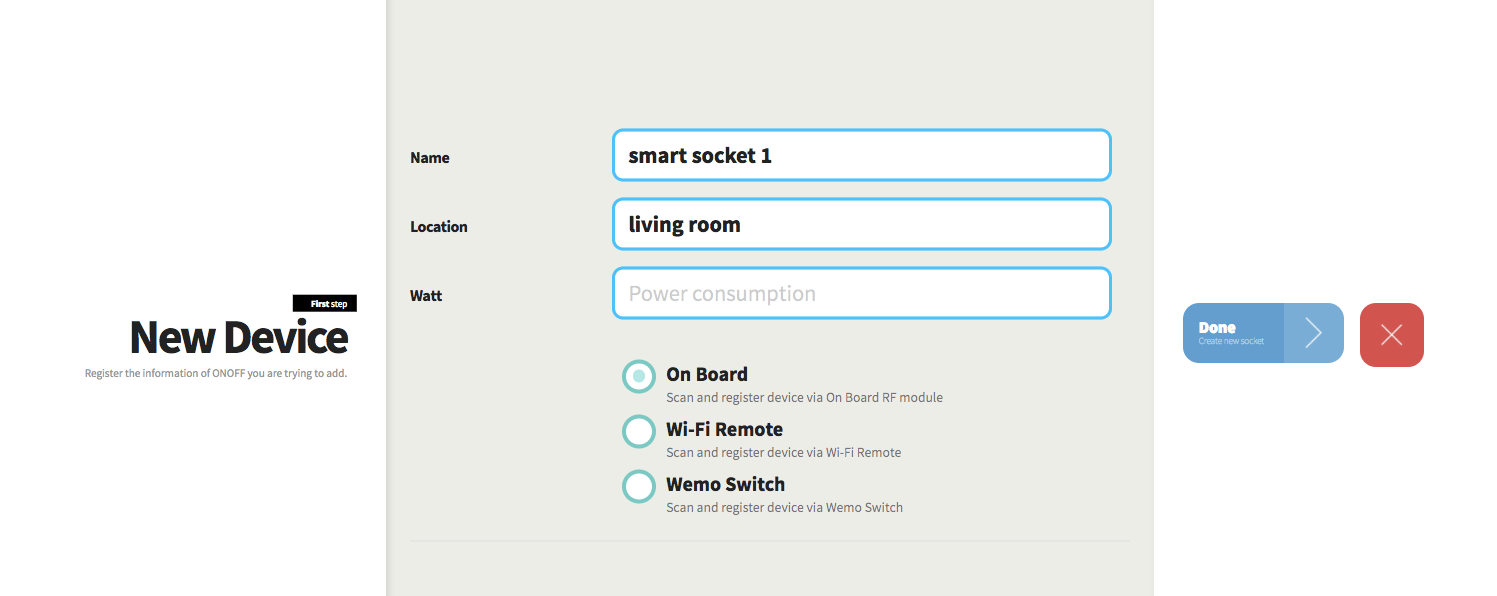

- Open App Libraries and download ON/OFF app
- Click on “Add socket”
- Type-in the details, select “On Board” and click on “Done”
- The app will start scanning the surrounding sockets. Press and hold on the socket’s button until the LED blinks
- When the LED stops blinking and stays on solid red, it means your Prota Pi has paired with your socket. You can then press on “Remember”
You can now try turning it on and off via the app interface.
Do the same for your other two sockets.

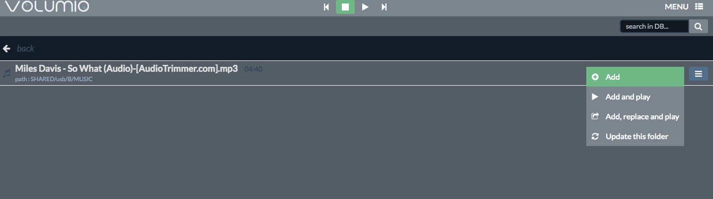

- To use Volumio, follow those simple steps:
- Plug a USB stick with your favorite music in one of the USB port of your Prota Pi
- Go to App Libraries and download Volumio app Open Volumio
- Click on the bottom left button “Browse”
- There you will be able to select the songs you want to play. Go to Shared, select your storage device, click on right side icon and add them to your playlist.
Now that your speakers are connected, you will be able to link them to your buttons so that the music is triggered or turned off when you press on one of them.

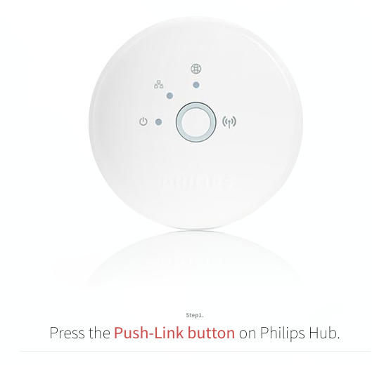

Step 7: CONNECT YOUR PHILIPS HUE BULB TO YOUR PROTA PI
You can connect Philips Hue light bulbs to your Prota Pi to add some nice light effects when pressing your 3rd button (“Relax Time”).
To do so:
- Go to App Libraries and download the Philips Hue app
- Open the Philips Hue app. You will be requested yo press on the Push-link button of your Philips Hue bulb. As soon as you do that, the lights paired to your Hue hub will be integrated to your Prota Pi Hue app.
Make sure your bulbs have been paired with your Hue hub beforehand. You can follow this guide to better understand how to use and pair Hue bulbs with Prota Pi.
Now that it’s paired, you can directly control your Hue bulbs through the app interface. We will now be able to integrate those bulbs in automation workflows, so that when pressing the button the light turns on on a dim light.

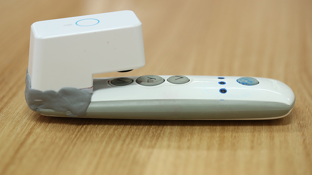

Step 8: OPTIONAL - CONNECT YOUR BLINDERS WITH MICROBOT PUSH
MicroBot Push is a small device that presses buttons for you, which is a practical way to connect appliances at home. If you do not have connected blinders at home, you can place a MicroBot Push on the blinders remote to connect them. That way, pressing the button dedicated to notifying your house you are back home will also open the blinders for you.
First, you need to pair the MicroBot Push to your Prota Pi.
- Turn on your MicroBot (the switch is on the back)
- Access your Prota Space and go to the homescreen
- Click on the “Pair now” button and follow the instructions to pair the MicroBot
Once this is done, install the MicroBot Push on your blinders’ remote control.
Here we used some Sugru to fix it.
When the MicroBot Push is remotely triggered, it will press on the up button of your remote control.
