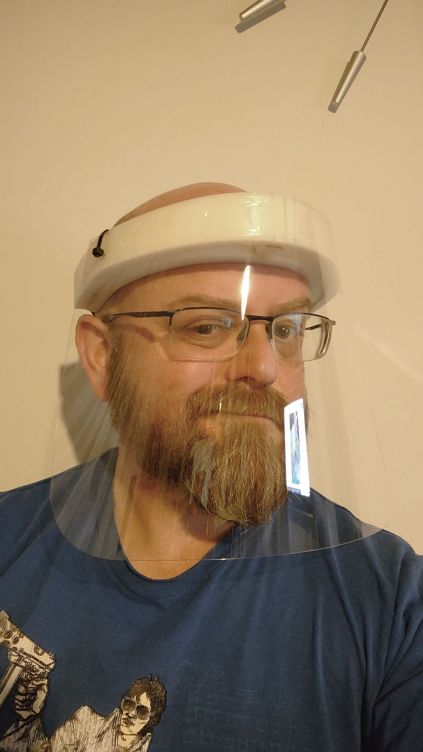

Step 7: Preparing the Visor
For then next part you will need a crystal clear A4 sheet of plastic. for the face shield I have made so far I have managed to source 250 micron acetate and 0.5mm poly copolyester also known as PETG. The photo references for this build is the PETG version. The PEGT comes with an added protective film on both sides but I prefer working with the acetate for speed and lightness. In the end as I am receiving donations it really does not matter so long as the conclusion is right.
- First mark a line along one of the long edges 30mm in.
- Gently run your sharp knife along this marked line, just cutting into the film but not the plastic (some plastics will not have a film so ignore this). this line will be where the visor attaches to the peak
- Peel off the 30mm strip.
- Mark a point 20mm and 20mm in form the side on visor edge, on boths sides.
- Punch holes at these points with the hole punch.
- On the opposite edge mark a curved edge on both sides and cut along this line with a pair of scissors or a sharp knife.
EDIT:
If you do not own a hole punch, then you could bind or clamp between a couple of pieces of sheet material such as PLYwood and drill through with your drill set to a low torque.
A further option and I think better option I have been working on, is to do away with the double sided tape (step 8) and place four holes along the top of the visor plastic.See image last image in this step for hole positioning. Another idea for hole making is to use a ring binder style hole punch, one punch for both holes on either side. I will try and fine my punch and upload a photo.
Step 8: Final Assembly.
- Place your peak on a the head block.
- Pinch in the elastic so the peak and headband fit snug around the circumference of the head and pin in place with a safety pin. The length of elastic should be large enough to fit most heads, even fitting over other headwear and then the safety pin can be used to shorten the elastic to the desired hatsize of the wearer. If you know the hat size of the intended wearer you could always cut the elastic to fit before gluing into place.
- Mark a center point on the top edge of the visor. I have used a srtip of A4 paper folded in two.
- Use the same folded strip of paper, match up with the center line on the front of the peak that you drew during Step 2 to mark lines on the peak front piece at each end of the the paper strip. (I'll take better photos of this process when I make my next batch). It is between these two points on the front of the peak the double sided stick tape will go.
- The reason this is marked now rather than the mark out stage is because the glueing stage can produce a few inaccuracies. If the double sided tape is too long this will not only look messy but will be messy, sticking to hair etc.
- Cut and stick a length of double sided tape between the two side mark points across the center front of the peak. before you peel off the tapes protective paper, give it a bit of pressure with your fingers to make sure is is firmly stuck down. (Again I will add more and concise photos of this process after may next build)
- Now remove the double sided tapes protective paper and carefully match up the visor to the the front of the peak
- Apply finger pressure to make sure the connection between the visor and the peak is strong.
- Next, with your pointy tool, pop a hole at the place of the two holes you punched in the visor but only pierce through the other strip of foam.
- Feed a cable/zip tie through the hole and close it over the top and around the first strip of the peak. Do not over tighten as this will tear through the foam. (Once again, I will take better photos of this process on the next build)
I have found through trial that the cable tie prevents the plastic from wanting to pop away. I am looking at other types of fastener such as nylon rivet, maybe even completely replacing the need for the double sided tape. If anyone has any success then please let me know. - Snip off the excess cable/zip tie.

EDIT
My new preferred method of attaching the visor to the peak is to just use four Cable/zip ties doing away for the need of double sided tape. This method would make it easier to clean or replace the visor is maintenance is needed.
Please so the new four tie MkIII visor image in this steps photos
