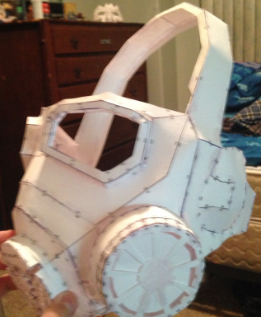

Step 1: Pepakura and Putting Things Together
Now open hugh´s pdo with pepakura viewer and print the pages, but before you print them all, test print 1 page if the lines or numbers are not on the paper then troubleshooting and instructions i suggest using this handy guide by Krsiak https://www.instructables.com/id/How-to-use-Pepakura-Viewer/?ALLSTEPS .
Now if you have printed all the pages. keep the pepakura viewer open it will help alot when trying to see where what part belongs. I started doing my piece from page 21, just cut the pieces and look for the numbers on the other pieces same numbers always go together. Use superglue to glue parts together. Continue doing this with all the pages. remember to check that the helm part is your size if it does not fit just take some part off or make paper carton pieces to fit inbetween the parts. When making the side piece with the flashlights you will have to modify the paper piece to make lights fit inside. If you want to have the flashlight thing removable put a magnet on the side of the helmet.
Tip : make some holes on the circular part in front of the mask it will help you breathe.
