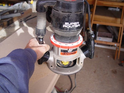

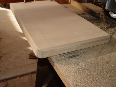

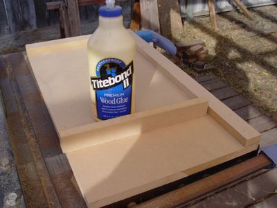

Step 1: Constructing the Wood Core.
The wood core of the counter top is made using 3/4" Medium Density Fiberboard (MDF). Cut the top to the shape and size you need and then cut strips of MDF 1 ½” wide to go around the perimeter edge of the top. This will make the finished top look like it is 1 ½" thick. Apply a good grade of carpenters wood glue, such as Titebond II, to the edge pieces. Position the edge pieces and nail or screw them in place.
If you have exposed corners on your counter top, cut them at a 45 degree angle. Then sand the corner into a smooth curve. It will speed the sanding if you use some sort of electric or air sander such as the orbital air sander used for this project. But it can be done by hand if necessary.
The top edge of the counter can remain square or you can give it a gentle curve using sand paper or a router as shown in the photo. When completed, your wood core should look something like the final photo.

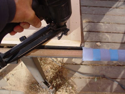

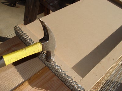

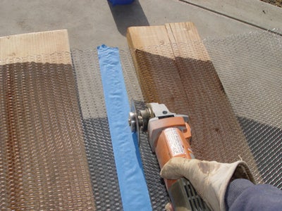

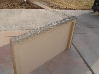

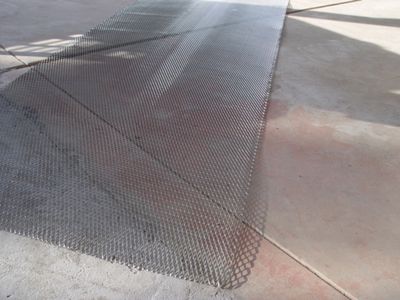

Step 2: Apply the Stucco Mesh.
Stucco mesh or stucco lath comes in “sheets” that are 27" x 96". The cost is approximately $9 a sheet at Home Depot or Lowe’s. Cut the mesh with tin snips, an angle grinder or a skill saw with a metal blade. Masking tape can be used to mark your cutting guideline - it is nearly impossible to draw a straight line across the mesh. Cut the mesh large enough so that it can be wrapped over all the exposed edges and the underside of the MDF edge pieces. Do not wrap the mesh over edges that will be against a wall or not exposed. Position and staple the mesh to the top of the wood core.
Make small pie cuts in each exposed corner and bend the mesh tightly down around the curved edges of the core. Trim the material in the corners wherever it might over lap. You want all the lath to lay as flat as possible against the wood core. Bend the mesh around the bottom edge and staple to the bottom. Use a hammer to pound down any proud staples. The completed wire mesh should look something like the final photo.

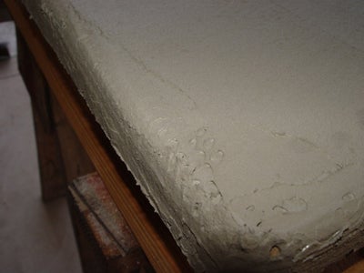

Step 4: Removing the Rough Spots.
When the first coat of thin set is dry (usually over night) sand off the high spots and “nubbers” with 30 to 50 grit sandpaper or an angle grinder with a concrete wheel on it as shown in the photo. You aren’t trying to make anything smooth at this point. You just want to get rid of the imperfections, ridges and pointy stuff that will interfere with applying the second coat.
Apply the second coat of thin set. The goal for this coat is to get about 1/16th” to 1/8" of mortar above the stucco lath. If you created rounded edges, you can get those fairly smooth by simply using typing paper cut into a small rectangle. Apply a fairly heavy coat of mortar to the entire length of the edge and then, beginning at one end of the workpiece, wrap the paper around the contour of the curve as shown in the photo and pull the paper to the other end of the workpiece. With just a little practice you will get a feel for how much pressure to apply and how quickly to move the paper. You will also learn to hold the paper so the edges to not drag in the surrounding wet mortar. Mylar also works well for this task but the plain paper will do in a pinch. Don’t be too concerned if you leave a small line or ridge on each side of the paper as you are pulling. This can be sanded off when it is dry. The photo was taken after the edge was dry simply to demonstrate how the paper is formed and held while it is being pulled down the edge.
When the thin set is dry, sand with 50 grit paper to knock off the high spots, nubbers and trowel lines. Apply a final coat of thin set taking care this time to get the surface as smooth as you can. Your goal now is to get a fairly smooth surface at a uniform height.

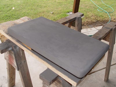

Step 5: Apply the Grout "color" Layer.
When the final coat of thin set is dry, sand surface level with 80 grit paper. Mix a batch of unsanded grout following the directions on the box (I used Polyblend). Unsanded grout comes in a couple basic colors and can buy tints to further customize the color you want. You will need far less of the grout than the thin set. I mixed the grout by hand rather than using the drill and paint mixer because the batch sizes are so much smaller. Apply a thin coat of grout using a rubber Bondo spreader. You want each layer of grout to be just slightly more than the thickness of the grit in the grout. So the rule of thumb is multiple thin layers.
To smooth the curved edged of the grout layer I fashioned a forming tool from a small piece of roof flashing. The tool is bent to the rough shape of the curved edge as shown in the photo. Apply an ample coat of grout to the entire edge and then pull the tool from one end of the workpiece to the other going right around any curved exposed corners you might have. It will take a couple practice runs to get the feel of the technique. Don't worry if you leave small lines or ridges in the wet grout. You can come back when it is dry and fill the low spots and sand off any high spots.
When the grout is dry (usually over night) block sand with 120 grit paper. The curved edges can be sanded with a fine grit foam backed sanding pad available from Ace Hardware or other vendors.
After sanding apply a second coat of grout. Then sand again when dry. Keep applying coats of grout until you no longer see any of the gray thin set layer of concrete peeking through the sanded grout. I had to apply three layers. You may require more or less depending on your particular project. When you no longer see the thin set, block sand one final time with 240 grit and then 400 grit paper. Your results should look something like the final two photos.

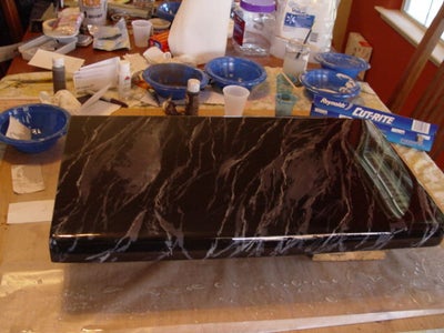

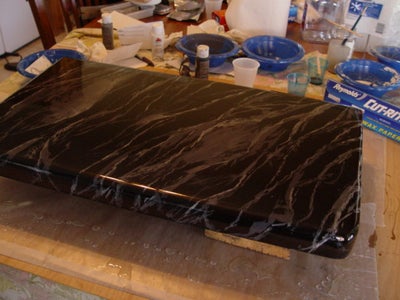

Step 6: Special Effects.
If you want a straight stone type appearance you can skip any of the painting or special effects and apply the final epoxy coat at this point. However, if you want you can also create faux marble or granite effects using a variety of techniques and materials. There are literally dozens of methods for creating these effects and dozens of web sites and you-tube videos describing these methods in much greater detail than I can. Just google “faux granite” or similar terms. I highly recommend you watch as many of these “experts” as you can and then do some experimenting on your own to get an idea of what will work for you to get the effects you want to see.
For this I project I used Kilz white latex primer as my “base” simply because that is what I had on hand. I thinned the base with water and then added Apple Barrel acrylic paints (Wal Mart hobby section) to tint and shade the color. The paint was applied using torn pieces of typing paper which are dipped in the paint and then dabbed and dragged across the workpiece to create a vein effect. The cloudy/misty areas are created by applying a bit of paint and then whisking with a soft brush over the top in multiple directions, much like an umpire dusting off home plate. If you make a mistake, don’t worry. Simply apply more paint over the top until you begin to see an effect that looks right to you.
When you are satisfied with your marble/granite/stone effects and all the paint is dry, apply the top coat of Envirotex Lite epoxy. This epoxy is commonly call “bar top” and provides a thick glossy and self leveling protective coat on the surface of the counter. Just follow the directions that come with the product. Be aware that Envirotex is not UV resistant and should not be used where sun exposure will be an issue. Also, do not use it where hot pots and pans might come in direct contact. It can be used for kitchen counters, but always have suitable tiles or potholders available for setting down hot objects. Also, don’t cut directly on the counter. Use a cutting board.
