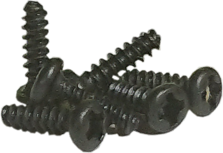

- Eight M1.7 Self Taping Screws x 6mm Long.
- Twelve M1.7 Self Tapping Screws x 10mm Long.
- Sixteen M3 Self Tapping Screws x 10mm Long. This what I used, because I had them. What would be better, would be: Allen-Head Self-Tapping Screws. It will make adjustment easier.

- When printed I usually run a 1.2mm drill bit through all the holes for the M1.7 screws.
- If the holes are too tight the screws can snap, so care is needed when fitting.
Do a pre-assemble.
- It is a lot easier to form the treads in the holes with the screws at this point.

I designed it with Posi-Drive Pan-Head Self-Tapping screws.
- I had to make up a tool to adjust the switches. (Only for the X Axis)

- The clips require holes drilling for Two M1.7x 6mm long self taping screws. (I I used two of these)
- If you are drilling into the tough Bakelite type plastic, the use 2.4mm drill bit.
