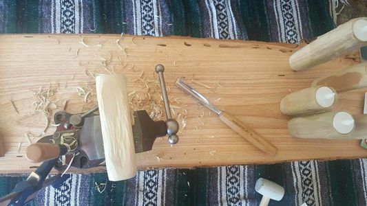

Step 4: The Candles: Drill Holes and Round Edges
I took Poplar @ 8/4 width (roughly 2 boardfeet)
[The tea light candles are 1.5" in diameter so I used a 1.5" forstner bit to drill the holes into the end grain]
I then used a a disk sander to shave off the corners and make them as cylindrical as possible. (if you are good with a lathe, this would have been your next step!)
I added hot glue to create a dripping wax appeal to the candles and some grooves to give it a creepy wizarding feel.
Then paint!! (a candle-like color)
