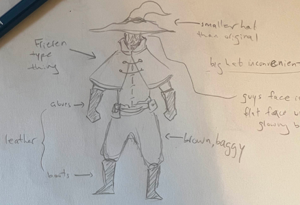

Step 1: Reference
Before I started modeling, the first step I took was to create a reference photo of the character I wanted. I knew that I wanted to create a character that resembled a mage, so with this idea in mind, I scoured the internet for clothes that I believed would fit a mage-like character and complied a reference photo using what I found.
To note, in the final model, I decided to pivot away from the capelet and opted for a shirt instead, as I found that the model looked better without the capelet.

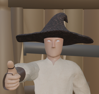

Step 3: Texturing
To prepare my character for texturing, I spent a few hours UV unwrapping it. For me, UV unwrapping is one of the more tedious processes. Yes, Blender and other modeling software can UV unwrap automatically. However, in my experience, more often than not I find that the automatically generated UV maps is not as optimized or organized as I like it.
Thanks to the hefty amount of time I spent UV unwrapping, my texturing process went smoothly and I was able to completely texture my character rather quickly.
