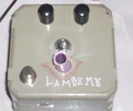

Step 5: Fourth, Push-on Switch Cluster in a Box (to Taste) Like the Following Picture
Fourth, push-on switch cluster in a box (to taste) like the following picture
Step 6: Fifth, Re-PX4 Raft, Do Not Forget to Add a Footswitch Jack Hole in the Casing for PX4, and TADAAAAAAAAAA .... So Is a Foot Switch for the Korg Pandora PX 4
And now my Korg PX4 Pandora bias are invited on stage
