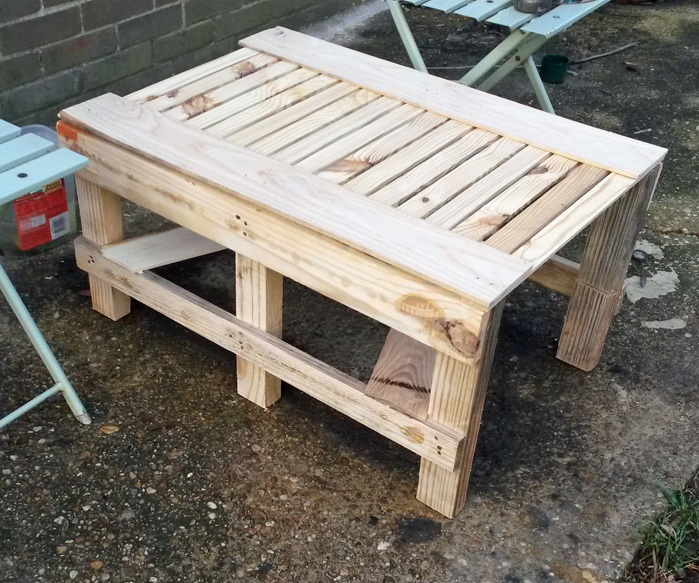

In addition to the cornice from the china cabinet, this project also used wood from all parts of many pallets, and a piece from a table leaf that came with the garage when I moved into my home.

Finally! I was ready to start the tops. First, I made frames for each drawer top. Again, this is pallet wood that I cut into 1/2" square dowels. Next, I started laying out my slats. Some of these slats are sliced 2x4's (pine), some are white oak and some are red oak. It is amazing the variety of wood you can get from pallets! I tried various designs before I settled on the angle/straight/angle pattern. I laid the frame out over top my laid out slats to trace the cuts I would need to make.
I glued the edge of each slat together within the frame and pinned the slat to the frame and let dry. Once the top panels were dry, I flipped the tops over and started laying out a second set of slats. These slats all went vertical, so to offer support to the decorative topside.

Using the same method as the tops, I assembled slats, again in a pattern, for the bottom shelf. Once I had the slats in cut and in place, I glued the edges of the slats to each other and let dry overnight. Without any supports, this needed to dry completely in order to flip it upside down so that I could attach support to the bottom side.
So, after it was completely dried, I was able to flip it over, attach 1x1 cross supports, and a 1x1 edge on the back side.
Step 6: Legs and Assembly
Next, I used 2x4's for the legs. I attached a 1x1 to the 2x4's on each side for the shelf to rest upon. Once the legs were in place, and the shelf was in place, I was able to use the strip fro the table leaf (which turned out to be poplar) to not only create a finished look on the front of the shelf, but help secure the shelf to the legs. I 'wrapped around' this poplar strip to in between the 2x4 legs.
The poplar strip is glued in place to the front of the shelf, and also screwed into the shelves' supports. The side wrap around piece is screwed, but not glued, to the bar the connects the 2x4's and to the shelf's edge support.
