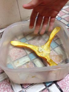

Step 1: The Fruit Peel Preperaration
This is the most important part of the experiment, the fruit peel preparation.
1 Carefully take the peel off the fruit. Keep as much as you can in one piece and shaped with 3 legs.
2. Let it dry out for a few hours.
3. Soak it in water for a half a day.
Start this process first and then go work on the circuit.
