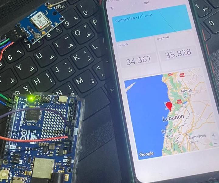

This project involves utilizing the NEO-6M GPS sensor with Arduino to gather geographical data. The aim is to test and verify the accuracy of the latitude and longitude values extracted from the sensor. By ensuring the correctness of these coordinates, the project aims to establish the reliability of GPS data acquisition using Arduino for diverse applications.
Tools Required:
Arduino Board with Cable: The Arduino microcontroller serves as the central processing unit for interfacing with the GPS module and processing the data received from it. The cable facilitates the connection between the Arduino board and the computer for programming and power supply.
GPS NEO-6M Sensor: The NEO-6M GPS module is a compact and cost-effective device capable of providing accurate positioning data through satellite communication. It receives signals from GPS satellites to determine latitude, longitude, altitude, and time information.
4 Wires Female to Male: These wires are essential for establishing connections between the Arduino board and the NEO-6M GPS sensor. They enable the transmission of data and power between the two components, facilitating communication and functionality.
Step 1: Circuit Setup and Wiring
TX and RX Connections: Connect TX pin of NEO-6M to Arduino's digital pin 2 (RX), and RX pin of NEO-6M to Arduino's digital pin 3 (TX).
Voltage Connection: Ensure VCC pin of NEO-6M is linked to Arduino's 3.3V output to supply the correct voltage, preventing potential module damage.

Step 5: Result
  1. Open Serial Monitor: Connect your Arduino board to your computer, open the Arduino IDE, and navigate to Tools > Serial Monitor (or press Ctrl+Shift+M). This will open the Serial Monitor window, where you'll see the output from your Arduino.
  2. Wait for Data: Allow the Arduino to run for approximately 3 minutes. This gives the GPS module enough time to acquire satellite signals and determine its position.
  3. Move Outdoors: Ensure you're in an outdoor location with clear visibility to the sky. GPS modules require a clear line of sight to satellites to function accurately.
  4. Read Latitude and Longitude: Once the Arduino begins printing latitude and longitude values to the Serial Monitor, copy these values.
  5. Search in Google Maps: Open Google Maps in your web browser or mobile app. Paste the copied latitude and longitude values into the search bar and hit Enter. Google Maps will locate the specified coordinates on the map, allowing you to see the exact outdoor location where the GPS data was obtained.
By following these steps, you'll be able to retrieve and verify the GPS coordinates provided by your Arduino setup using the NEO-6M GPS module.
