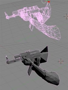

2) To process the data I started by trying to open the extracted map data in Blender, what I found was that the file was just to large either for Blender or for my system to handle (I work on a MacBook Pro running Bootcamp). Eventually, I downloaded a 30 day trial of 3D Studio Max which was able to handle the file. Fairly straight forward in the processing, essentially I selected the objects desired, then clicked select inverse, deleted all the other data, leaving me with a pair of hands and the pistol. You may be overwhelmed, btw, when you first open your extracted model as this will often be the entire map of the game space in question - finding what you want to use for your build is a matter of zooming in and moving around the map until you find what you are looking for. As I am at most a novice with 3D Studio Max and I am not an expert with 3D modelling software, this took a bit of getting familiar with the program - there are hundreds of useful tutorials online so just about anything you want to learn to do with the software you can figure out with some investigation, trial and error.
Very important: However you extract your data or process it be absolutely sure to lower your polygon count in the 3D software BEFORE you go into Pepakura. What I look for is a visual balance of keeping the basic integrity to the extracted objects while being aware that in building your object the higher the polycount the more difficult to impossible the object can be to build once you start working through Pepakura.

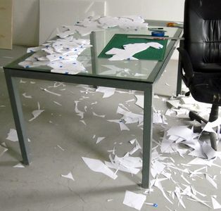

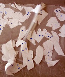

The first image shows you the diagrams as printed out on large sheets of paper. The second image shows the diagrams after carefully cutting these out. Once these are cut out (I used a combination of scissors and matt knife), I was then ready to start using these as guides for cutting out the pieces of corrugated plastic.

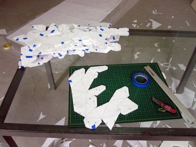

Step 4: Cutting, Scoring and Numbering...
Basically, I lay the diagrams upon the pieces of corrugated plastic, using the blue painters tape to tape several edges of the diagram in place. I then start cutting. As I cut edges, I use other small pieces of tape to hold the diagram in place - these pieces need to be cut out perfectly or the resulting fit of the various pieces as you put together the final object will be off!
Once I have the overall shape of each piece cut out, I then carefully follow the dotted lines of the diagram to score where the polygons need to fold to create the physical form of the object. These will be either on the side where the diagram lays or on the reverse side according to the different dotted line pattern provided by the Pepakura diagrams! Be sure you understand which is which BEFORE you start cutting as these are crucial to the overall make up of the final object! I use blue tape to keep the diagram together where I cut the face of the paper to make the scores.
At this time I am also carefully writing the numbers from the diagrams directly upon the surface of the cut-out corrugated pieces (you want to be sure you are writing on what will be INSIDE the completed object otherwise you will have tiny numbers all over your piece!). These are crucial as they tell you were to glue the tabs to connect to the corresponding number on the other pieces.

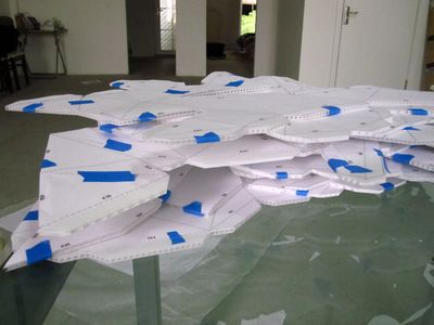

This step is likely the most fun but also takes a high level of patience! Matching up the pieces to their corresponding number while also carefully working to follow the scoring as cut in the last step should be executed carefully and strategically. You want to be sure you are able to reach areas as you start to enclose the object - working at this scale one may need to get a bit acrobatic in reaching, gluing and holding pieces in place!
Start by simply matching numbers, gluing edges to matching tabs, and watch as your object begins to take shape! This is really similar to putting together a puzzle! Take your time, watch out for hot glue and be sure and double check your diagrams (keep these handy btw) to be sure you did not miss any scores or numbers along the way - any mistakes to your diagrams and/or cutting will make for some frustrating moments where things just won't fit until you get it right!). Just remember, the Pepakura diagrams are generally perfect - if something is not fitting, you are generally doing something incorrect!

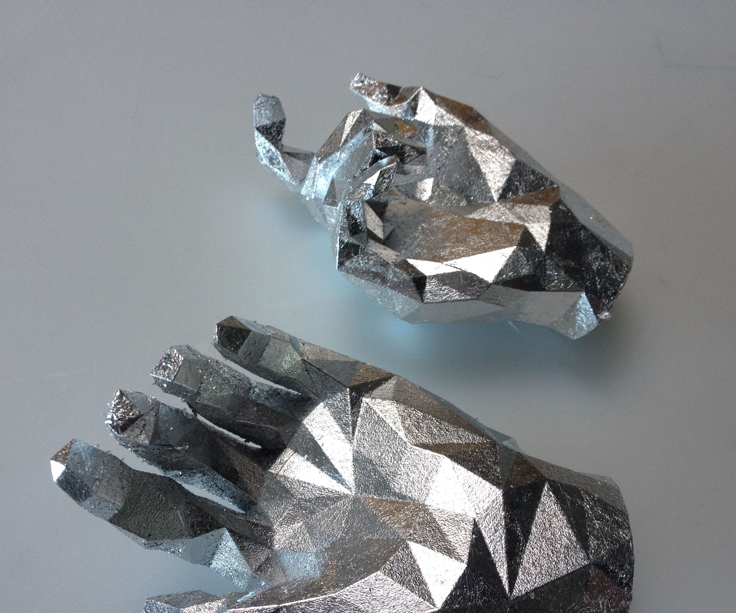

Step 7: Finished!

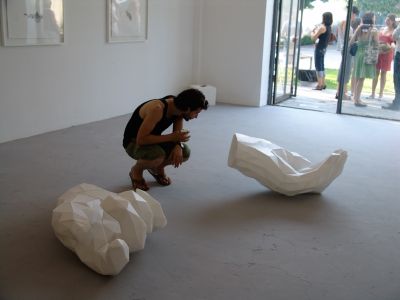

Once the pieces are completed, I gently wiped them clean with a wet rag to remove any dust or dirt. Here are some pictures of the pieces, "Taliban Hands" as on display last year at the Where Where Exhibition Space in Beijing China as part of the show "Screen Shot" in 2011. Feel free to send me any questions about the process of the build! Feel free to view this work and others on my website: http://www.delappe.net
