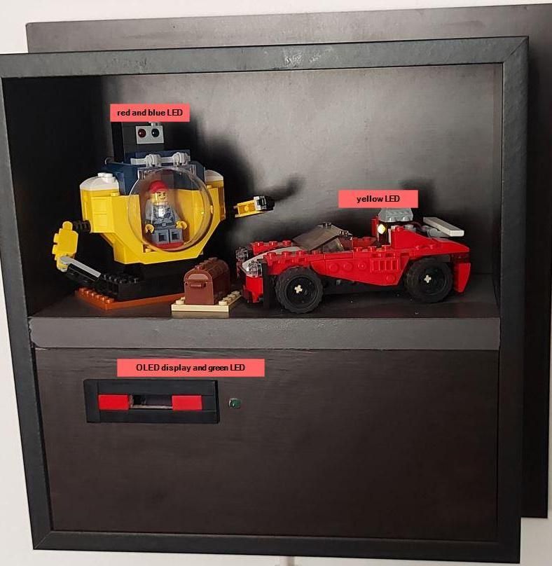

  • The wget call controls an LED in the SmartHome to see, the garage is open (LED=GAON) *

  • The wget call controls an LED in the SmartHome to see, the garage is cloes (LED=GAOFF) *
  • The copy command copies the sound file "garage_zu_40cent.gsm" (garage is CLOSED announcement) as "garage_aktuell.gsm" because ASTERISK ALWAYS plays the file "garage_aktuell.gsm" after picking it up
To operate the garage, see Step 4 - this is done by ASTERISK's Extensions.conf.
*10.45.0.23 is another self-made SmartHome device. See here: https://www.instructables.com/Smart-Home-Event-Viewer/
