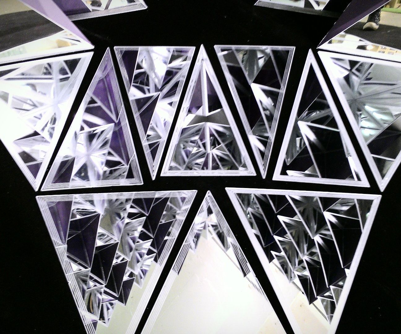

Step 2: CAD DESIGN PROCESS:
Geo-Cognition was originally designed through McNeel and Associate's Rhinoceros3D. The program enabled the design to be carefully and technically measured, and CAD modelled before the fabrication process. Procurement and also establishing the general design direction was through the 3D modelling process, whereby the individual modules were fitted specifically to the onsite specifications.
Step 3: FABRICATION PROCESS:
The initial design concept is to enable the production of transportable and light boxed designed, that would be able to be shipped through three checked-in airline carrier requirement boxes. This was due to the limited amount of boxes the team would like to ship along the flight, and also minimized the headache of shipping the installation modules separate from our team.
After several trial and errors of initially trying to make a wood mold, and drilling with piano wire through the wood CNC milled formwork, our team then used HIPS plastic to form negatives to be placed onto the wood formwork. Realizing that the HIPS plastic negatives did not produce the precise definitions we would like to achieve through the sweeping details of the CNC milled lineweights, our team strategized on producing the final production through the donated EPS foam from the construction site.
The milled EPS medium-density foam allowed more precise CNC milled formwork, but were more bulky to ship. And require additional finishing, such as airbrushing the entire installation with an industrial pressurized air brush. The final finish of the installation was 2 gallons of KILNS acrylic paint. The total production time for the installation was 3 days of milling, and 1 day of paint work, plus an additional 1 day for finalizing the dry-bed of the pieces.
