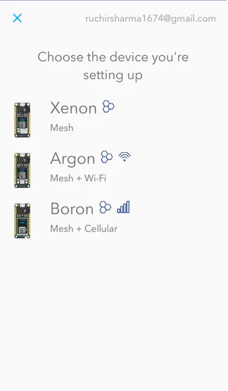

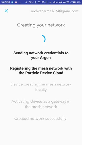

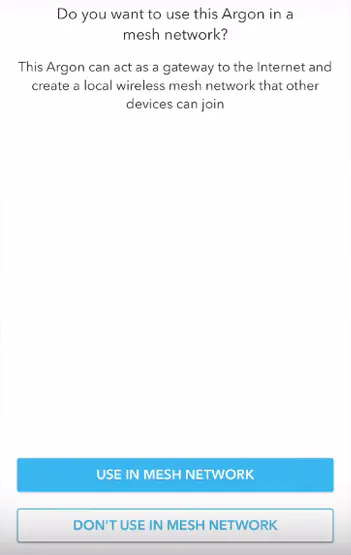

How to setup Argon

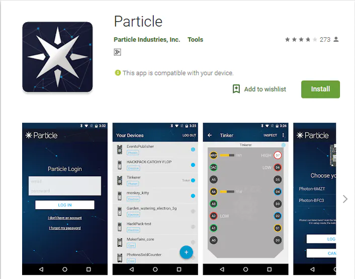

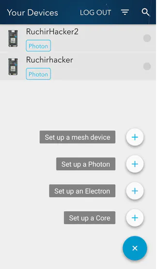

There are many ways to set up Particle devices. The easiest way to set up Argon is using mobile phone (Andriod or iOS) and a connection to the internet. Here, I am using Andriod phone.
1.Plug Argon with USB of your computer make sure blue led will blink (Listening mode). When Argon is in Listening Mode, it is waiting for you to configure your mesh network. If it is not blinking blue, to put your Argon in Listening Mode, hold the mode button for three seconds, until the RGB LED begins blinking blue.
2.Open Particle app in your phone. If you don't have download it from play store.
3. Login to your particle account. After login, in "your device" window you will see "+" button to add new device. Press "+" button you will see 4 options select set up a mesh device.
4. Then it will ask for turning Bluetooth ON then choose choose device we want to setup ( we are setting up Argon). Select Argon.
5. Next, it will ask whether you have connected antenna to Argon or not. If you already connected tick the box and press next.

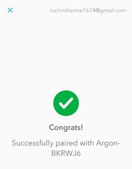

6. Then, it will ask you to scan barcode on the device(Argon). After that, It will start pairing with your device and after pairing it will pop up window as shown below.
7. After that, it will start updating Firmware.One updated it will ask you whether you wanna use it in mesh network or not (I have selected yes).
8. Then, it will ask you to connect with WiFi. I am facing some issue with connecting with WiFi network with security (will be fixed in upcoming firmware). So I created a network without security.

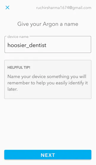

9. Once connected it will ask you to give a device name.

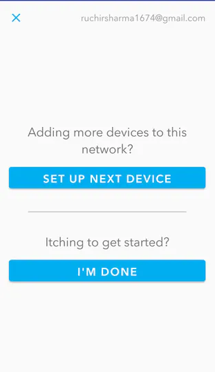

10. Next, it will ask you to give a network name and set a password. Once you set password it will create a network.
After setting up gateway you will see a window as show shown below
You can set up more device or select I'm done. Our Argon is now ready. You can see name of your device.

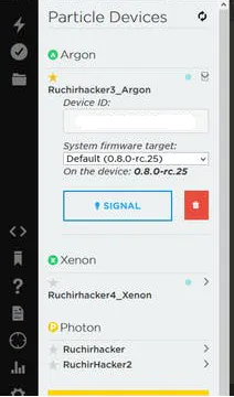

11. After setting up, go to Particle IDE.
Login to your account. Now, we are going to program our Particle Argon. First select your device(Argon) by click on star. You can see I already selected Argon as shown below
We are using led test example. Go to code section and you will see examples app.
Select blink an LED, to use this app click on use this example.
To upload a code, select a board and then click on flash.

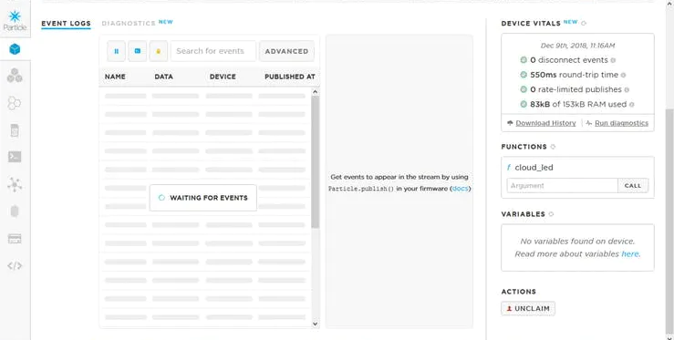

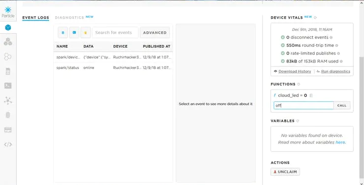

Now, its time to check our new function. The best way is from the console. It is look as shown below
Go to devices tab in console, click on the row for the device(Argon) you just flashed your code to.
You will see tab like as shown below
On the right-hand side of the screen is a box for functions. There should be one labeled "cloud_led".
  • If you type "on" (without the quotes") and click the call button the LED will turn on.
  • If you type "off" and click the call button the LED will turn off.
If your LED on and off using console we are done with checking.

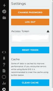

Before moving to HTML part we need to things.
1. Device ID ==> find in device section
2. Access Token ==> find in settings section.

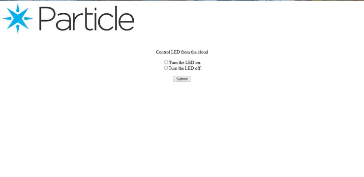

Webpage
As we have device id and access token now we can proceed to html file. Open notepad, write code in that and save it as an.html file. Replace your device ID with your actual device ID and your access token with your actual access token.
<code><span class="hljs-meta"><!DOCTYPE>
</span><span class="hljs-tag"><<span class="hljs-name">html></span>
</span><span class="hljs-tag"><<span class="hljs-name">head></span>
</span><span class="hljs-tag"><<span class="hljs-name">meta name="viewport" content="width=device-width, initial-scale=1.0"></span>
</span><span class="hljs-tag"></<span class="hljs-name">head></span>
</span><span class="hljs-tag"><<span class="hljs-name">body></span>
</span><span class="hljs-tag"><<span class="hljs-name">img src="index.png" style="max-width:100%;height:auto;"></span>
</span><span class="hljs-tag"><<span class="hljs-name">br></span>
</span><span class="hljs-tag"><<span class="hljs-name">center></span>
</span> <span class="hljs-tag"><<span class="hljs-name">br></span>
</span> <span class="hljs-tag"><<span class="hljs-name">form action="https://api.particle.io/v1/devices/device_id/cloud_led?access_token=token" method="POST"></span>
</span>   Control LED from the cloud<span class="hljs-tag"><<span class="hljs-name">br></span>
</span>   <span class="hljs-tag"><<span class="hljs-name">input type="radio" name="arg" value="on"></span>Turn the LED on.
</span>   <span class="hljs-tag"><<span class="hljs-name">input type="radio" name="arg" value="off"></span>Turn the LED off.
</span>   <span class="hljs-tag"><<span class="hljs-name">input type="submit" value="Submit"></span>
</span> <span class="hljs-tag"></<span class="hljs-name">form></span>
</span> <span class="hljs-tag"></<span class="hljs-name">center></span>
</span> <span class="hljs-tag"></<span class="hljs-name">body></span>
</span><span class="hljs-tag"></<span class="hljs-name">html></span>
</span>

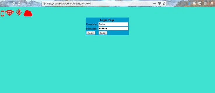

Open html file using browser. You will see page like as shown below
I made a simple login page which will redirect to main control page after successful login.

Step 3: Code
Code for controlling LED
int led1 = D2;
void setup()
//Pin configuration
pinMode(led1, OUTPUT);
// Declare a Particle.function so that we can turn the LED on and off from the cloud.
Particle.function("cloud_led",ledToggle);
// When we ask the cloud for the function "cloud_led", it will employ the function ledToggle() from this app.
// Make sure both LEDs are off when we start
digitalWrite(led1, LOW);
//Since we're waiting for input through the cloud this time,
//we don't actually need to put anything in the loop
void loop()
// Nothing to do here
// We're going to have a super cool function now that gets called when a matching API request is sent
// This is the ledToggle function we registered to the "cloud_led" Particle.function earlier.
int ledToggle(String command) {
/* Particle.functions always take a string as an argument and return an integer.Since we can pass a string, it means that we can give the program commands on how the function should be used. In this case, telling the function "on" will turn the LED on and telling it "off" will turn the LED off.Then, the function returns a value to us to let us know what happened. In this case, it will return 1 for the LEDs turning on, 0 for the LEDs turning off,and -1 if we received a totally bogus command that didn't do anything to the LEDs.
if (command=="on") {
digitalWrite(led1,HIGH);
return 1;
else if (command=="off") {
digitalWrite(led1,LOW);
return 0;
else {
return -1;
Code for LED control page (HTML)
<!DOCTYPE>
<html>
<head>
<meta name="viewport" content="width=device-width, initial-scale=1.0">
</head>
<body>
<img src="index.png" style="max-width:100%;height:auto;">
<br>
<center>
<br>
<br>
<br>
<form action="https://api.particle.io/v1/devices/e00fce68857de2ce3bcda922/cloud_led?access_token=6c1e60f7bc502028dee2df04e148b351d7f74f2f" method="POST">
Control LED from the cloud<br>
<br>
<input type="radio" name="arg" value="on">Turn the LED on.
<br>
<input type="radio" name="arg" value="off">Turn the LED off.
<br>
<br>
<input type="submit" value="Submit">
</form>
</center>
</body>
</html>
Code for Login page (HTML)
<html>
<head>
<title>Login Page</title>
<link rel="stylesheet" href="https://cdnjs.cloudflare.com/ajax/libs/font-awesome/4.7.0/css/font-awesome.min.css">
<link href="https://fonts.googleapis.com/icon?family=Material+Icons" rel="stylesheet">
</head>
<body bgcolor = #40E0D0>
<i class="fa fa-mobile" style="font-size:48px;color:red"></i>
<i class="fa fa-wifi" style="font-size:48px;color:red"></i>
<i class="material-icons" style="font-size:48px;color:red">bluetooth_connected</i>
<i class="fa fa-cloud" style="font-size:48px;color:red"></i>
<br>
<form name="loginForm" method="post" action="Particle.html">
<table width="20%" bgcolor="0099CC" align="center">
<tr>
<td colspan=2><center><font size=4><b>Login Page</b></font></center></td>
</tr>
<tr>
<td>Username:</td>
<td><input type="text" size=25 name="userid"></td>
</tr>
<tr>
<td>Password:</td>
<td><input type="Password" size=25 name="pwd"></td>
</tr>
<tr>
<td ><input type="Reset"></td>
<td><input type="submit" onclick="return check(this.form)" value="Login"></td>
</tr>
</table>
</form>
<script language="javascript">
function check(form)
if(form.userid.value == "default" && form.pwd.value == "default")
return true;
else
alert("Error, Enter valid Username or Password")
return false;
</script>
</body>
</html>
