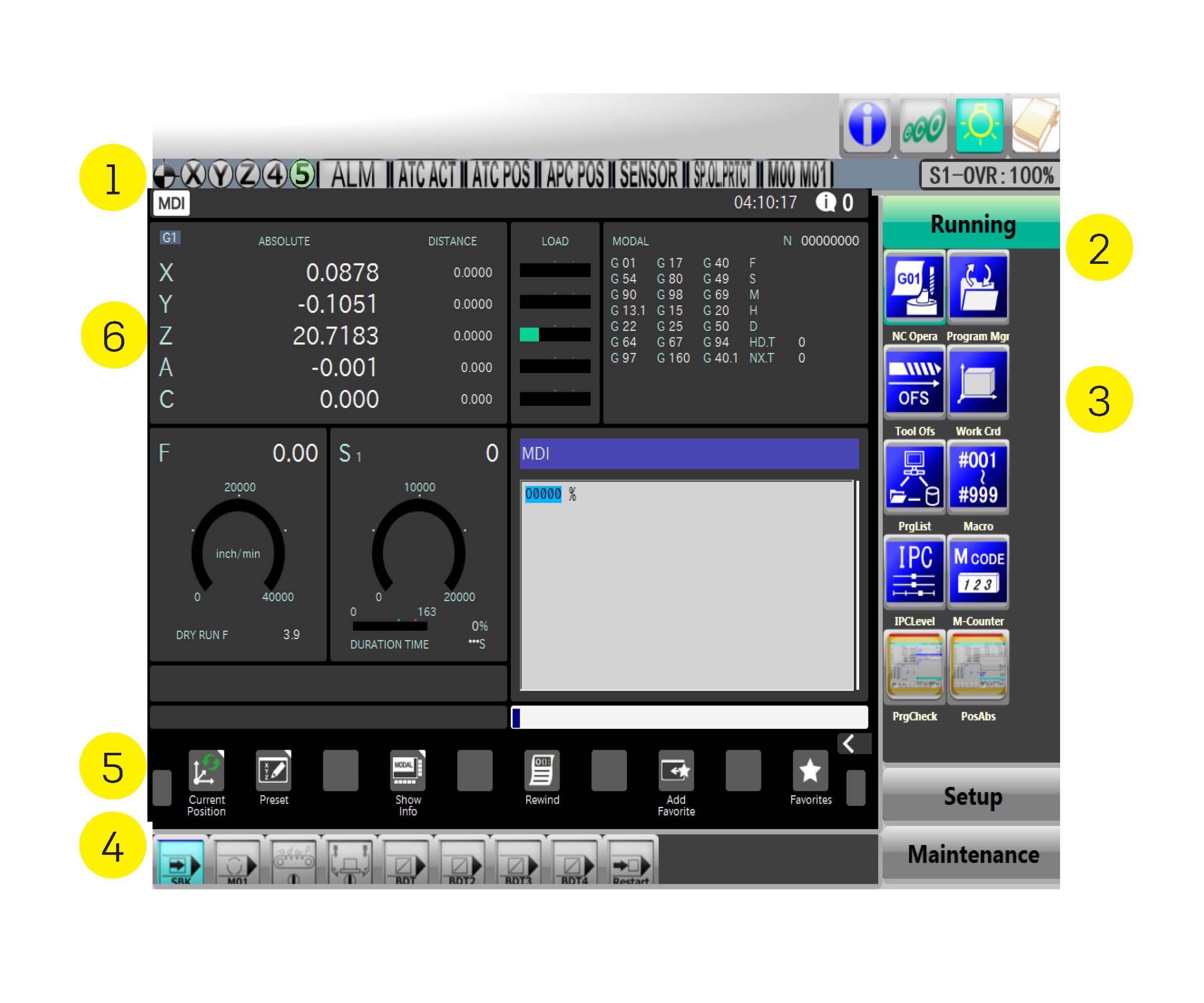

DISPLAY
The mill uses a touch screen that changes based on the category you’ve selected.
- Status bar
- Displays alarms, lights, and overdue maintenance items.
- Category display area
- The three categories are Running, Setup, and Maintenance.
- Sub-category icons
- The icons that appear under each category are sub-categories.
- Example: Program Manager is a sub- category of Running.
- Category commands
- Sub-category commands
- Main screen
