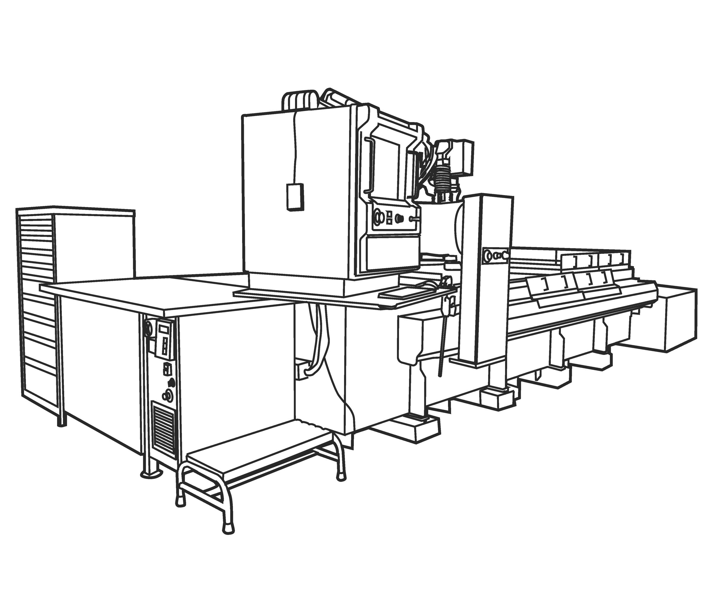

Step 3: Machine Overview
The jet uses up to 60,000 PSI of water pressure to make the cut.
A waterjet uses a stream of extremely high-pressure water, mixed with particles of garnet, to cut almost any material up to about 8" thick.
The machine is capable of cutting complex shapes in 5 axis, but this Quick Start Guide will focus on 2D shapes, like cuts on the laser.
High-pressure water enters the nozzle assembly. Garnet is added to the water and mixed in the mixing tube.
The jet of water and garnet exits from the bottom of the nozzle.
The size of the mixing tube determines the diameter of the jet and the cutting width (called the kerf). The standard size mixing tubes at the P9 Workshop are 0.035" or 0.042" (0.89mm or 1.07mm).
Over time, the diameter of the mixing tube will enlarge because of erosion. To make parts to an exact size, you may need to edit the tool offset later in the cutting process.
