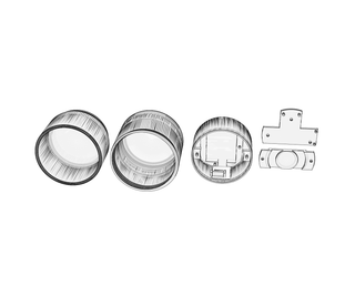

Solder the components together as seen on the circuit diagram. Make sure that you keep wires long enough to give a little bit flexibility to your circuit so that you can embed it into your enclosure with ease.
Step 4: 3d Printing and Laser Cutting
1) You should use translucent filament for a better light diffusion.
Print it on standard resolution. Make sure that you have supporting materials. (You can break them when print is done)
2) Laser cut 1/8" thickness 2.3" diameter circle from clear acrylic.
Step 5: Assembly
1) Embed components into 3d printed enclosure. It might be a little bit hard.
2) Make sure that everything fits its place properly.
3) Control the switch and USB outputs. If they work well, then you can glue acrylic part to the top of the enclosure.
4) Assembly all part together
