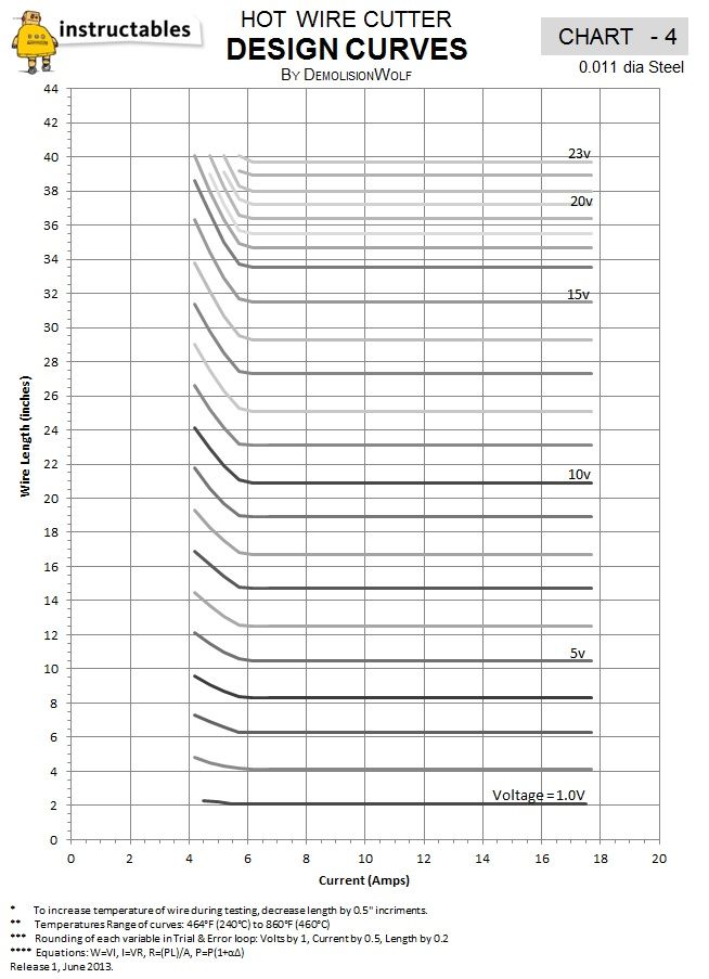

(there are various instructables how to make a hot wire foam cutter. see my instructable hot wire foam cutter calculator so you can finish this project without having your transformer (ac adapter) blow up and/or prevent the wire from burning through all the time.)
