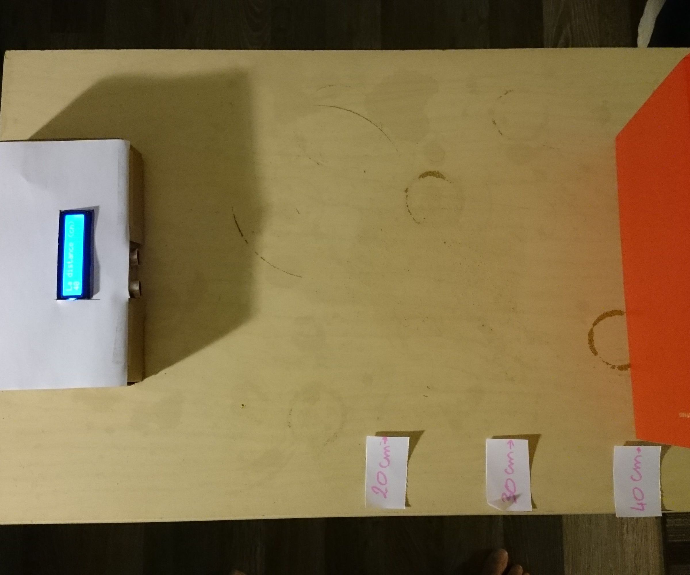

Step 3: Connecting the HC-SR04
the HC-SR04 connection is given in the pictures above.

Step 5: Installing the HC-SR04 Module
Place the HC-SR04 near your doorknob, it should measure a distance lower than 10cm, this distance can be read in the serial monitor of the Arduino software. you can change this distance in the program if you need to.
