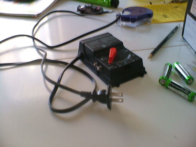

  • Digital Multimeter or other device for testing continuity. (LED and battery work here).
  • Variable power supply or standard ATX power supply (for figuring out supply voltage for the tube)

This is relatively easy once you have found the power and ground pins. Connect your power source to the conncting wires that plug into that connector of the viewfinder and set the power supply voltage to its LOWEST SETTING. Once that is set, SLOWLY increase the voltage to 5 volts while watching the CRT. when the screen glows you have found the input voltage. If not, then increase the voltage till the screen glows. DO NOT EXCEED 12 VOLTS.
