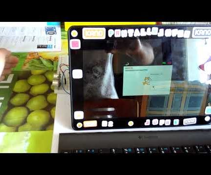

The concept is to hack a ball circuit with raspberry Pi 2 Kano computer and add a sensor and lights for more fun.
The ball circuit is a Solar powered Circuit from Miniland. The idea is to remove the solar power and power the circuit from the Raspberry Pi. We switch on the circuit with the IR sensor and we also add lights to signal on/off state of the motor (red led) and the motion of the balls (oscillating yellow lights). In the screen, we see the state of the machine and a counter with the number of loops for the oscillating lights.
The program to control all the system is written in python 2.
