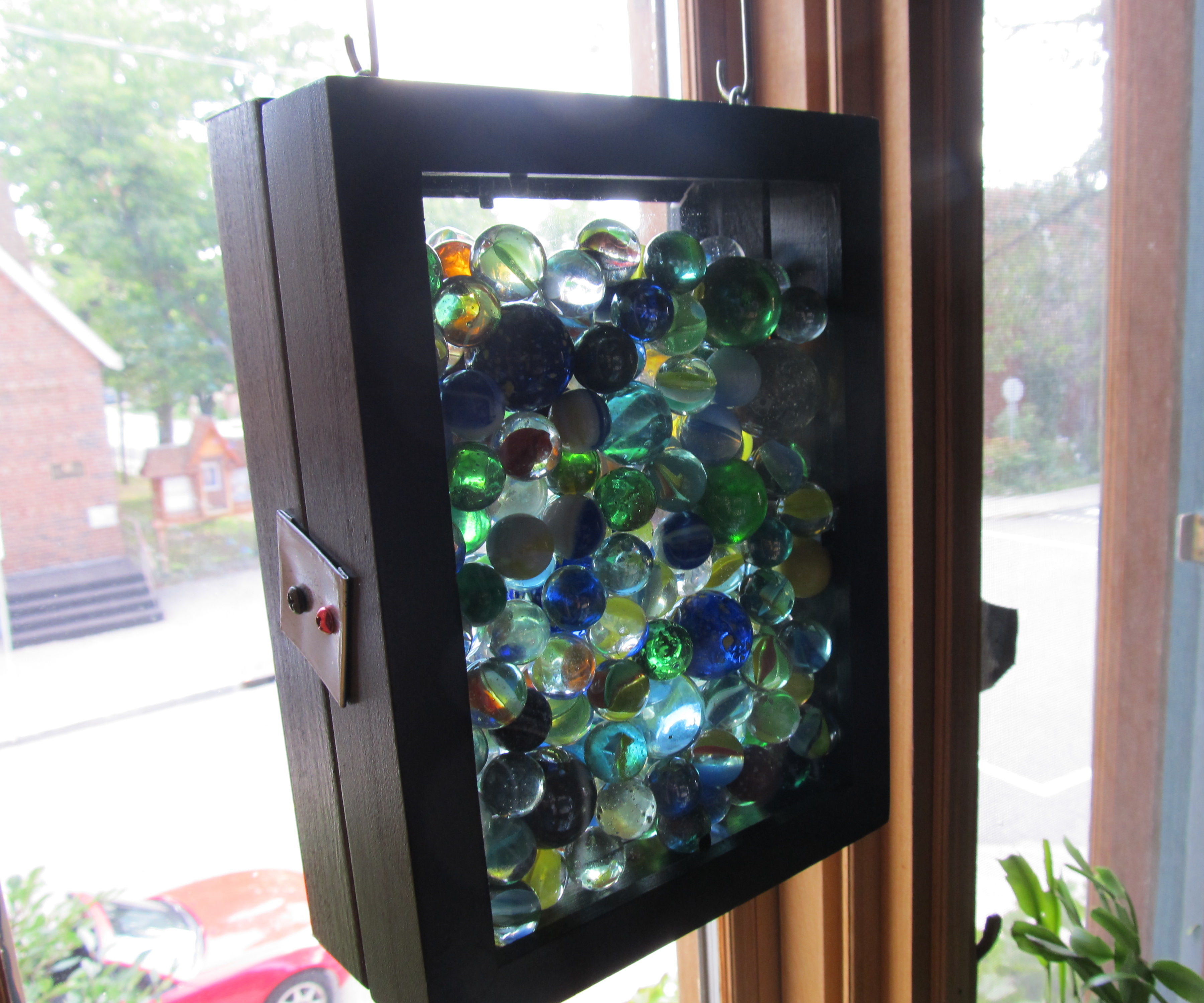

Introduction: Hanging Marble Shelf
Here's a whimsical bit of colour for a window.
I made a 1-level shelf and liked it so much that I then made a 2-level version out of wood I had left over from the first one.

    Step 1: Painting
    Before painting, drill holes in the jar lids with a 3/32" drill bit. (For my first shelf, I only drilled one hole in each lid. But when I screwed the jars on to the lids, the lids rotated. For the second shelf, I drilled two holes in each lid. Which meant I had to use twice as many screws, but no lid rotation when attaching the jars.)
    I painted everything black because I thought having them that would give more emphasis to the colours of the marbles. I used spray paint I had in the basement for most of it, with acrylic from the craft cupboard for touch ups.
    For the painting, I learned after my first try that putting a screw through a hole in the lids allowed me to move the lids around without touching the painted lids and also minimized how much of the lids touched the cardboard while the paint dried.
    Step 2: Attach the Jar Lids to the Bottom of the Shelf
    1. Arrange the lids on the bottom of the shelf in the order for the jars to go.
    2. Temporarily tape the lids to the shelf so you'll know where to make the drill holes.
    3. Use a pencil to mark where to drill the wood for each lid.
    4. Tape the drill bit so that only about 3/8" of the bit shows.
    5. Drill holes for the lids.
    6. Attach the lids with 1/2" or 3/4" wood screws.
