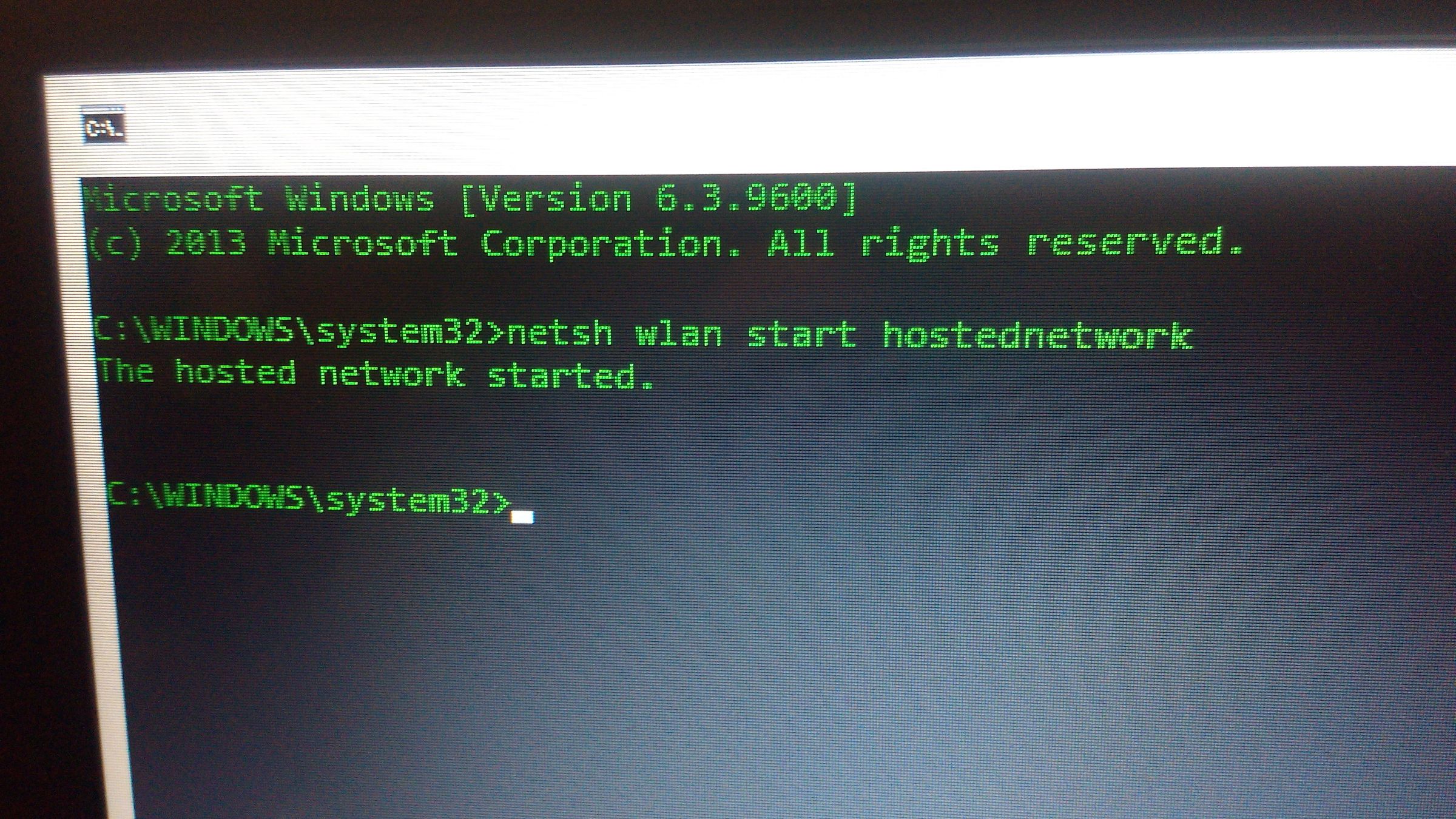

Step 3: After Software Installations (Getting IP)
1. Launch dhcp server.
2. Connect Pi and laptop using Ethernet cable.
3. Power on Pi.
4. Wait till windows notifies you of a new device. (An IP address and MAC number will appear)
5. Take note of the IP address; it is the IP assigned to the Pi by the dhcp server.
