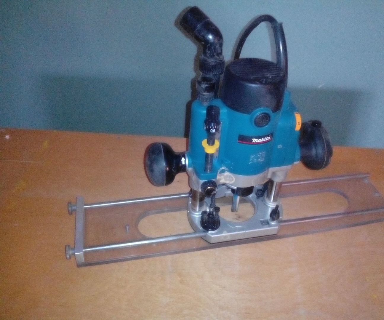

And we can roting the mounting holes for drivers.
Step 3: Holes and Surface Finishing
Great tool for making the holes you need is my circle jig for router. Instructable to build one. You can make me happy by voting. It is easy way to make really perfect circles for speakers.

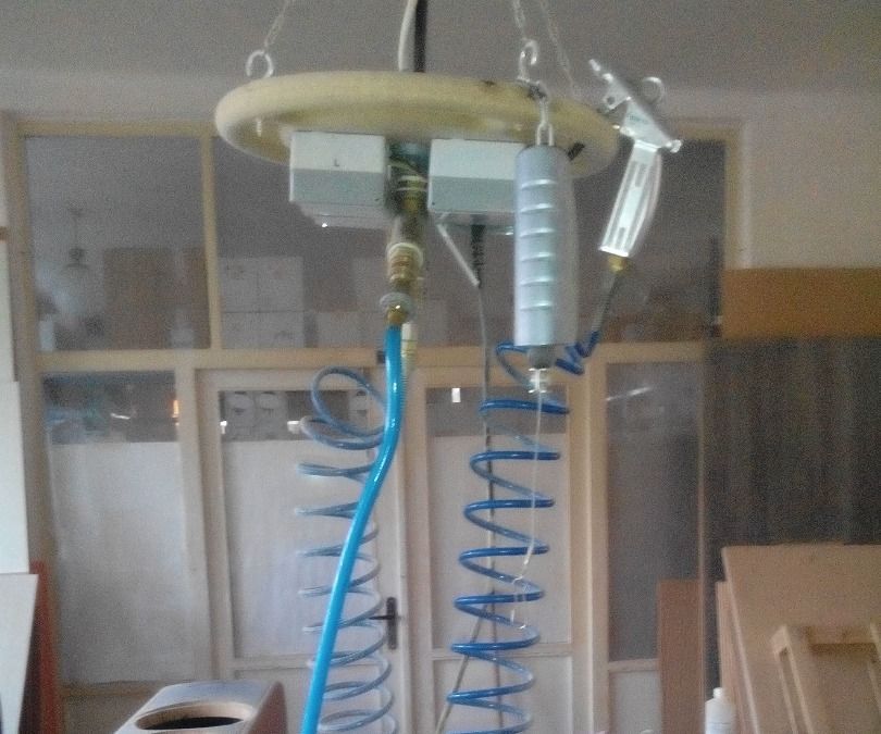

Now we can lacquer the surface of the cabinets. I choosed the nitrocellulose lacquers to finishing. The base coat in 3 layers and 2 layers of half shine lacquer was applied. At the end I have polished the surface with Autoglym Paint Pro system.
