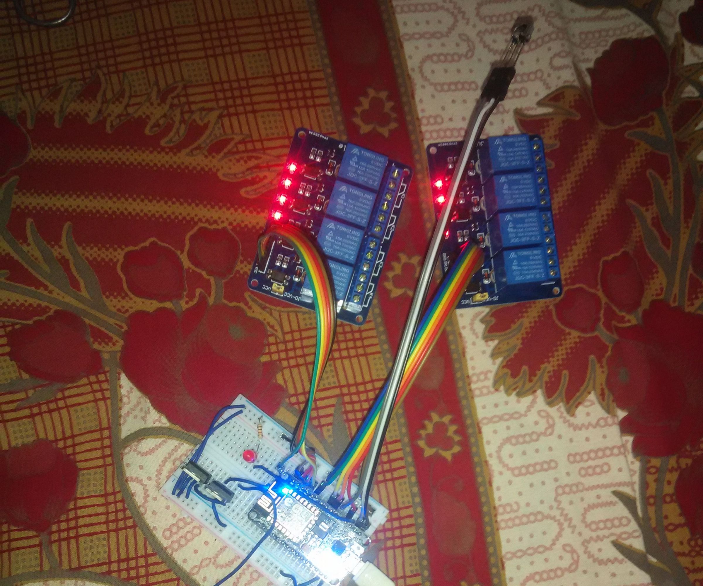

Step 3: Schematics and Code
Download the attached image and make the circuit accordingly.
If your Relay is powered by 12v, then make the changes as required. Relay module mostly works on active low. If your relay works on active high, then the change the code as required.
Then upload the code or sketch.
Before uploading, change the IR values in the code, with the values you got on previous step.
If you just want to use it WITHOUT Internet and Google Assistant, then use the code my home.ino
If you want all features then use the code Home Control.ino
