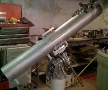

Step 11: Mount Assembled
All the different assemblies together as a mount head.

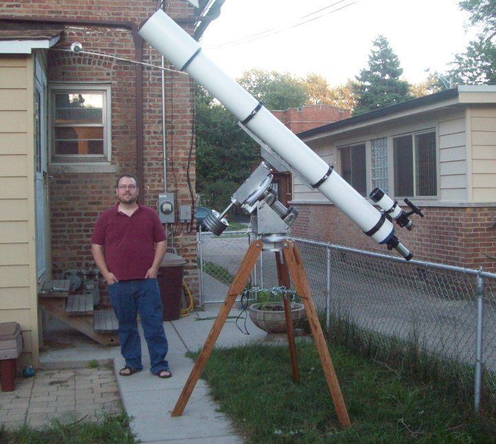

Step 12: Finished Mount
After some fiddling, refitting, stiffening sanding and painting, the finished mount....

Step 14: The Tube...
The tube is a section of aluminum tube made by Hastings Irrigation. I had to special order the size as shipping an 8' l tube costs as much as the tube itself...
The focuser is a Synta refractor focuser painted blue for looks.
The interior is baffled via 7 knife-edge baffles spaced 12" apart. The baffle assembly was built from plans I drew of the optical path. The baffles are kept out of the light path by about 1/4" or so.

Step 17: How Does It Perform?
This refractor is an achromat which normally would not be suitable for photography. Due to it's large focal ratio (f15) and long focal length(2276mm) this scope is a superb planetary performer. This is a photo of Saturn taken with a Celestron Neximager, a webcam-based imaging camera. This photo is a stack of 1000 frames in Registax. There is a white blob which is a storm imaged on the surface of Saturn from 3 blocks outside of Chicago!
