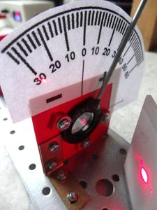

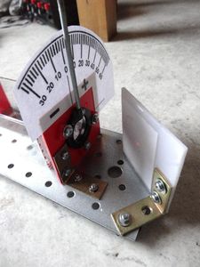

The first polarization filter is permanently installed in its holder. The second polarization filter must be rotatable. These two filters must be arranged in such a way that no light can penetrate the second polarization filter at 0 ° on the scale or that it is perpendicular to the first filter. This is best checked by looking at the sun through both filters. The second, rotatable polarization filter is set to 0 ° and then the first is rotated until the intensity is minimal. Then you leave the first filter in its position and only turn the second filter for the experiment later.

The experiment is actually very simple. You put a certain, known amount of sugar (for example 3.6 grams per cube) into the cuvette and dissolve it with a known amount of hot water (for example 85 milliliters). Then you put the different colored lasers one after the other in the holder and rotate the second polarization filter until the intensity on the screen is minimal. This angle of rotation alpha is noted for the respective wavelength of the laser and the concentration of the dissolved sugar (in grams per milliliter).
In my case each sugar cube has a weight of 3.6 grams and the length of the cuvette is 0.798 decimeter. If you put for example 2 sugar cubes into 85 ml of water, the concentration will be 2*3.6 g / 85 ml = 0.0847 g/ml.
For 4 sugar cubes you can see the needed angle of rotation for the four different lasers in the pictures, 18° for the 405 nm laser, 15° for the 450 nm laser, 10° for the 520 nm laser and 8° for the red 640 nm laser.
