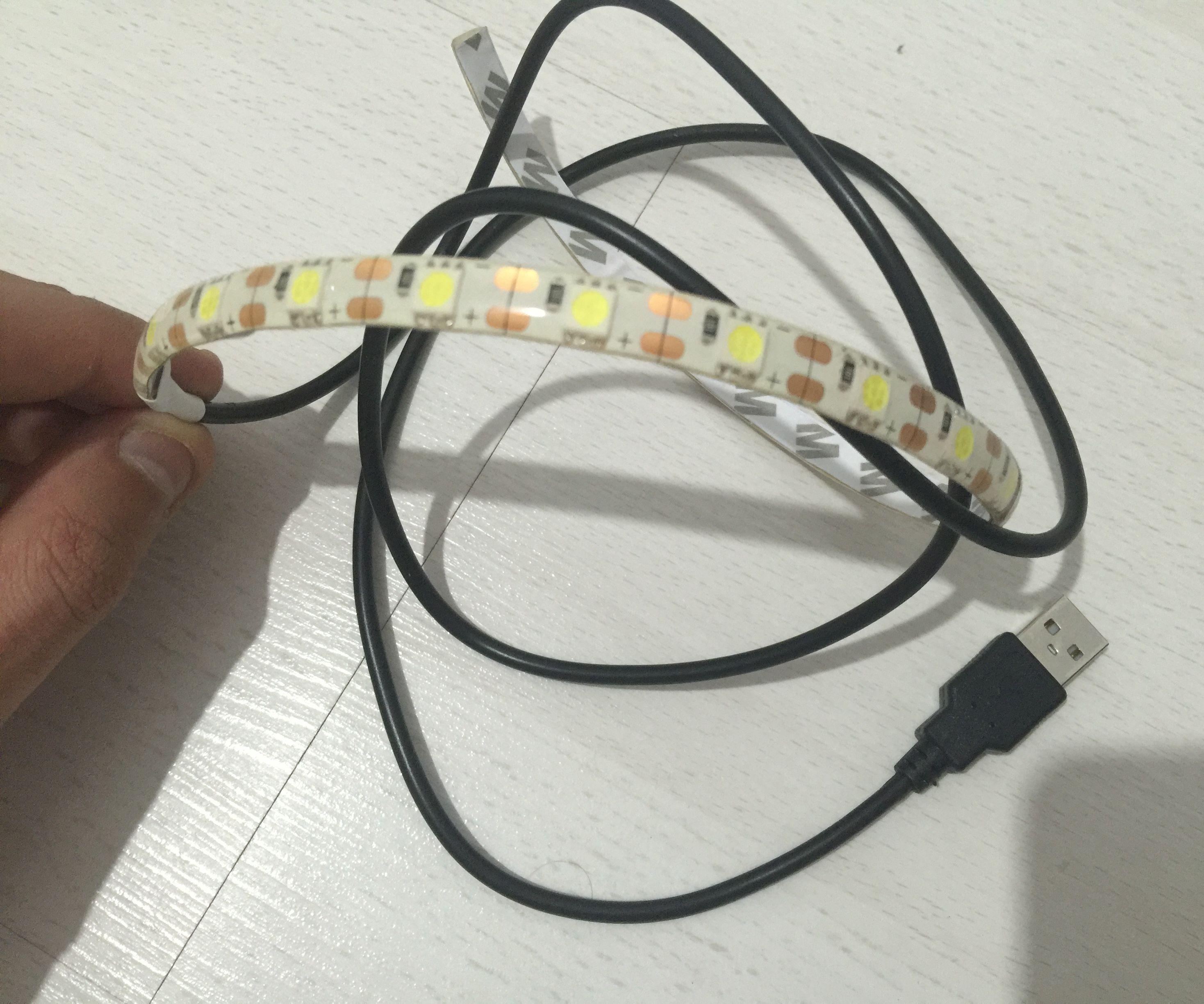

1 m RGB LED strip non waterprooph its easier to bend
LED strip remote control (optional)

Step 5: LED
Trial and error
Arrange the LED strip as u wish just make sure its gona light all the number properly
If you choose RGB it might glow some numbers more or less or even show one color more than the other.
