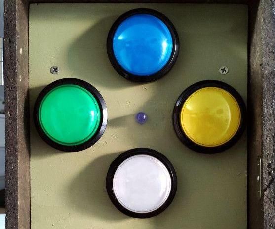

Step 5: Container
For the cache container I needed a wooden box big enough for the coin acceptor, the 4 digit 7-segment display and to have a small door for the logbook.
On the back I've secured the Arduino with 4 screws.
On the front, I've created some holes for the 7-segment display and the coin selector. You can unscrew the front of the coin selector and secure it firmly with screws to the front of the container.
You can see image 3.
